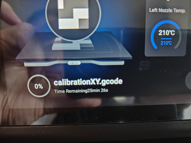

So this did not fully solve the issue but it did produce different results and advanced 1 additional auto calibration step than before
  1. Initial auto z calibration did not strike the glass bed hard
  2. X and Y calibration did lightly scrape the glass bed
  3. Both auto x and Y calibration did save ( y would not previously save)
  4. Multiple error screens ( pics attached)
  5. Stuck at print check model (5/6) xy offset calibration. Nothin moving. Percentage complete never rose above 0%. Oddly the time remaining clock counted up…not down
