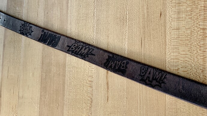

Coincidentally I just did some engraving on my dog’s leather collar (his name is Bam if you didn’t guess).
Vector, fill 20, 1000mm/m @90% power. Cleaned off soot with Lexol leather cleaner.
Was going for a heavy, deep engrave. Came out how I wanted/expected.
That’s nice. I’m sure engraving 0.26 mm bookcloth is going to be a bird of a different feather. :face_with_monocle:
