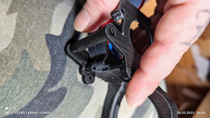

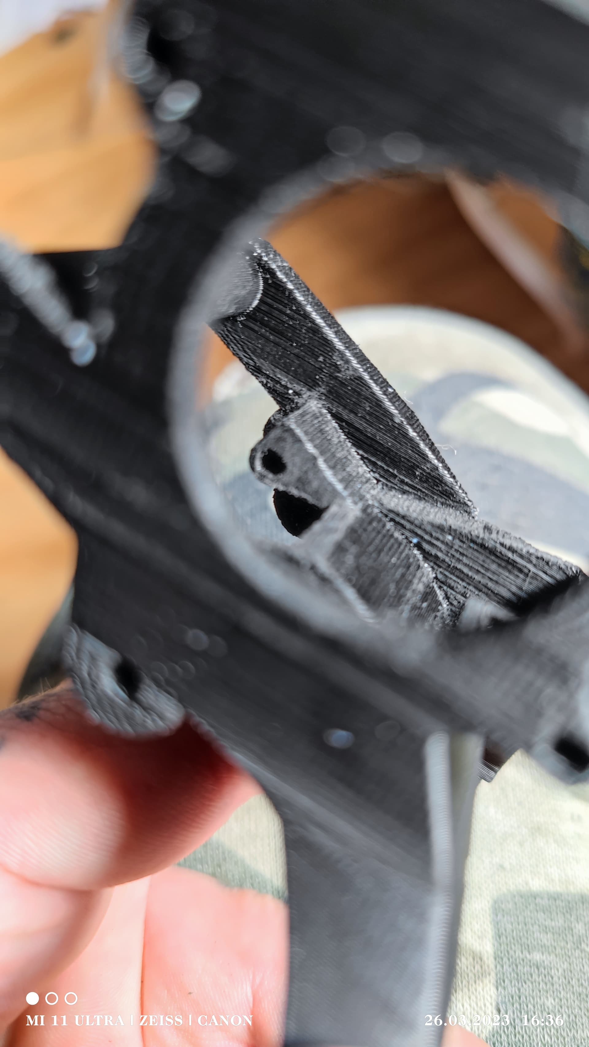

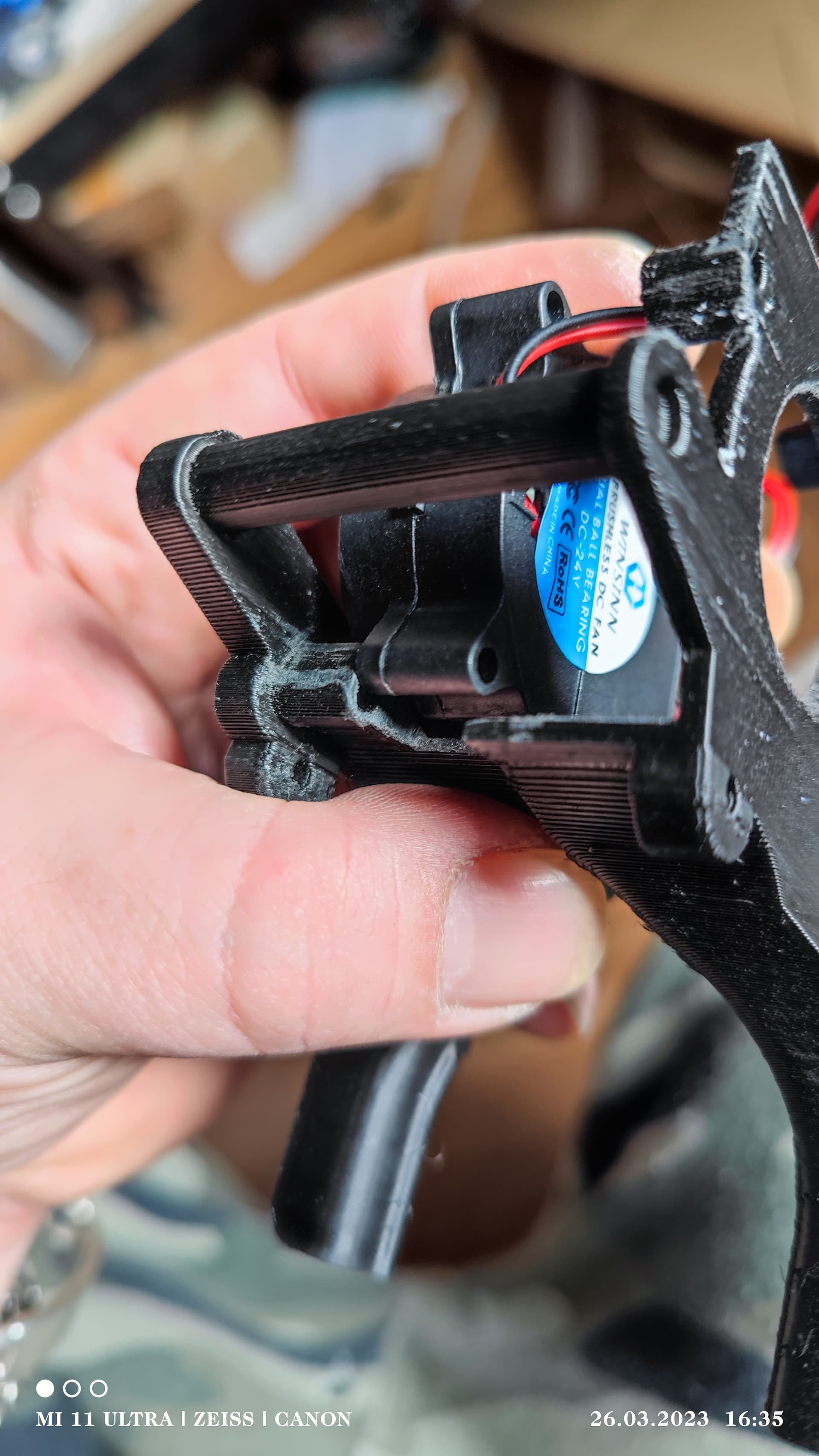

Got it printed and don’t fit to 4020 winsinn fan
The second fan don’t fits, the part behind the upper hole is not round enough :see_no_evil:

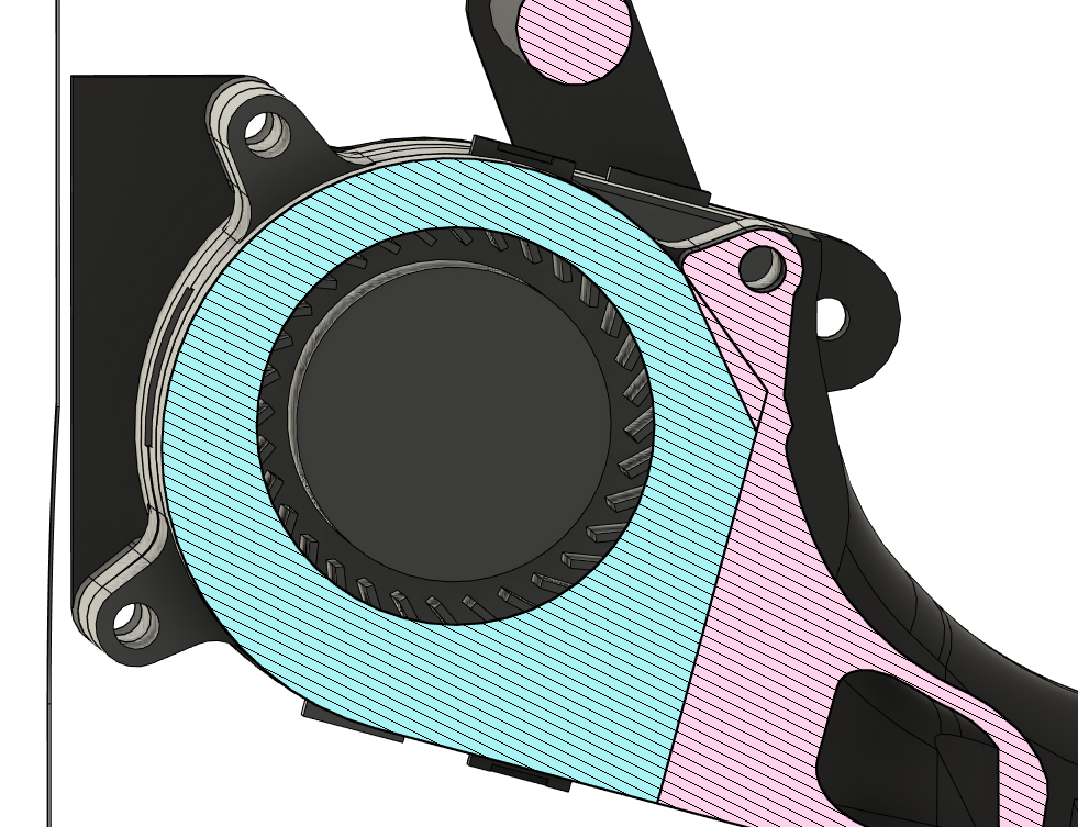

That’s dissapointing… I used this one as a model:
ah ok I see the problem. I haven’t got my fans yet so haven’t tested it. Sorry about that. What a sloppy mistake…
I will fix the problem right now =)
On your file the fan look like the same as this one here.
Thanks for your help. Can you give me message if it’s fixed.
May be you can send me your Cura settings?
Im Not sure but I think some went wrong here on my settings.
The head stand on part if finished layer before change to the other extruder.
I don’t know why he do that
Thanks for testing it and letting me know. I have fixed it now and updated thingiverse…

I see now that i fixed the mistake but on the old version lol. I will fix it on the new version and update thingiverse…
It’s updated now…

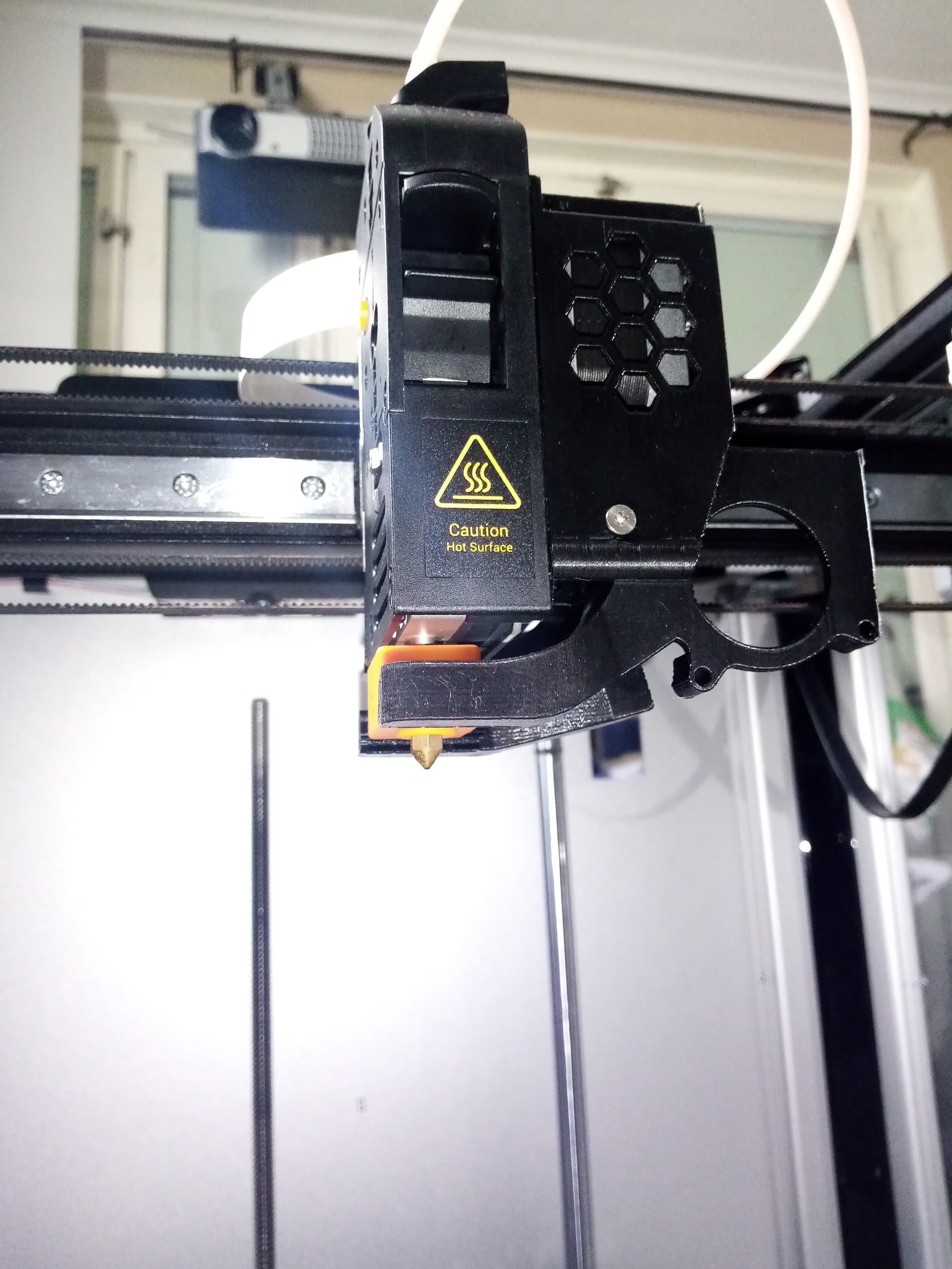

Damn crap, loses steps on printing and clogging again and again. I start on Friday to print the ducts, only 1 fucking peace is came out finished. 1 spool pva and pla killed for nothing on 3 days.
Disappointed :frowning:
Now I print the ducts this week on my cheap creality printer, the 1600k printer drives me crazy. Hope I get that thing fixed
Yea hopefully snapmaker will release an updated version of the hotend soon…
I’m with you Lou. I just hope Snapmaker makes this right in the end.
