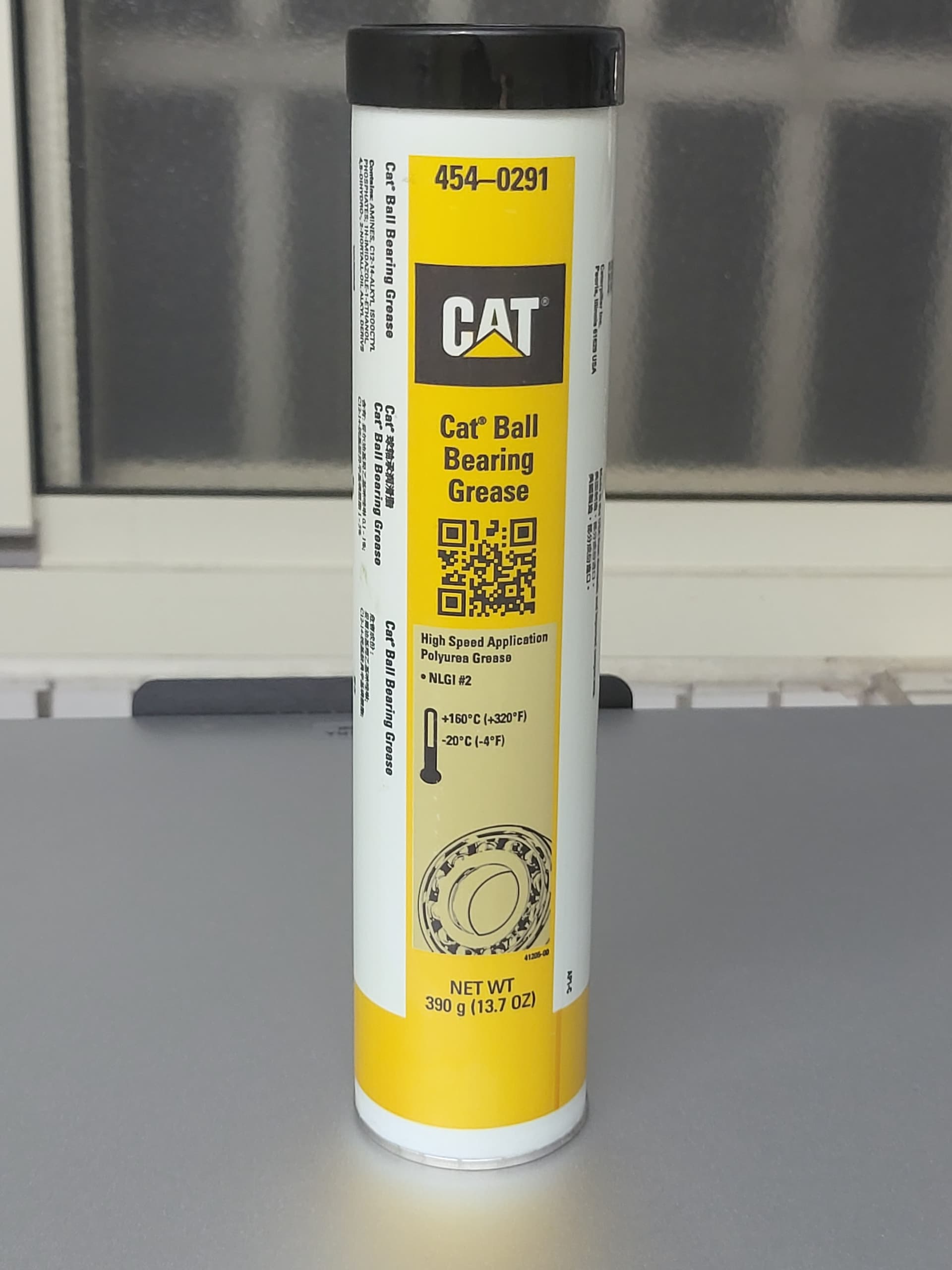

Grease
It was during this time the printer started making weird scratching/ grinding noises when the bed moves down kind of like shredding plastic, at first I was freaking out thinking my modification broke something or that the dreaded dust somehow got into the motors but then I remembered in the Things to do first with a new J1 thread “Remark: The same applies to the z axis. It should move without any noises apart from the motor. If you hear some clicking or cracking (might also happen in just one direction), add an NLGI class 2 grease suitable for ball bearings to the linear rails” and so I went and got some grease.
Lo and behold the noises were no more and I let out a sigh of relief knowing that I did not just break my printer. So to all you newcomers heed this lesson and get some NLGI#2 grease ASAP for your printer.
