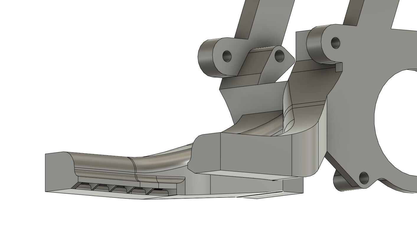

Yes I saw it, thank you. It was too late however. I had already started using the one on thingiverse as a model… Ah yes I try to avoid removing the hotend as much as I can. Luckily the bracket for mounting the fanduct has got hinges so I hope I will not run into too much trouble when I need to remove the hotend…
With the original cooling nozzle? Indeed. With the double-5015 nozzle however I would interpret alfrank’s picture as “sufficient cooling”.
But I am keen to see your solution anyway :slight_smile:
Yes I agree about alfranks green pyramid looking good, but i’m not convinced that 1-way cooling can work well in all situations. Sometime you only want to cool the part a little bit and depending on the orientation of the part, you could (will) get results more like the white pyramid…
My version fits on the printer so it might work in its current state but I have not tested the airflow/results. It will take a few weeks for my 4020 fans to arrive from China =(
If you Print a sphere or bowl or some rectangular the side who is away from blower is bad, i need to finish my ring cooler but have too much work here :see_no_evil:
Maybe optimize the outputs a bit more towards the print bed…?
Yes, I will optimize the outputs and also reposition the arms to compensate for the nozzle not being in the center of the heatingblock. There will be another version soon =)
a new version of the fanduct is up. I think it just might work =) we’ll see when the fans arrive…
Looks good, could really work…

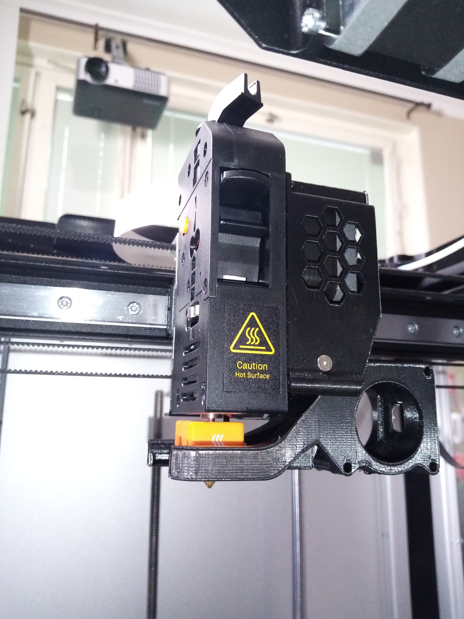

Is there a suggested print orientation?
Yes. I printed it on the J1 with these settings:
Orientation: airchannels/arms pointing upwards
Layerheight: 0.2
Tree supports
support z-distance 0.4
brim (probably not necessary but why not)
Linear advance 0.1
support blockers for all holes and the airchannels…
There is a 3mf file to download with the support blockers added…
It looks like I missed putting support blocker for one of the holes. Not a big deal but I have now updated the 3mf file…

Ok. I upload new versions sometimes. Maybe you have a old/bad version…
I printed the fanduct with these settings:
Layerheight: 0.2
Tree supports
brim
support blockers for all holes and the airchannels.
Speed 200 mm/s
infill speed 200 mm/s
travel speed 150 mm/s =)
I printed lots of diffeent variations of the fanduct. None of them failed… Maybe you have too high retraction distance? I lowered it to 2 mm…
In the new version I have raised the height a little. I have shortened the arms and also repositioned them to align the nozzle more acurate in the center.
This new version is currently only multicolor and normal. No gasket version…
Yes I deleted the M parts and replaced them with the .3mf file
Thanks for help. I try now the new version without the gasket.
Is the gasket need to print too on this version
No problem! There is no need for gasket on this version… Just fanduct.stl. You might want to download it again though. I just made a little change and uploaded a new version =)
