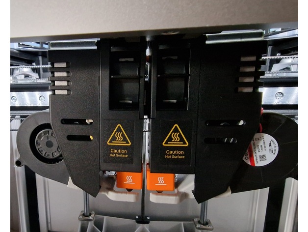

So regarding airducts… Did anybody try this one yet?
I tested mine yesterday and it did not perform better than J1 original =(
Made a new version that might perform better. It’s on thingiverse but have not tested the airflow yet.
I try to print yours this week but first fight the clogging.
This one’s for the 5015 don’t work well.
I will print them again too.
What, yours for the 4020 don’t work?

It’s the UFO Part Cooler
I’m also looking at the ufo cooler. But i have made the copperhead fix, and think i will get problem with my new height of the nozzle. Heat inserts are pretty cheap on amazon and might be good for the structure?
When doing remixes on stl, what is the bestvprogram? Mesh mixer?
Yea it works but the airspeed seems slow. I would prefer the original fan and duct or mecanus 2x5015 version, when printing PLA.
However it is possible that my old airduct is better when printing other materials that don’t require much fan speed…
I will test the new version later today or tomorrow…

May you need to make the parts for the air more tight for pressure.
https://www.printables.com/model/434262-snapmaker-j1-ufo-part-cooling-fan-mod
That’s the UFO thing.

Ufo cooler looks pretty good! I was thinking something similar the other day regarding placement of the fan. Might be the way to go…
May be yeah. Think this inlays for the screw are not good but the rest looks nice, and the way for the Air is shorter and smaller. But if you print in mirror and place more objects and the heads come too close I think the fans will hit each other may be

Got it printed. Did you test airflow from new version?
Did you print it with the outlets upwards?
Yea i printed one too. I’m gonna remove the supports and try it out in a few minutes. I hope it will perform =)
Yes outlets upwards.
The airspeed seems fine =) but direction is aimed too much down towards the buildplate. I will make some more
adjustments :grin:
Oh no, more adjustments again. :grin::grin:
I have printed it on a slow Nissan (Creality) :rofl::joy:
Haha yea Nissan might be better that Citroen sometimes…
On the first versions of the fanduct, I didn’t measure the nozzle position. Didn´t realise that the air needed to be aimed so precisely… So now there is another new version on thingiverse. I just started printing it. I think this one could be a winner =)
