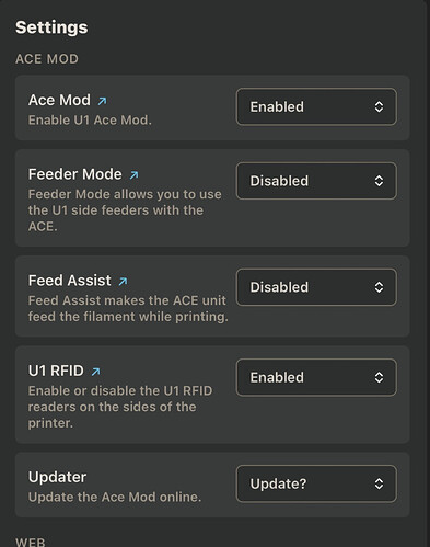

I now also have the ACE Pro up and running and I’m satisfied - the latest version is working perfectly now.
However, there is one challenge: I cannot start the dryer via macros like other users do… (see screenshots - the gray image is from my configuration, the blue one from another user). The entries are simply missing - I always have to use the terminal.
Now for the question.
Does anyone have an idea why the macros are not showing up for me, or can I add a macro myself? If so, in which file?
I was thinking of this:
Could this work? The advantage would also be that it appears right at the beginning of the macro list.
Hello.
Found the solution myself.
After installing the mod, it must be deactivated and then reactivated once — this writes the macros into the ace.cfg.
