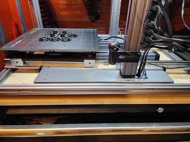

A person by the name of 3DNate posted on the Facebook group about a linear guide rail mod that he did, he also made the brackets. I’m just posting them here for people to see if they want to do it.

Where can I get the horizontal “24-beam A350” parts?
What are you referring to?
At the bottom of the picture there is a bar connecting the two supports horizontally.
Where can I get these?
I am guessing that is the enclosure profile :slight_smile: . It’s not connected, the profile is under the rails as the platform is approximately the same height.
You don’t have to have the crossbar, the point of the mod is to provide support along the Y-axis.
@Franky is correct, linear rails sit on top of enclosure bottom crossbar if they are long enough.
Can anyone link a guide to actually doing this mod? That’d be super helpful!
Searching works. If you have the quick change setup you’ll need to find the new files for the adapters.

I am using different kind of linear rails but it should not matter. I am using longer M4 screws in the 4 corner screw holes that hold down the CNC spoil board with the screws extending far enough down that they catch in one of the holes of the linear rail carriage. No adapter at all. I use magnetic blocks to shim the rails to the correct height so the top of the linear rail carriage touches the underside of the Snapmaker spoilboard carriage that came with the quick swap kit…
Linear rails are only relevant for CNC with real downward force, not at all for 3D printing or laser…
Here is a link to the shim stock: Magnetic Shim Kits
These are the rails that I am using: https://www.amazon.com/gp/product/B07M8T1NG1/ref=ppx_yo_dt_b_search_asin_title?ie=UTF8&psc=1
I leave the rails in the enclosure. They are not really attached to the base or anything else. The movement of the spoil board aligns them…
Blocks are in the front and back and in the middle of the rails where the cutting happens…
Blocks are .75" x2 each…
This setup works very well with the installed quick swap kit. No fiddling necessary. Easy slide on and off of spoil board with no interference. Only thing to be done is screw in and out the 4 screws for “connecting/disconnecting” it to the linear rail…

Hey guys, I’ve been utilising the Christmas break to work on a design that I just completed and installed but still welcome input from some more experienced guys. This is also not trying to take away anything from the design that is mentioned by @edf above. It is worth to note that I’ve been looking to install the linear rail mod for some time but never got round to it, so this is was my first attempt after reading about it on the forum for months.
Purpose:
Design a system that would work with both the quick swap kit for Snapmaker 2.0 as well as the SBR16 linear rails.

Figure 1: Assembly
Connecting the bearing blocks
Figure 2: Bearing block connections
I am of opinion that fixing the bearing blocks to each other and at specific distances from the Y-axis prime movers was/is key to ensuring that when the bed with quick swap kit was installed the bearing blocks should not “scatter” everywhere. I started out with a 2020 profile connecting these, but it quickly became apparent that height would be an issue, I then drew up a 2010 profile but again was of opinion that there would be insufficient height.
It is important to note that if the desire for an adjustable system was not needed, height most likely would not be an issue and a 2020 profile should be able to be adapted fairly easily.
I ended up just drawing an angle with some slotted holes that I printed. Alternatively some can be bought from your local hardware store. The one angle does have a riser to be able to connect to each of the Y-axis’ movers.
A note for those looking to print these, as I did, look to orientate them at a diagonal on your print bed, they would fit on the bed normally but the shortened distance due to the quick swap kit (you loose a couple of mm) it cut’s it off without notifying you, unless you’ve adjusted your slicer’s bed dimensions.

Outcome / Conclusion:
I do not have access to my printer right now, but as with everybody else’s results pre-quick swap, my bed level delta dramatically reduced, and I have increase stability.
It took me some time, with multiple iterations of doing the bed levelling sequence, removing the bed, adjusting the nut, replacing the bed and redoing the bed levelling sequence, etc. but the reduction in bed level delta was worth it already.
