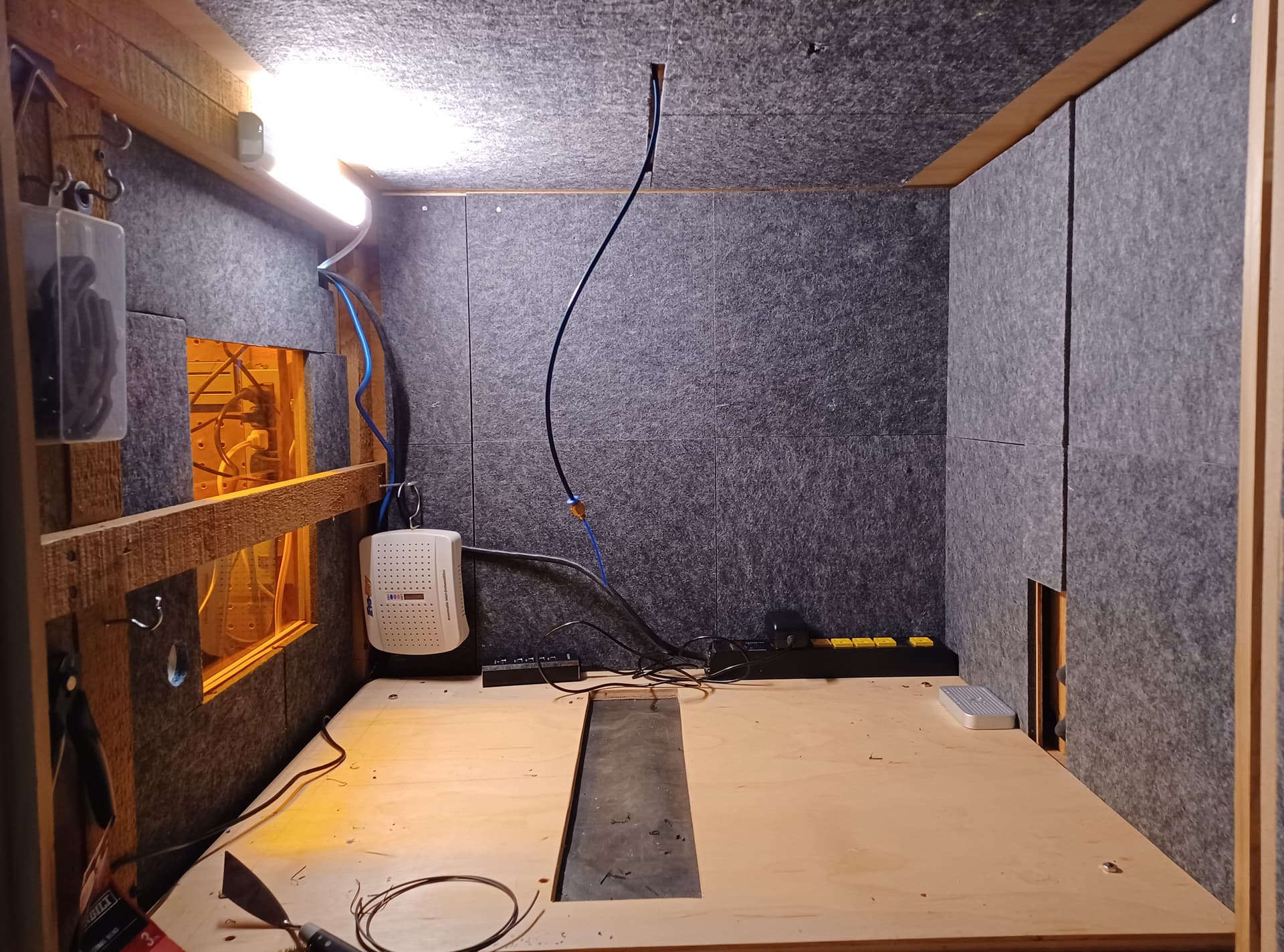

Bonus round: Enclosure
Just a few photos of the enclosure I built into an existing perma-shelf.
The inside. Note the soundproofing panels, the vacuum outlet on the left, and the cutout for the heated bed cable (sheesh is that thing annoying) on the right. Pay no attention to that tench in the middle, I reused some old plywood. Though it shows off the EDM rubber I put underneath for no reason other than I had a lot of it after making some way-covers for the lathe and mill.
Filament drybox and A350 power module (cloaking mode: ON) sit on top of the enclosure.
