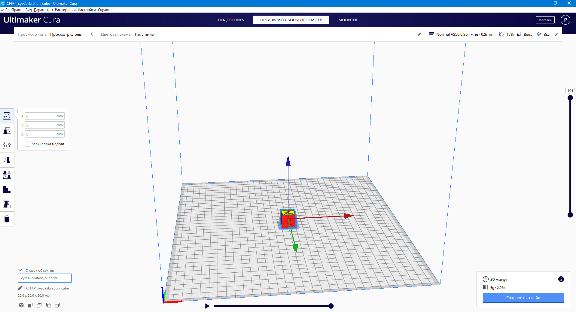

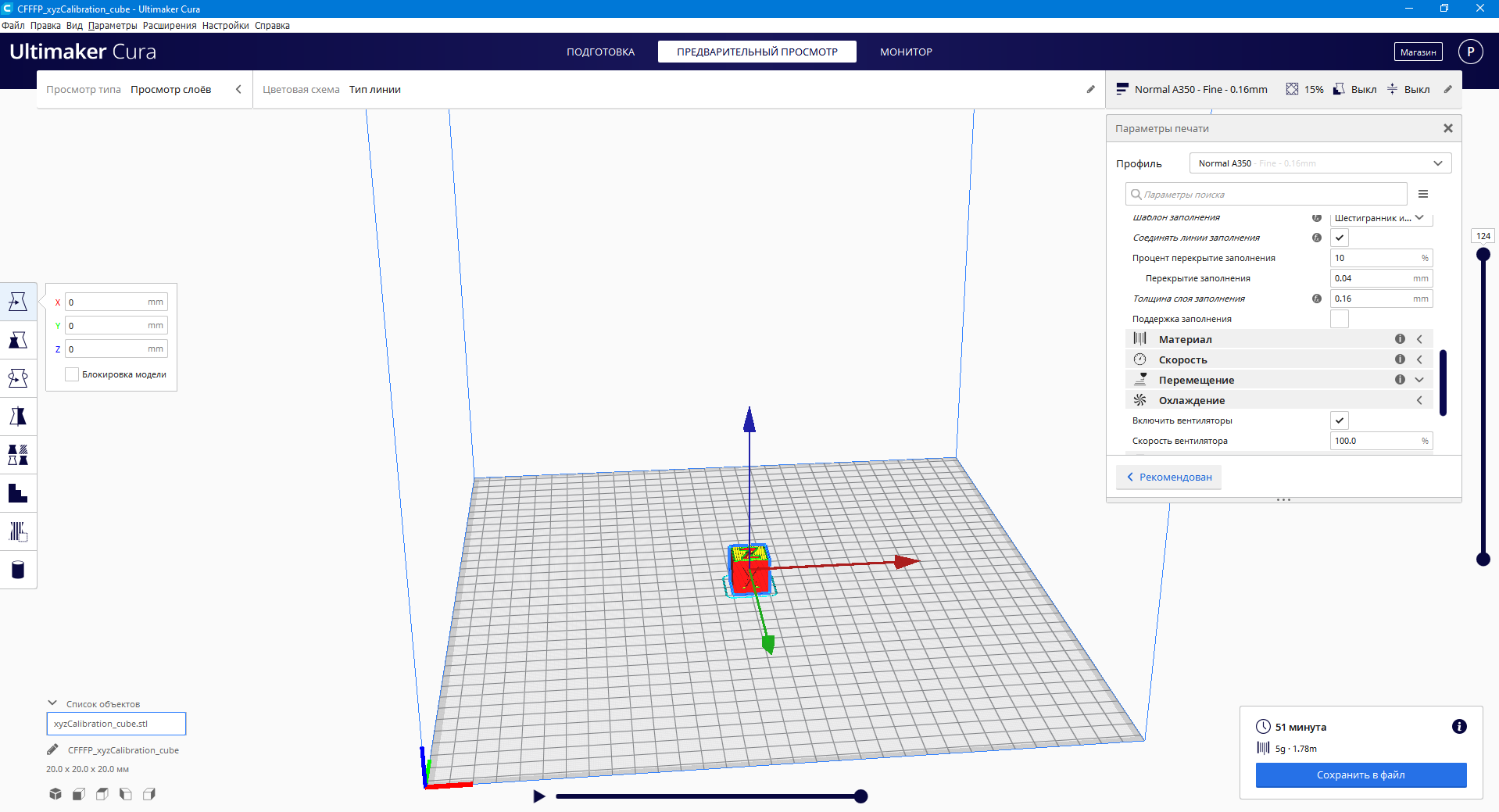

My CURA settings.
Setting up the Snapmaker A350 printer
;Start GCode begin
M140 S{material_bed_temperature} ;Start heating bed
M104 S{material_print_temperature} ;Start heating extruder
G28 ;home
G90 ;absolute positioning
G1 X-10 Y-10 F3000
G1 Z0 F1800
M190 S{material_bed_temperature} ;Wait for bed to reach temp before proceeding
M109 S{material_print_temperature} ;Wait for extruder to reach temp before proceeding
G92 E0
G1 F200 E30
M106 S255
G4 P1000
G1 X10 Y10 F200 E20
M107
G92 E0
;Start GCode end
;End GCode begin
M104 S0 ;extruder heater off
M140 S0 ;heated bed heater off (if you have it)
G92 E0
G1 E-1 F300 ;retract the filament a bit before lifting the nozzle to release some of the pressure
G1 Z330 E-1 F60 ;move Z up a bit and retract filament even more
G1 X0 F3000 ;move X to min endstops so the head is out of the way
G1 Y350 F3000 ;so the head is out of the way and Plate is moved forward
M84 ;steppers off
;End GCode end
Snapmaker Normal - 0.16
Test cube printing - 51 min
With my profile Normal - 0.20 Normal_0.2.curaprofile.zip (1.3 KB)
Test cube printing - 30 min
