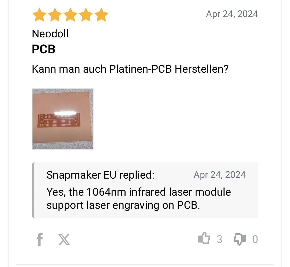

Regarding PCB:
For me thats one of the main selling points. I hope it will do well but still im unsure cause Snapmaker told a lot of stuff that was not exactly what we got and didnt correct that till this day.
Greetings
Indeed it’s good to stay skeptical, maybe they’re just saying you can use it to laser a logo into an existing PCB :wink: . Guess I’ll find out and hope I won’t get burned (both figuratively and literally).

See below the most definite “official” answer I’ve yet seen - I guess I can look forward to a very useful tool addition! That expands my workshop capabilities considerably. I’ve done isolation routing with CNC, but getting the PCB board absolutely parallel to the toolhead plane is a PITA, and I’ve kindof given up on that. The laser should be much more tolerant to minor tilts…
Thank you!
Sounds very promising.

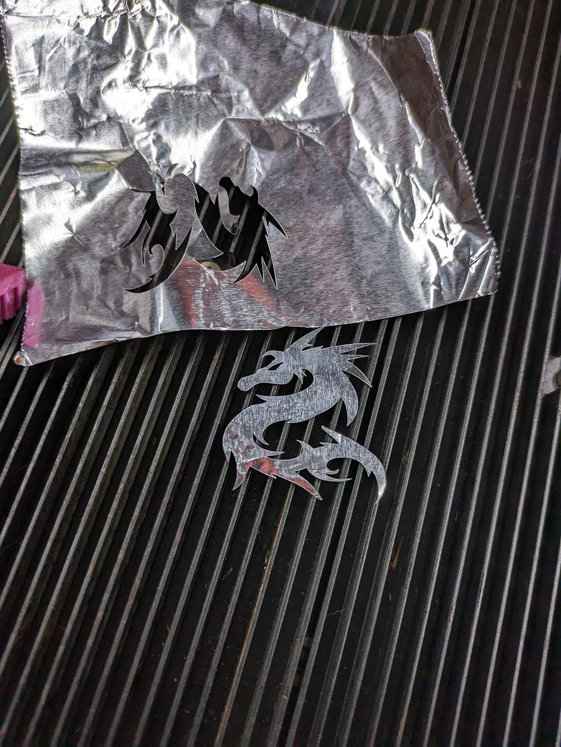

Aluminum foil cut! :star_struck:
