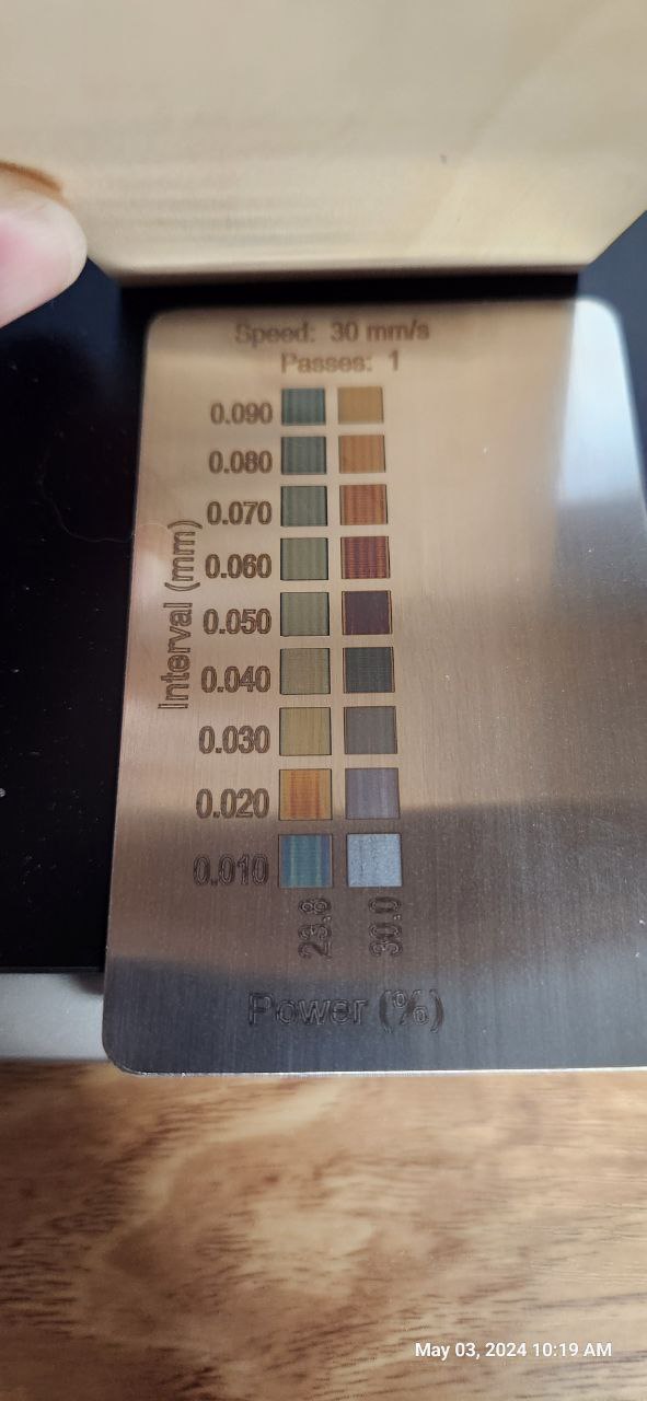

I’m excited for the IR laser module. I know the engraving is essentially just oxidation of the surface. My question is does this oxidation cause any long term issues that would require sealing the surface after engraving? I’m getting a lot of requests for engraved bare stainless steel and on the 40w module it’s pretty cool I can engrave “color” using 23.8-30% power in the 0.01-0.09 interval range.
Unfortunately it’s so lightly engraved you can only really see it if reflecting a white or light colored surface.
Is there any interval or power settings that can change the look or darkness of the oxidative engrave on the IR? I suspect people like myself are going to be used to the ultra dark you get from marking paint to get that deep black on metals using the current laser modules.

Another beta tester here. I haven’t had much luck with the IR laser and color marking on steel. Pretty much just blues and browns. The 40W laser is much better at laser color on steel. I recommend trying a frosted steel, as i had much better luck with colors on that. Read my articles in the Snapmaker Academy for more details.

Hi, still new to the snapmaker but slowly learning what to do and how.
Can you point me in the right direction for the bed “adapters” you have in this photo?
They look a lot better to use than masking tape!
Many thanks
Can you suggest where you are getting your stainless steel “cards “ from? Please ![]()
The corners are mine found here;
https://www.printables.com/model/85447-snapmaker-laser-bed-square
The other clips I printed in TPU are found here:
