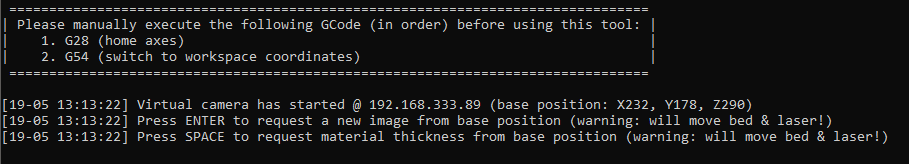

After camera lens calibration is done, you have to perform the alignment. For this you need to define the camera as “fixed” (it’s effectively fixed at the position defined in your config file).
As for exporting as NC and transferring via Luban: I run my laser jobs straight from LightBurn over serial connection as this gives LightBurn full control. Luban or the Snapmaker touchscreen firmware might inject some unwanted GCode before running the job, so I prefer not the go that route.

While it’s certainly an option to make the feedrate a setting, the tool will not move your laser anywhere near the bed unless you specifically tell it to do so using the config file. The collision seen by @ViperZ is most likely caused by other incorrect settings in LightBurn.
I highly recommend following the guide from @Skreelink (Full Lightburn Control Guide) to set up LightBurn correctly, and then try to use this software.

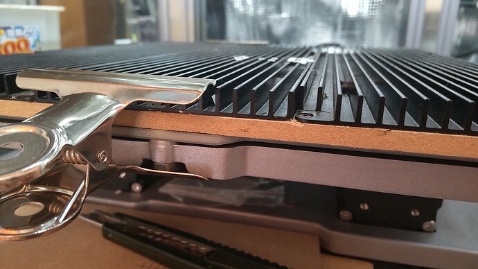

The laser plate for the laser engraving is placed on top of the heated bed, fixed to an MDF board, and secured with clips. As a result, the overall height is elevated by approximately 8mm compared to the usual configuration.

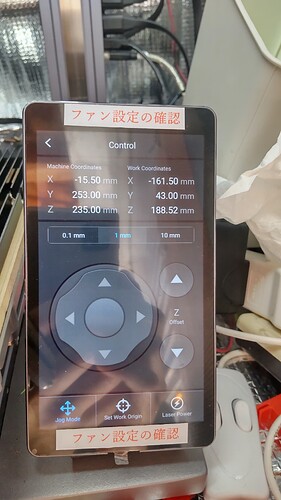

After powering on the SM2, when G28 and G54 were set, the coordinate values were as follows.
However, SnapmakerLightburnhost was unable to move correctly.
After homing using the touch panel following the power-on of the SM2, sending G28 and G54 resulted in the following coordinate values, allowing the machine to move to the desired location and perform the capture.
Is homing on the touch screen required?
It may be required, I would have to confirm. It is usually part of my routine to perform the first homing action via the touchscreen when the printer is powered on. However I don’t know the exact GCode it emits.
I would also suggest you follow the LightBurn guide from @Skreelink (Full Lightburn Control Guide) first. The “Start GCode” of your device settings should contain GCode that sets the Z-axis correctly.
The snapmaker seems to have some form of check built in that requires at least one homing command done through the HMI interface. Be it either the touchscreen, luban, or the web API. I normally just wait a few moments for the machine to fully boot and enter the control screen on the touchpad before walking away. Failing that, I’ll pop open my code sender and just send a G28 from there, which uses the web API like Luban does, so it sets the “all ready” flag in the machine.
