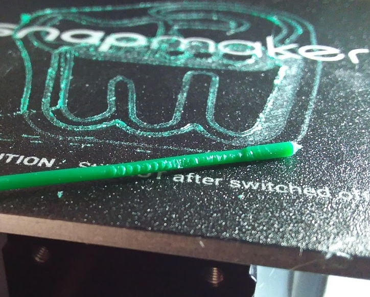

I am using the Melca 3d Printer Filament (1.75) I have used about a roll and a half of it and it has worked great. I replaced the nozzle and that is fine. I have taken the entire unit apart (as far as I am able to) and there is nothing inside that I can see.
When the head starts clicking, I can do a “Replace filament” and when I remove what is in the head, it looks like this:
It is like the gears are biting into the filament, but it will not feed, but I can push it through when I reload the filament. I am just trying to get the entire print unit replaced with one that works.
Thank you.
Hmm. I’m wondering what is causing the reduction in diameter shown there. Is that where the gear has ground it away from clicking?
I think there are four possible causes.
  1. The gear is plugged up and not getting traction on the filament.
  2. The nozzle is getting plugged and not letting the filament feed.
  3. The nozzle is cooling off and not letting the filament feed.
  4. The nozzle is getting too close to the bed and not letting the filament feed.
Is this happening on the first layer? From the looks of the stuff that was printed in your picture your calibration is too close to the bed and that could be causing the filament to not flow freely.

  • It is possible that you are printing too fast. The faster you print the higher you have to set the temperature.
    The hotend can’t heat up the filament fast enough and the driver wheel starts grinding into the filament.
  • Maybe your filament go too much moisture from the surrounding air (because of this problem I stopped using PLA months ago).
  • Have you tried a fresh filament from another brand?
  • Can you provide the STL-file and screenshots of your settings?
  • Tone also gave you some very good suggestions
