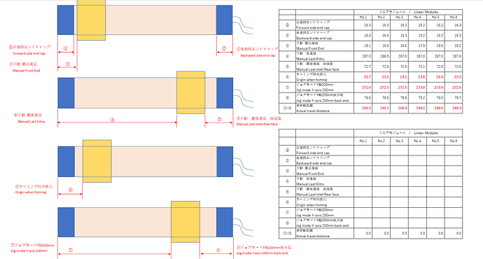

I currently have 6 linear modules, and I am at a loss to solve the bumping sound of Y and Z axis with any combination.
The A250 assembled with the combination that seems to be optimal generates bumping sound like this.
Changing the combination results in a much worse bumping sound.
Attached is the result of measuring all the linear modules.
From this, we can see that the best way to eliminate the bumping sound is to prepare two of the same dimensions.
Even so, if there is yawing in the rotational direction due to separate fixation or other reasons, or if there is an oblique inclination to the axis, bumps will occur.
If you are having trouble with bumping noise (bouncing or misalignment due to the impact of the bet), you need to measure the dimensions and select two linear modules with minimal difference each.
In my case, the bumping sound has not been eliminated in all combinations…

While I had 6 linear modules, I measured the dimensions and tried to put them together with the “same dimensions”.
Based on the dimensions of the homing and 200mm movement, the best combination was found, “Y-axis: No.2, No.6”.
“Z-axis: No.3, No.5”, and X-axis: No.1".
As a result, there was no bumping noise before the table or X-axis was mounted and fixed, but after fixing, bumping noise was generated, and as a result, even the best combination did not improve.
To be sure, I measured the distance between the two linear modules and fixed them in parallel so that they would not form a V-shape when fixing the two Y axes to the foundation plate, but the result was not improved.

After a long back and forth with Snapmaker support, we were able to resolve the issue yesterday.
They pointed out that the controller was faulty, so I reconfigured it with a new controller, two Y/Z axis branch connectors and new cables, and checked the A250 operation.
As a result, the bumping noise (impact noise and bouncing) was completely eliminated, and we obtained smooth table movement and stable Z-axis movement.
Since the linear modules are made up of modules with the least error in the dimensions we checked, everything is fine except for the operating noise.
Now we can use every inch of the table without limiting the operating speed.
