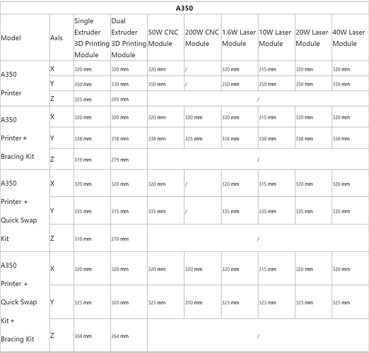

I’m trying to figure out how to reliably and efficiently (without a bunch of manual g-code change) work within full limits of the machine.
For starters, I’m aware that official spec is a bit below these numbers.
But, open your Luban console, home your machine and check it’s coordinates
For the purpose of simplifying things, I will concentrate on X axis here.
My X is at -19. My Max X is at 338 - put these two numbers together - I get 358.
So If I run the following code (via Luban console)
G0 X-19 F1500 ;Go to start of operation
M3 P100 ;Turn on the CNC spindle at full speed
G0 X339 F100 ;Move tool head to the limit of the actual work area (X358=19+338) with feed rate 100mm/min.
I’m able to use the full area to cut the material.
However, if I’m uploading a project using coordinates outside of the 320mm in X - it gets mushed. Similar to what you experience with Dual Extruder 3D printing, when right nozzle is outside work area or with laser. To illustrate, this is what happens to the project after it gets processed by firmware.
You will get a failed print/laser job or CNC job.

Ok im sat in front of my Snapmaker A350 right now and im more confused than ever lol.
Ive tried running a boundary path with the bottom left set as the datum, i’m able to do a boundary movement as follows…
G0 X0,Y0
G1 Y343 F500
G1 X358 F500
G1 Y0 F500
G1 X0 F500
And this works
You will never be able to machine anything that wide in the X because the space between the Z Linear Rails is only 343mm MAX. So the material will not be able to pass through when you move in the Y axis.
Quick correction, you could machine something that wide but you would be limited to around 120mm depth of movement in the Y before the “Part” Hits the Z Linear Rails.
It works if you run boundary by hand. But a NC file is uploaded with size over 320mm in x - it won’t.
At least in my case. Maybe I’m doing something wrong…

Same thing for 3d printing, the maximum size with dual extruder+Quick-Swap+Bracing-Kit is only possible if the bed (sheet) moves forward by 14mm: 331mm x 328mm x 264mm (Z not tested)
Compared to the official size:
Source:
