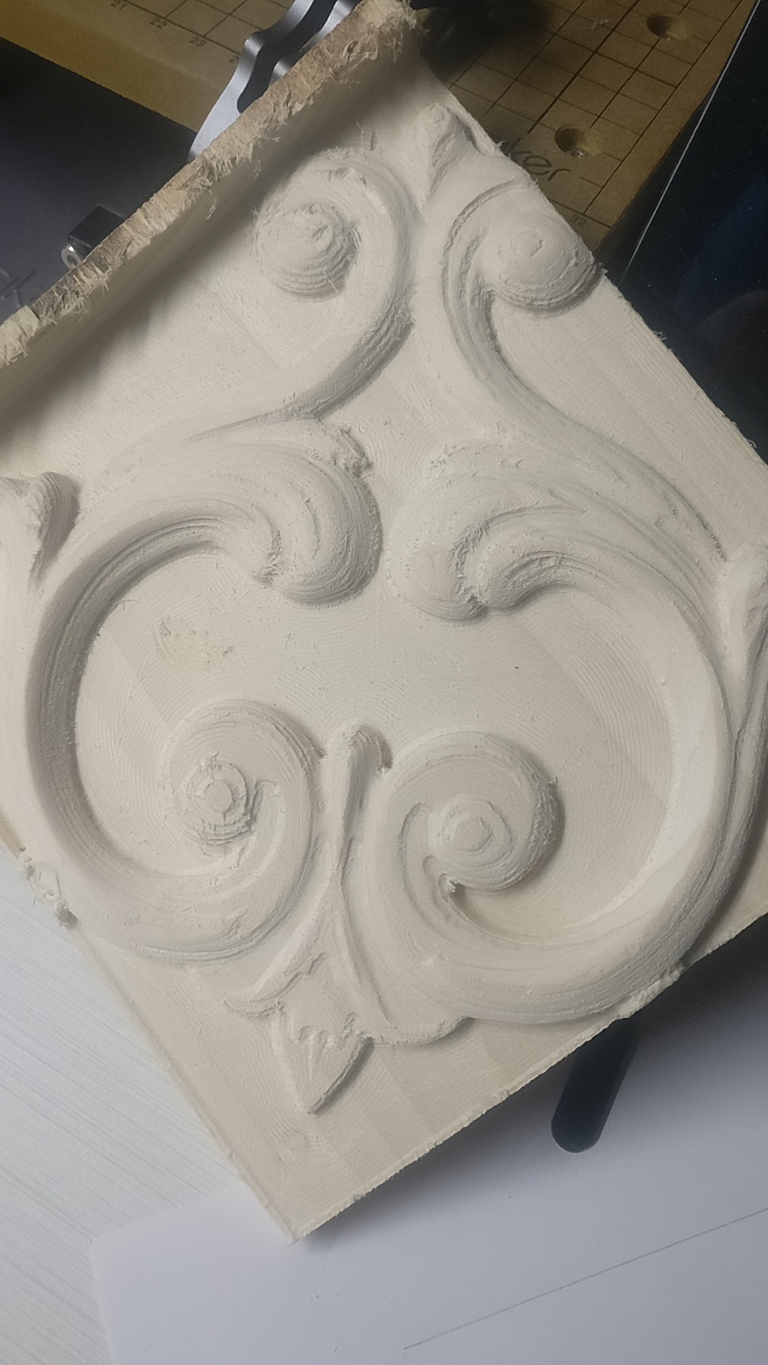

Did you carve your ornamet?
Have you some pictures?

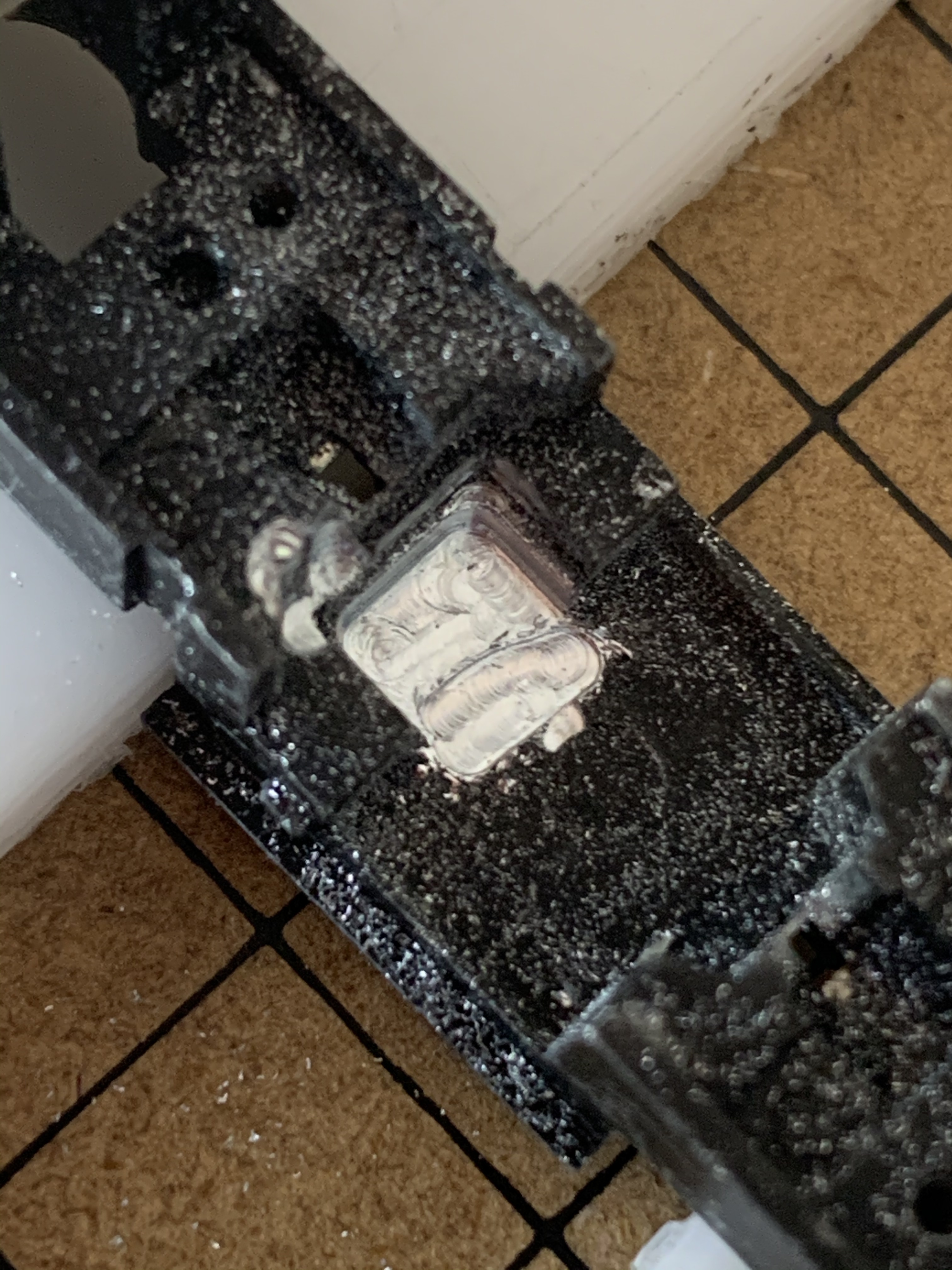

I‘ve drill a part from a small locomotiv, to install a new motor.
The housing is made of cast zinc.

Here are my final results… The initital layer and the result

For fusion 360 I found that endmills do better with clearing operations and the ballnose does better with a finishing operation.
Great and how long does it work?
with the settings I had it took me in total of 17hr 46min to machne it. In fusion it was marked as some 30hrs. Then I have changed a bit the settings in Fusion and with a different setup I minimised that to 12hrrs, but the actual result on how much it will take didn’t do it. But I would assume it will take further less when one would slice it on Luban
