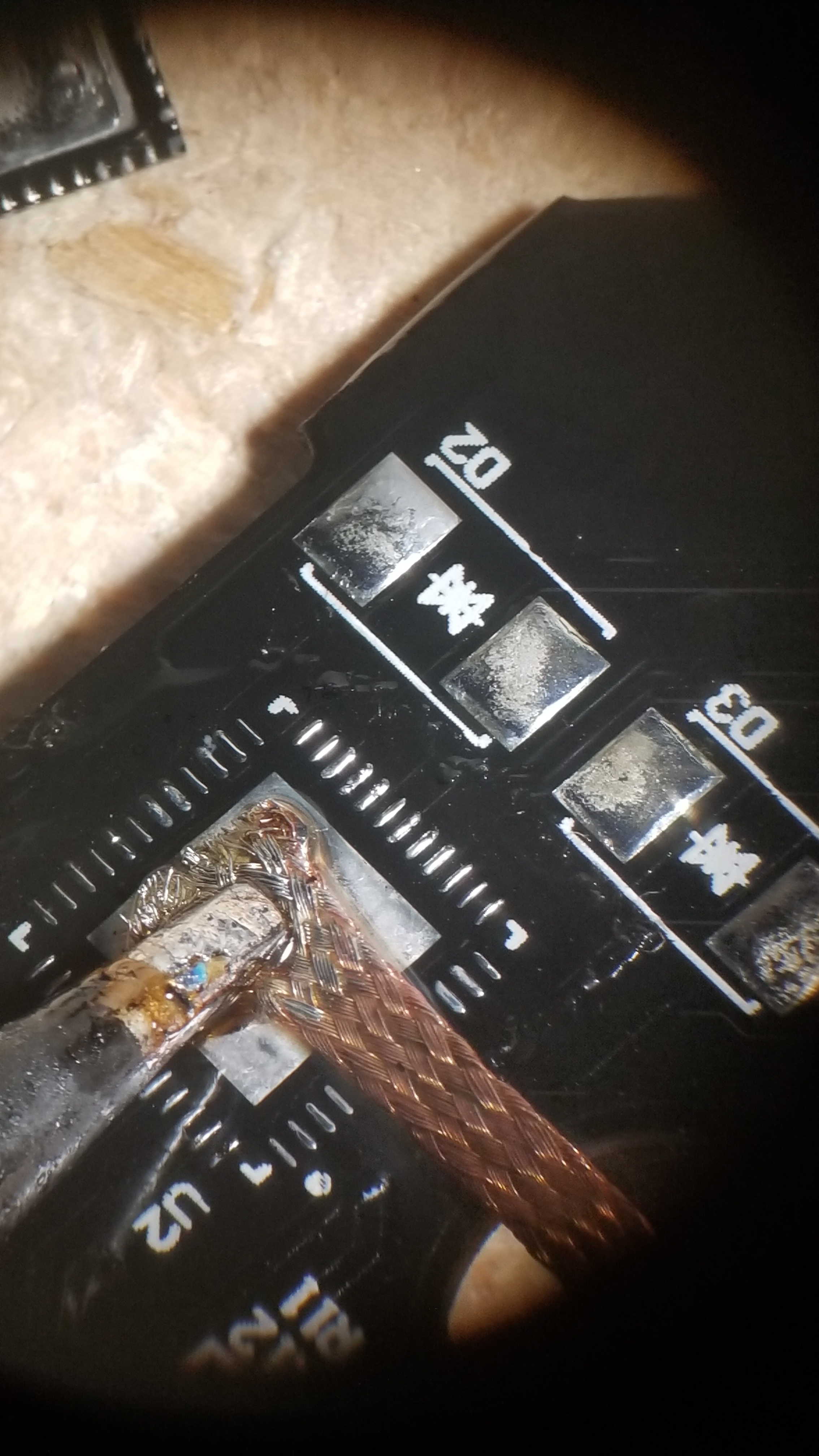

My new stepper motor driver ICs showed up. A bit of micro soldering and… SUCCESS!!!

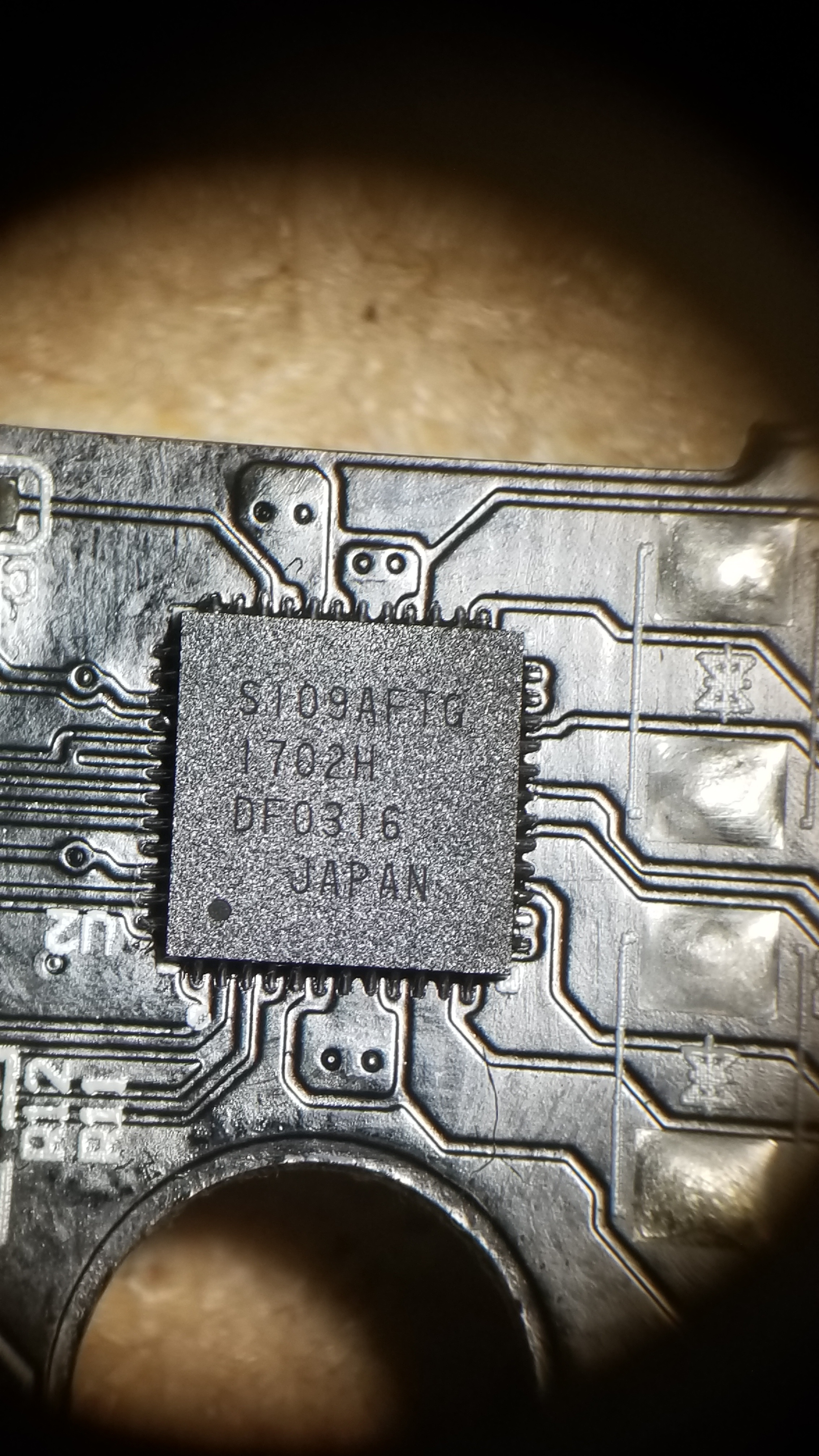

My tests were correct, the primary culprit was the stepper motor driver IC. My snapmaker A350 is back in service.
Removing the chip: First, some Flux.
Now a proper amount of hot air to release the chip from the board.
Need to remove the old solder. Here I’m using soldering wick.

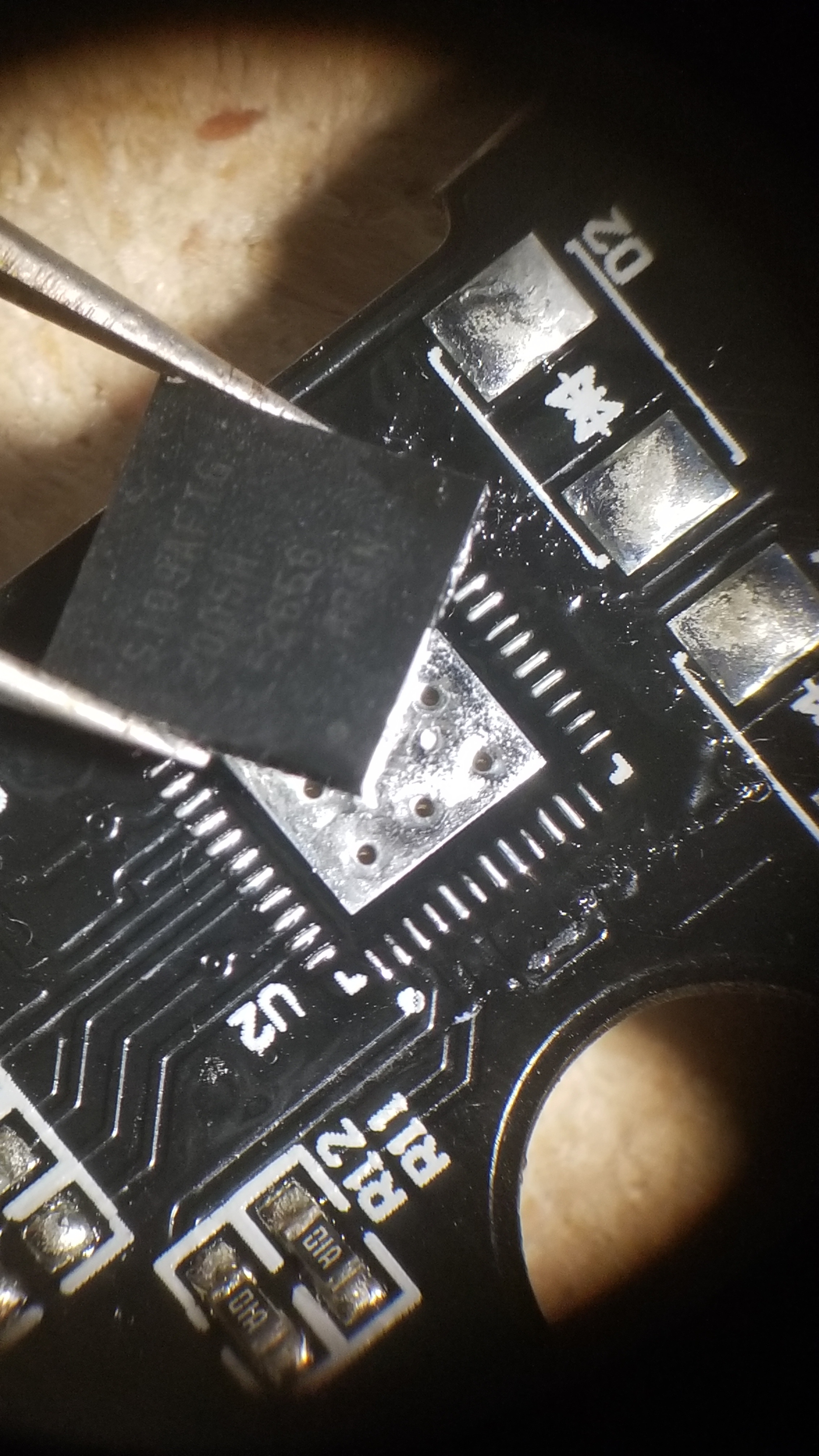

Fresh solder on the pads is applied. Sometimes this isn’t necessary as some chips come presoldered with solder balls. The new chips I got does not have solder balls attached.
New chip. (You wouldn’t believe the packaging they sent this with…)
New chip micro soldered in place.

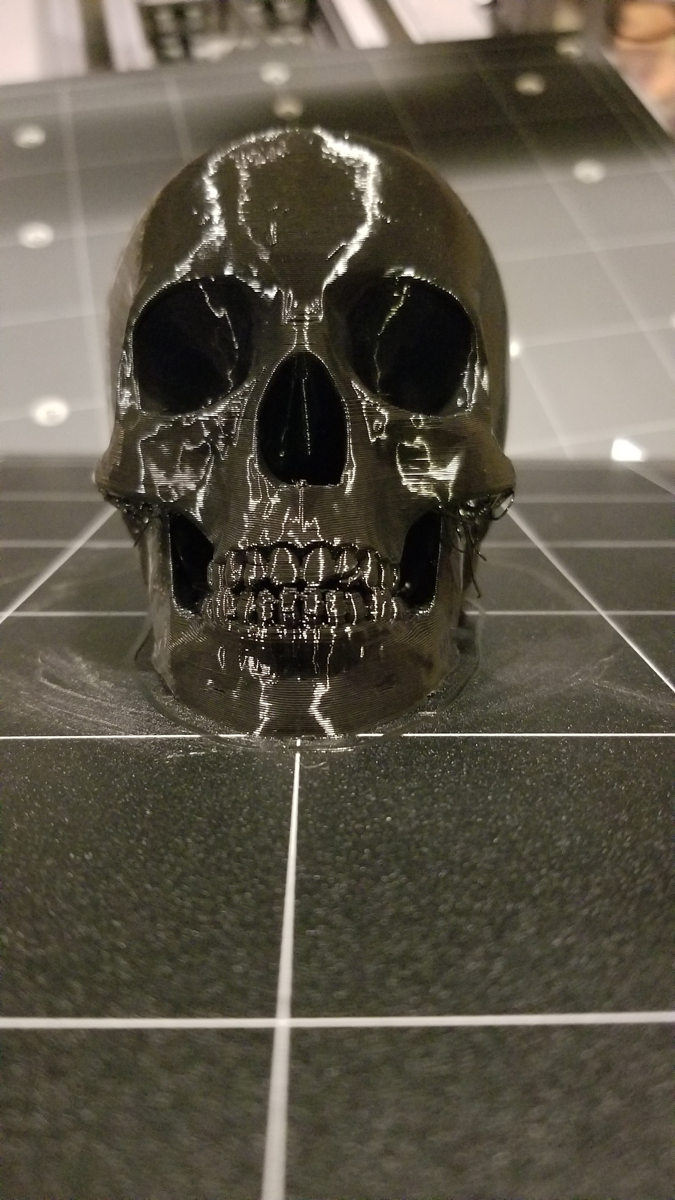

Successful 6+ hour Halloween decoration print. Little stringing in some areas due to my own fault for not adding supports. Little more fine-tuning and I think it’ll be great. Other than that I’m happy with the results.
That print looks very nice, particularly the detail around the teeth.
