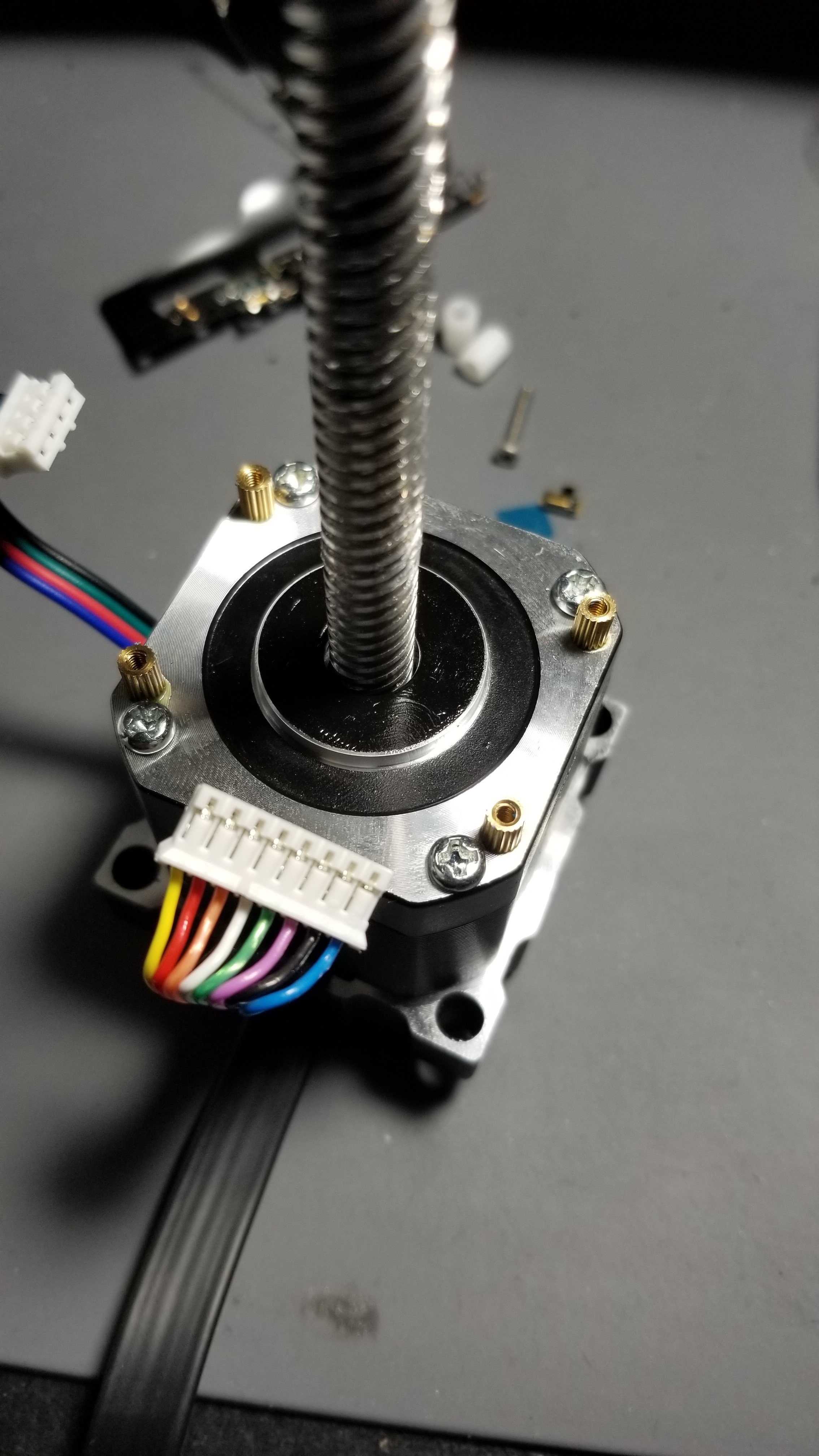

I have a failed linear module on my A350. I’m not alone. I am currently looking into repairing my module as getting another one takes an absurd amount of time. Not to mention, since I’m in the bracket of folks who, according to snapmaker, got modules that “fell below their level of quality”. So, I may not have just one poorly built rail module, but 5… That doesn’t give me a warm and fuzzy feeling.
So. Being an electrical repair hobbyist (I fix iphones, macbooks and other devices), so I took a look. After all, this rail module is useless to me the way it is and there’s another on it’s way. Here’s what I found…
The breakdown is rather straight forward.

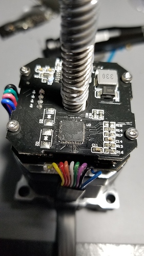

Otherwise, I found no failed solder joints, nothing apparently burnt or traces broken, although a bit more solder could have been used in some places I found no breaks. This uses the lead free solder which takes higher temps to melt.

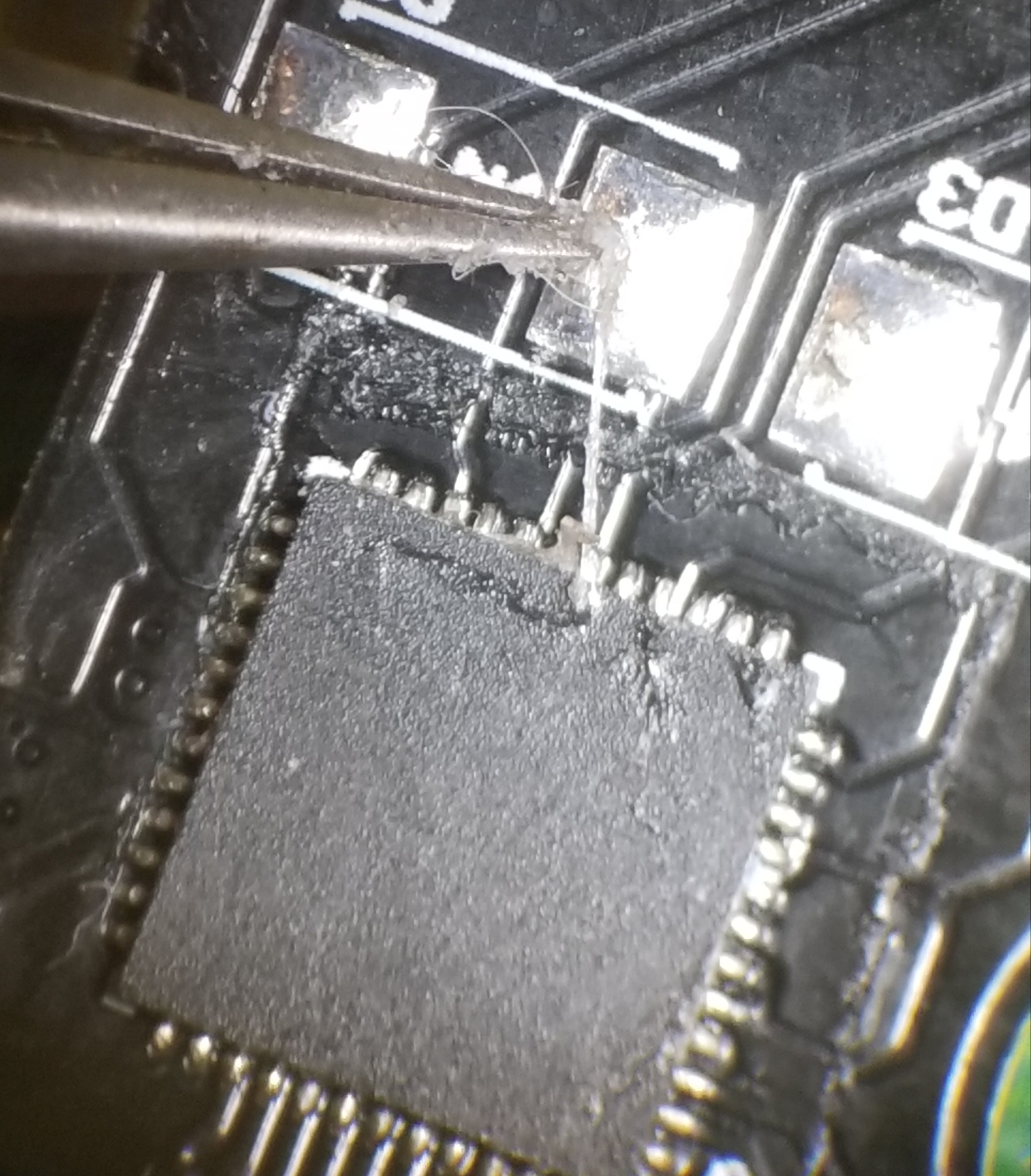

The primary suspect is this, the stepper motor driver IC. These are BiCD clock-input 2 phase bipolar stepping motor driver that use PWM current contol capable of 1/32 step resolution. Here I’m taking the booger like glue off under my microscope. I believe this is the culprit as commands are being sent, no errors are coming back, it just doesn’t move. Further testing is needed. These stepper motor drivers are temperature sensitive. This is what they put that little blue thermal pad on and uses the rail holder inside the housing as a heatsink. You can see it here.

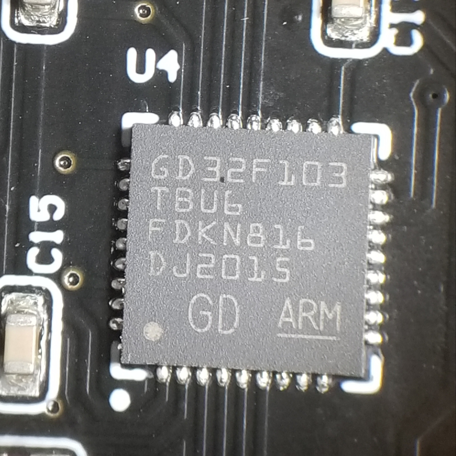

What I found next could be an issue. They used a GD32F103 microcontroller as seen here:
These are ARM Cortex-M3 series microcontroller clones or copies (possibly illegal copies, I don’t know, not my business) made by Giga Devices. Now why is this an issue? If this failed, sure, I can replace it, a relatively straightforward procedure with my hot air rework station. It’s not expensive either, I can get the Cortex microcontroller for under $5, the Giga Devices are even cheaper. Given the option I’d get the Cortex. The problem we run into is these microcontrollers are flash programmed. Programing them also isn’t an issue, it’s actually a relatively easy procedure that uses an inexpensive USB device. The issue is I don’t have access to the flash coding that is needed to make it do what it needs to do.

A motor driver can look like this
broken stepper driver

You could try to check if the power mosfet junction is good, that is an SQ2362ES placed near the biggest 330 µH power inductor on the MCU PCB.
https://www.vishay.com/docs/62913/sq2362es.pdf
You could also try to check the VIN of the MPQ2451 on the same PCB.
https://www.monolithicpower.com/en/documentview/productdocument/index/version/2/document_type/Datasheet/lang/en/sku/MPQ2451/document_id/958/
  • from GND (pin 2) and SW (pin 6) you should find about 24 volt
  • from GND (pin 2) and CHK (pin 5) you should find 5 volt stabilized
If your MCU is damaged I believe the MPQ2451 could be in some ways shorted and not providing it’s VIN (CHK after leveling and filtering).
And to complete the check-up you could also check also the diodes and zeners junctions and compare the found resistor values with the ones retrieved from a good PCB from a working linear rail.
