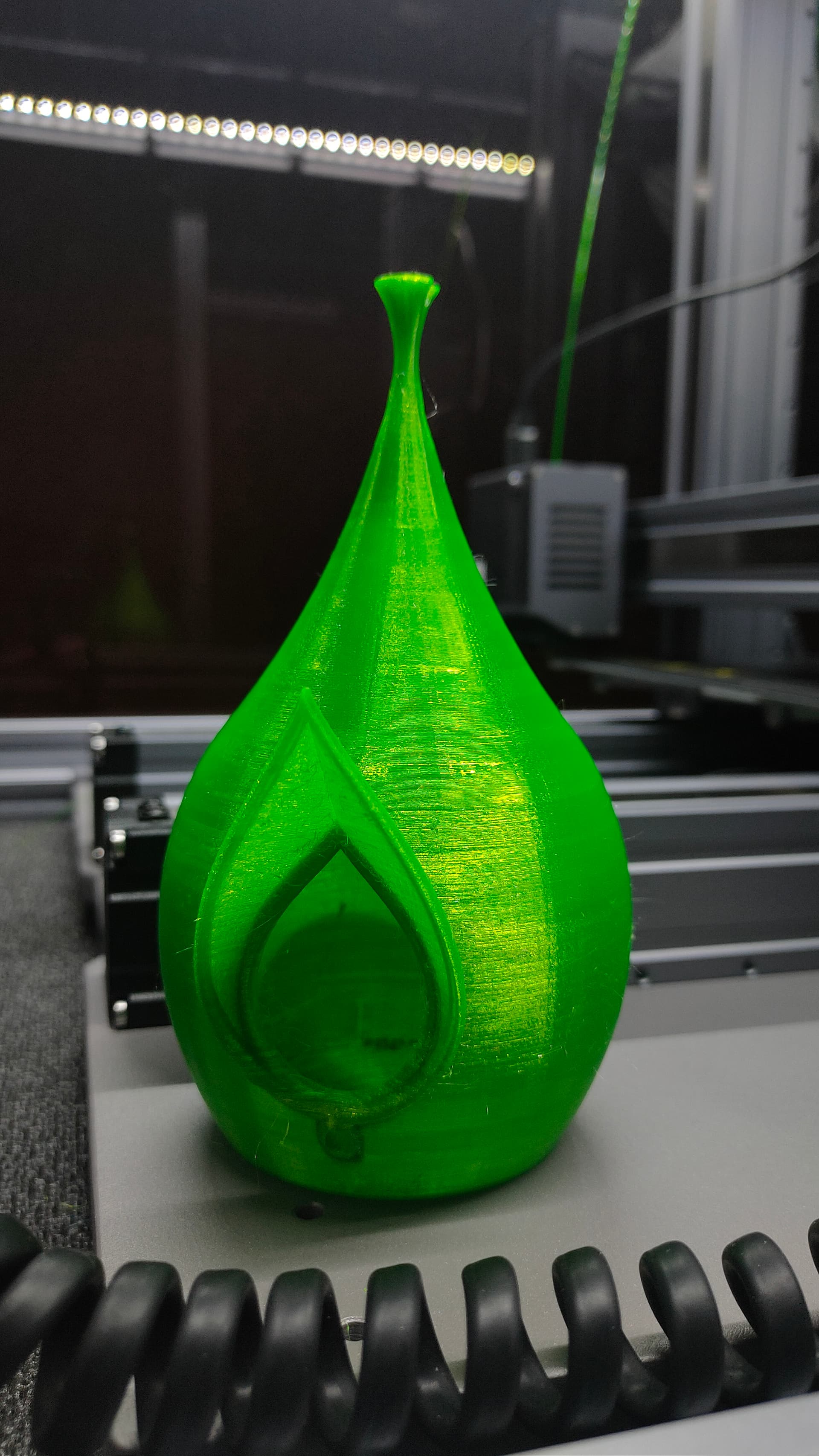

I’ve been struggling with Verbatim PETG over the weekend.
Print temp - 235⁰C +/-10⁰C
Bed temp - 90⁰C
Also the Snapmaker PET-G using the default luban settings.
Using the provided info I’ve gone from a snotty stringy mess to a passable print.
I also raised the Z axis by 0.05mm compared to the PLA setting/calibration.
Sorry to bang on just how happy I am that the above setting suggestions worked (with Verbatim PETG Translucent Green).
A little fuzzy on the inside, but it cleaned up well.
Now to scale it up and learn a little patience.
