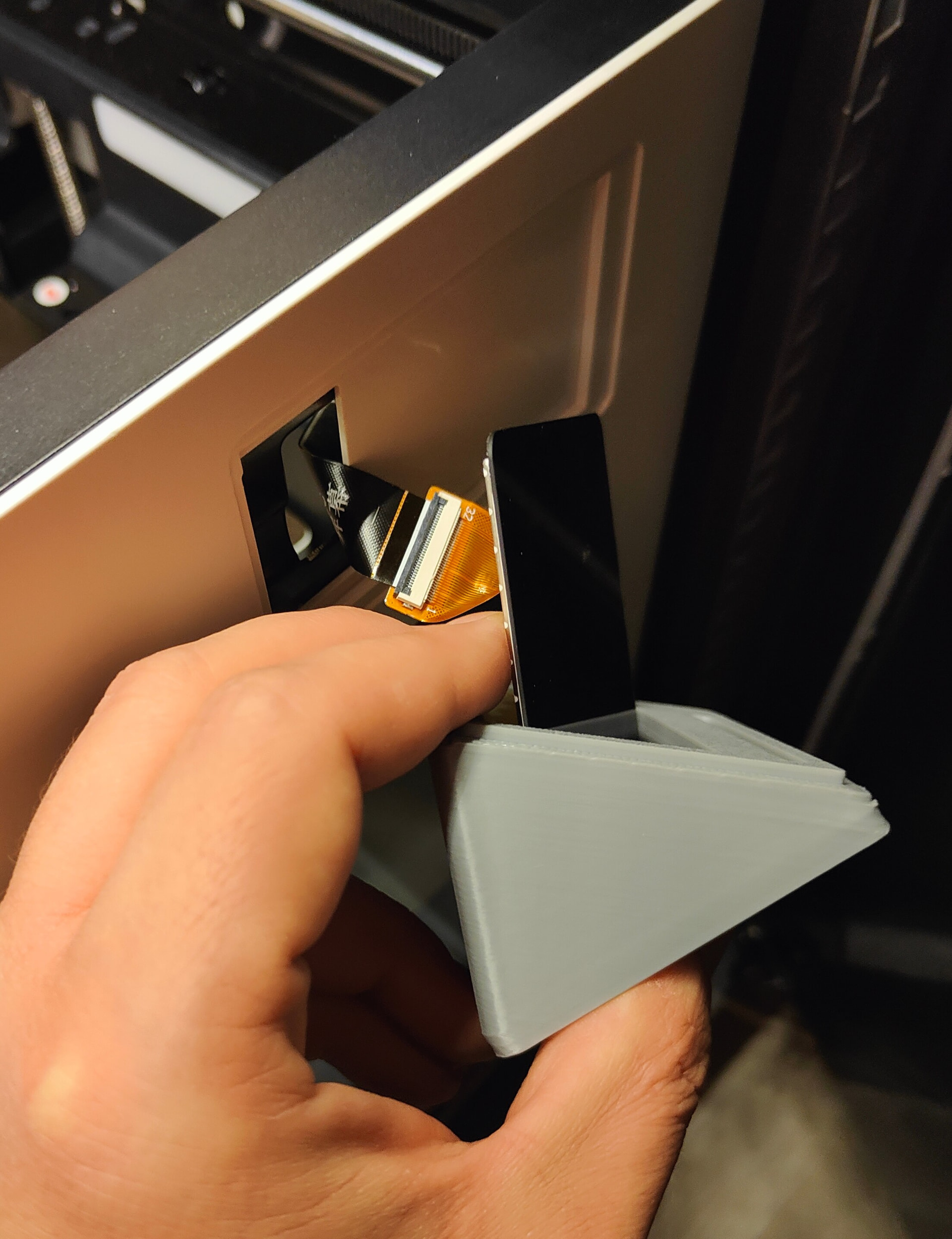

This project is a guide and a set of 3D-printable parts for mounting the Snapmaker U1 touchscreen at a tilted angle for better visibility and usability.

Need to also find an extension flat cable because it’s really fiddly to connect, even for this small distance. Would be much easier to just get an extension and leave a hole to tuck in extra cable.
I might have a source, how long do you think it needs to be? It’s a male on both ends, right?
I’d put it inbetween these. So male-female?
For the mount in the photo I’d go with ~5-10cm to be comfortable. For 50+ degree I wouldn’t go under 10cm.
For articulated mount that + how much it needs to articulate.

How about flat but the right side out from the machine so it’s easier to see from the left. Here is how my printer sits so it would be nice to turn the screen some
won’t work, due to the tech limitations. Cable would be too long for the signal to stay reliable.

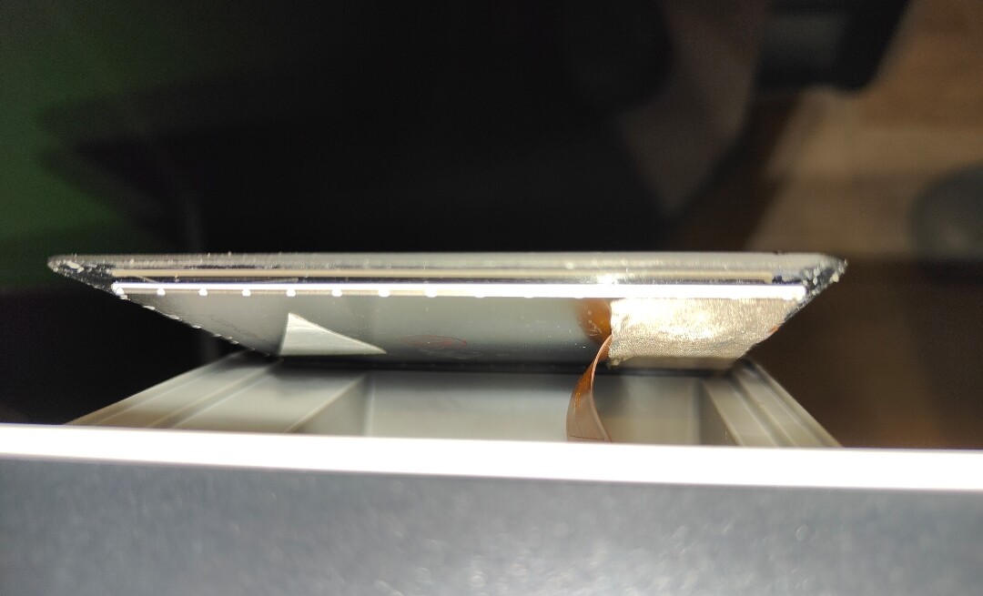

I see you don’t have the shielding sticker on the driver (flex pcb behind the screen), did you remove it or it was missing? Mine is covered with shielding, and it is not coming off easy. Could you snap a pic of the driver? It seems like we might be at the edge of the cable length there…
I don’t know what you mean by “shielding sticker” :slight_smile:
It has shielding, but only on a part of the flex cable, not the whole.
Could be that I removed it, not sure.
That’s what mine looks like. Sorry for the angle, I really don’t feel like opening it again :slight_smile:
I’m pretty sure that this cable didn’t have more shielding. It’s a production unit afaik, shipped to EU in the first kickstarter batch (not pre-prod).
This portion is covered with something on my pre-prod, that I can’t easily remove. No worries tho. I’ll figure it out. Thanks for the pic!
