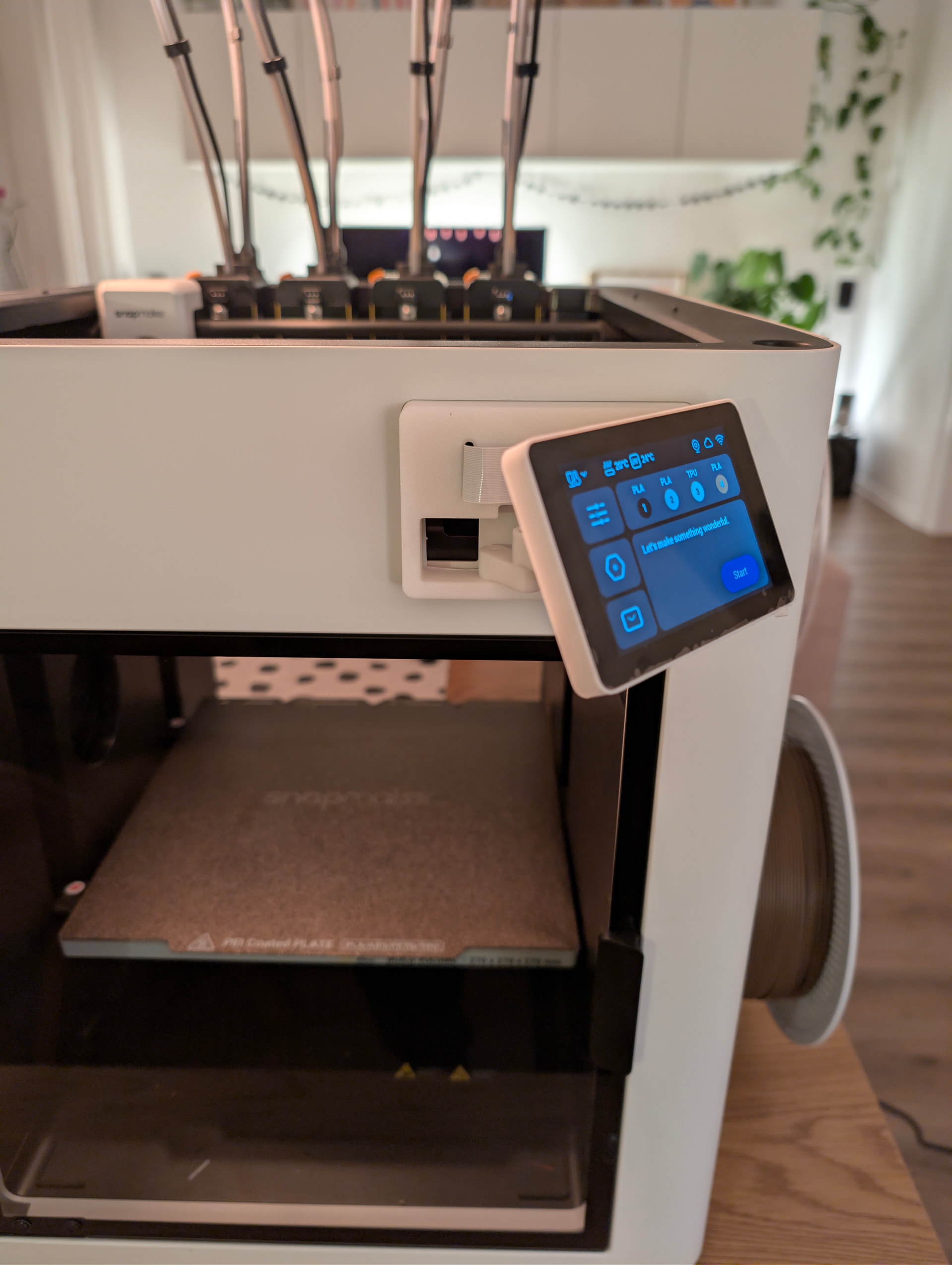

I built a swivel and tilt display mount for the Snapmaker U1 because I was annoyed by the original display position in the plastic housing—especially when the printer is placed in a corner or at a higher or lower position.
The display is factory-installed “only” with a kind of double-sided adhesive tape and can be easily removed.
With this mount, the original touchscreen display is preserved but can be swiveled sideways and tilted up or down. The mount remains in the original position within the housing.
The resistance during adjustment depends on how tightly the screws are tightened. You can adjust it so that the display is easy to operate without shifting unintentionally.
You’ll need to print 7 parts (very simple parts), plus M3 screws, double-sided adhesive tape, and an extension cable for the display.
I’ve created a detailed assembly guide (in German and English).
You can find the printed parts and assembly guide on Makerworld: https://makerworld.com/de/models/2274761-snapmaker-u1-swiveling-touchscreen-mount#profileId-2480088
Maybe you have some improvement suggestions :slight_smile:

I built it - excellent fit and an easy-to-follow instruction. Thanks a lot for your design!

Thanks for designing and uploading this. I find the fixed screen, in my location, difficult to see. In particular the contrast for some ‘buttons’. I may not need the full articulation, maybe just a fixed angle, but your design will be useful. Nice to know someone has been able to remove the screen, and reuse it.
I have fitted my fixed angled adapter. I found a fair bit of heat was needed to soften the glue around the display. All the glue remained on the display, so I was able to reuse it to stick it to my mount. For fixing my mount to the case, I used half of the cheap machinist’s trick, - good quality painter’s masking tape and super glue. I taped the lip on the printer recess, put the glue on the back of my adapter. With a lesser angle, it may be possible to not require the extension ribbon cable, but 100mm was good enough for this. I’ve attached the zipped .obj file.
