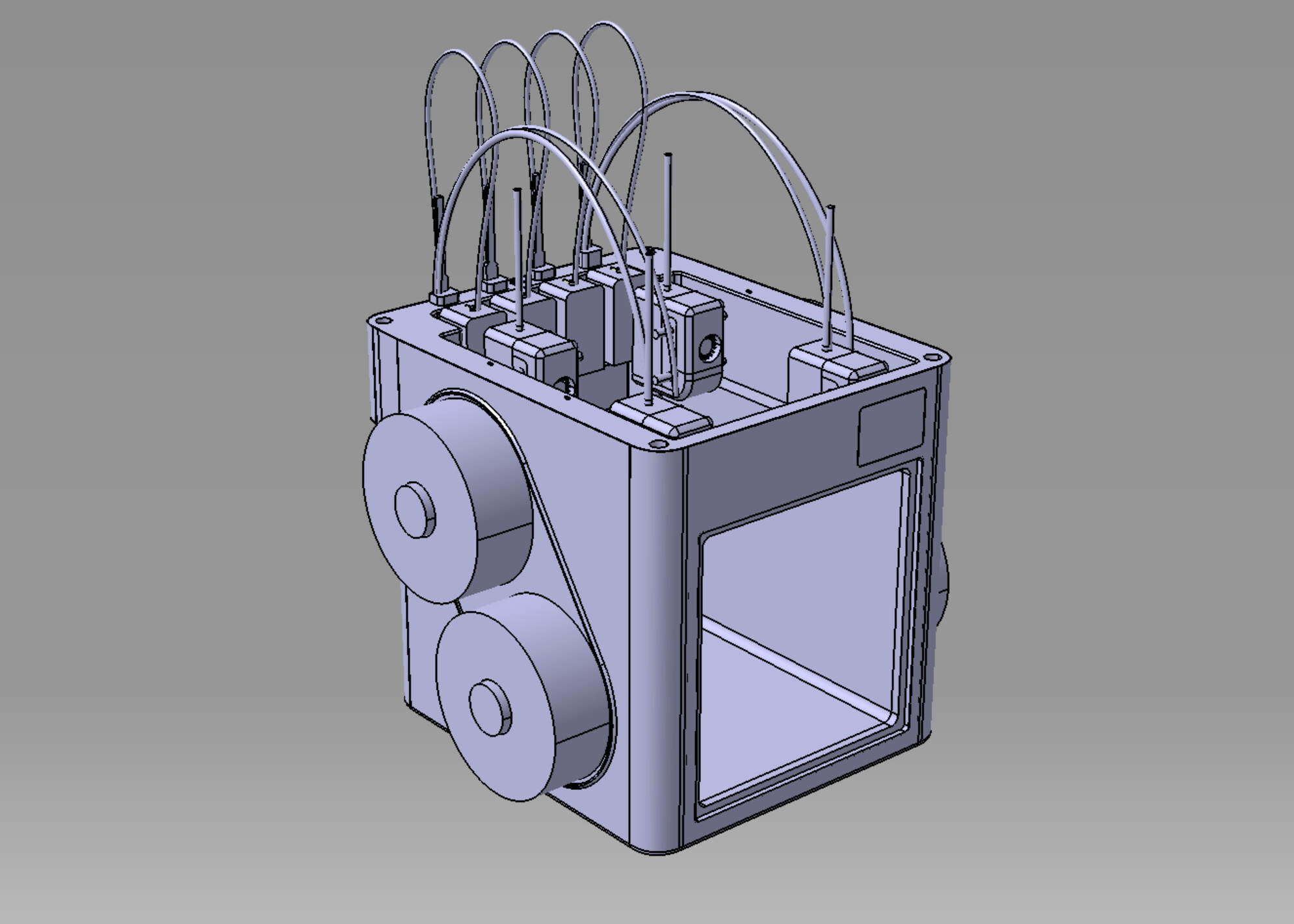

Here is the final version appearance effect that has been tested so far.
This version uses magnetic door closure; apply a 1 mm-thick, 10 mm-wide strip of EVA tape to the frame. Here is 3MF:U1 TOP_COVER_for SMOrca.zip (3.4 MB)(2026-01-01)
Top Part STP:You can modify the STP file yourself.
Top part.zip (512.6 KB)
Door CAD :PC_Door_3pcs_CNC_3.17mm.zip (83.3 KB)
Latest machine STP file with adjusted dimensions:
Product_TOP_COVER_2025_1227.zip (671.1 KB)
DXF file for CNC or Laser Cut:
