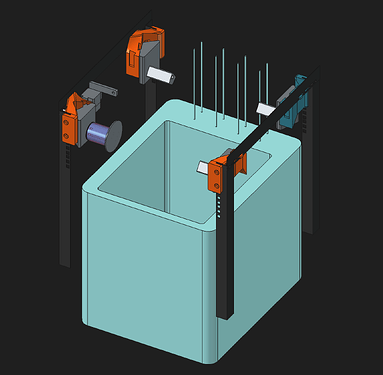

Enclose a Snapmaker U1 3D printer in a standard 15-unit 19" server rack.
This project is a guide and a set of 3D-printable parts for enclosing a Snapmaker U1 3D printer inside a standard 15U 19" server rack. Check out the 3D model previews
You can find the source FreeCAD file as well as STEP exports and many more at Servergnome Prints / u1-in-a-rack · GitLab
It’s also available at Printables U1 In A Rack by horza | Download free STL model | Printables.com

Slice the STEP files yourself. Do not print my 3mf file, it’s there only for reference. I don’t take any responsibility for that 3mf file. For all you know, I might have tuned the profiles in there to break your printer. Included STEP files can be opened in all slicers and if you need to re-export any of them there’s my FcStd file which can be opened in FreeCAD or any other CAD software that is able to read FreeCAD files.

This plan is comprehensive—I think it’s excellent.:+1: :star_struck:
But I realized you can’t use the auto-feeder anymore.
Yes, it’s very sad :frowning: I tried to incorporate feeders but angles are just too sharp. Maybe mounting them on 2-axis swivels somewhere around the middle of the top would help. Haven’t tried. Also I haven’t yet disassembled feeders to see if they could maybe be split into 4 independent feeders. That would totally allow using them.
NFC also doesn’t work but that should be easy to solve by adding a back to spool rollers and extending coil wires.
Maybe community can solve those problems :smiley:
There might be disassembly photos on the wiki, but as I recall it can’t be split; it switches between two feeds with a single lever.
The most straightforward fix is to add an extension cable—though you’ll need to solder the ribbon connector yourself; I checked the spec: GH 1.25 mm, 15-pin with latch.
