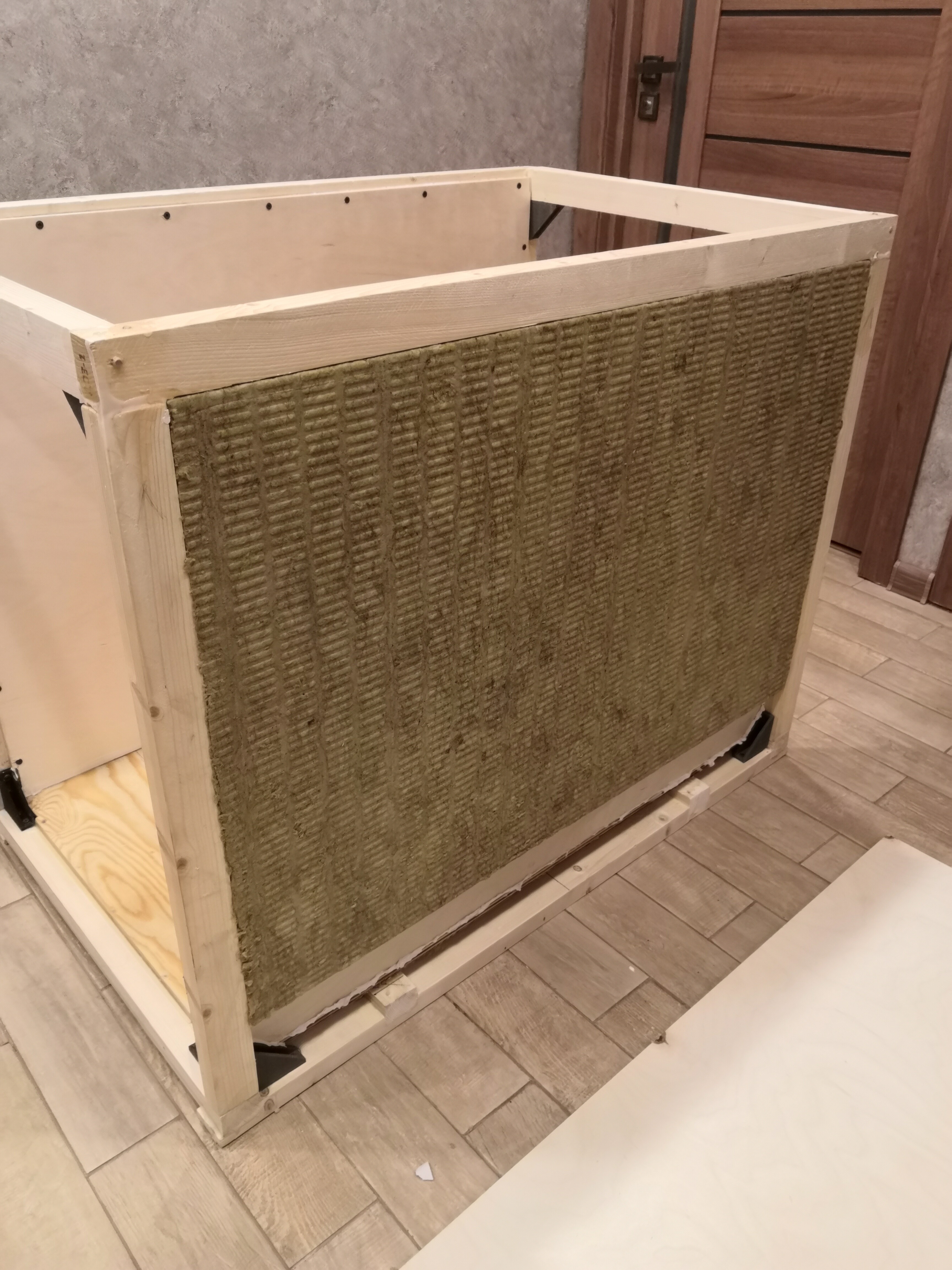

I’m going to be building an enclosure for the A350, largely with materials on-hand. I have a shelving unit next to the workbench that has a 30" w x 36" h x 29"+ d (the + because the enclosure can stick out) space and which will provide a solid base.
So far, I have only used the 3D-printing function of the SM2, so I am not sure what additional cosiderations should go into the design for the other functions.
Here are my thoughts so far:
  • access : the majority of the access will be through the front and the X-axis zero (left-hand) side. This is necessary due to walls on the rear and right-hand side of the shelving unit: the A350 will need to be removed form the enclosure for additional access. The front panel will be hinged, likely on the top.
  • laser safety: the enclosure walls will need to have laser shielding (e.g. [JTech 250nm to 520nm laser shielding])(250nm to 520nm Laser Shielding | J Tech Photonics, Inc.) windows in opaque walls. This might take the form of hinged overlay, or slide-in replaceable, panels
  • dust management: a shop-vac hose, and a fan intake opposite, will handle the CNC dust.
  • humidity : basically a sensor and an eva-pack.
  • temperature : insulation on at least two walls (the rear and the right, which are fixed as noted above) and the ceiling. A duct may be provided for a hot air gun, should the insulation (and pre-heating with a small space heater) prove insufficient.
A couple of points I am unclear on:
  • panel material: how much of a fire hazard is there with wood panels when using the laser or the CNC? Should the interior be non-wood, e.g. drywall or insulation?
  • filament feed : Filament has to be kept outside of the enclosure so it won’t melt, but also needs its own air-tight enclosure. This will likely be a box on top of the enclosure with some dessicant and the reels mounted on their side. Should the filament feed into the enclosure be through a slot cut above the X-axis module? Or will a single hole drilled for the filament work without binding the filament?
  • air leaks : how important is it to minimize air leaks for maintaining a 3-D printing temperature? The joints can all be filled with silicon sealant, any holes in the panels can have rubber gaskets, and hinged panels can have window seals. But at some point there are going to be diminishing returns.
Stuff in my enclosed.

3" thick rockwool batting on all the walls, ceiling, and floor for sound proofing. The floor has a 3/4" piece of plywood on top of the batting. And the door has fiber soundproof panels attached. I can have the unit running full blast at night while I sleep and I barely hear it. The (quite) cooling fans on the outside radiator is (mostly) the only thing I hear.

Yes you want to maintain a stable environment. A completely sealed enclosure will get WAY too hot, will shut off, and your filament will start to melt on the spool. Trust me on this. The addition of the heat exchanger was necessary. Getting too cool will not be a problem.
Also, a vent (especially in a basement) will not allow you to control humidity. I store my filament in the enclosure because it acts like a big dehydrator. I do also have a dehydrator but I run my printer pretty much non stop so I can save on the power bill. Dehydrators suck a lot of power from the wall. My vacuum vents (filtered) right back into the enclosure. Otherwise the air it blows out will be coming from outside the enclosure and then I am no longer controlling the environment inside.
Hmm. Maybe I’ll just build it three-sided for now (back, right, and top) with a box + spindle for the filament on top. Kick the rest down the road until I have a need to spend that much time on the design and build. Right now I don’t even use the thing.

My custom enclosure is aluminum extrusions, plywood, and plexiglass, and I’m not worried about fire hazards.
I wouldn’t think you’d have to worry about the laser being a fire hazard, unless you’re doing silly things like mounting your laser head sideways to paint some eggs (and then I’d wanna be remotely monitoring with a big ol’ e-stop button anyways).
As for the CNC, again, unless you’re doing something really wrong, the chances of you making a fire big enough or making something hot enough to be able to ignite wood around the SM are slim.
Right. I’ve intentionally tried to start a fire with the laser and ended up with just a bunch of smoke.
That was my thinking as well - I regularly bounce smoking hot steel chips off plywood walls in my machine shop with no trouble. I’d seen some concern about plywood enclosures when reading various writeups online, and was curious if those concerns were justified.
Any thoughts on insulation, guys? Should I bother, or is it just a waste of good foam?
EDIT: Actually, looking at my photo, I noticed something i didn’t see before: the hangers for the topmost removed shelf are right about where the top of the enclosure would be. So I can just build walls up to those, then have a slide-out top which doubles as filament storage.
I tried a few soundproofing materials before landing on rockwool. One of the benefits that I was unaware of when I got it is that fact that it is flame retardant to 2150F. A bag of 12 batts was $50 at Lowes. I used 5 in my enclosure. IF you’re near Sumter, SC. you can come get the other 7… :grin:
Rockwool is fantastic - I insulated the shop I built in the barn with it. One of the purported side effects is that mice won’t steal it for nesting, because it is so itchy. Well, not these mice - they’re building McMansions in the stuff.

Last night I built the frame. i structured it so the bottom braces are on the outside of the frame, and the top braces are on the inside. This lets me swap panels in and out. I have some overside veneered plywood (visible in the pic I posted) that works well, though it is a bit thin for the space as I had intended to add insulation. A350 fits in it like a glove (I made a 19x20 nest out of 1x5s laid flat, chiseled out clearance for the cables as needed), and the wood gives me lots of options for mounting things.
I’ve had two ideas since knocking off work last night:
  1. 1/4" MDF panel with corrugated plastic on one side. These would be reversible, so the plastic is turned inwards when 3D printing. The idea is to prevent dust from CNC lingering around when printing. The ceiling would have to be covered in plastic at all times. Still mulling it over.
  2. I have quite a few offcuts of foam insulation. It sounds like this is not needed (or, really, desired) when printing - so my plan of making removable panels with an insulated face for printing is mooted. I will probably just insulate the outside of the top of the printer to protect the filament enclosure from all the heat.
I might continue the slide-out theme for the front as well. There’s no need to have a door, really, and a sliding panel lets me swap out a clear acrylic front for a front with a small laser shield window.

Hello dear friends! I wanted to share with you my box for the machine. Mainly used a wooden bar 30x40mm, joiner’s glue joints to eliminate the transmission of noise and vibration. In the walls between the two plywood is a stone wool. Four supply fans with a diameter of 40 mm each are installed in the base. In the ceiling there will be one exhaust pipe with a diameter of 120 mm. Temperature sensors, 5V LED strips, two web cameras. One allows you to observe the process remotely, the second allows you to monitor the quality of fixing the part on the table. The power is done via a WiFi socket, if something goes wrong you can always see and turn off the machine. All my construction is made on wheels, for a quick move. I attach a photo.
