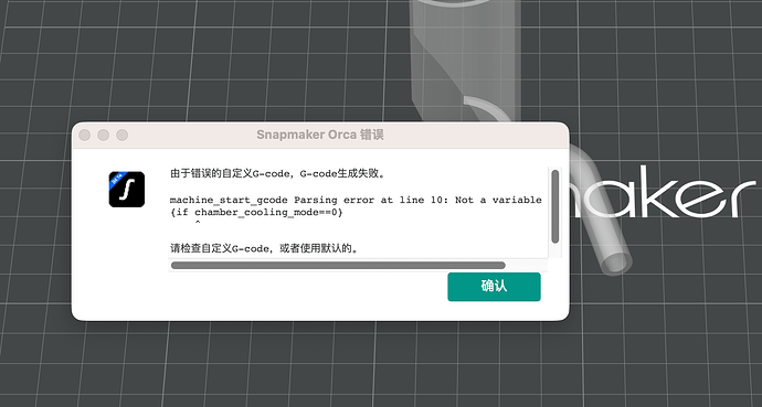

Now the filament was loaded, so a restart should be enough. But selecting the previous print on the interface screen on the U1 itself (selecting the same filament etc) it gave an Gcode error. Only thing that worked to get it printing, was selecting print again from SnOrca.

This 4th print that I started from SnOrca (9 hour print) went well. Perfect quality. However, as soon as I wanted to print it again, selecting it from the LCD on the U1 itself, I got the choice to select the filament (I didn’t change, the preselection was still fine) and could choose for bed leveling, that was already selected, so no changes what so ever). Right after, I got the gcode error again.
Now started a new print, directly from SnOrca, that started printing fine.
Hi, I checked with the engineer and he suggested that we need to completely uninstall the Snapmaker Orca. Could you please test whether it helps?
Snapmaker Orca Complete Uninstallation Guide (1).pdf (913.5 KB)
Hi, did you happen to save a screenshot of the G-code error? is it the same as the first time:
Could you please send a support ticket(https://snapmaker.formcrafts.com/u1-troubleshooting-request) and help me export the U1 log:
https://wiki.snapmaker.com/en/snapmaker_u1/troubleshooting/U1_export_log

Got the same error when I installed the v2.3.5 Appimage on my Linux box. I went a head sliced & printed without issues.
Im not at gome right now, but tomorrow I will send the files.
