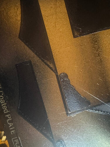

What the hell is going on with version 1.5.1?
This is the first layer without "Heat Bed
Why does it just leave out the bottom corners?
Hi, would it make any difference after bed leveling and calibration?
Have you tried to submit a support ticket to the technical support:
https://snapmaker.formcrafts.com/u1-troubleshooting-request
Hi, we’ve received several similar reports regarding first-layer quality issues on both 1.5.0 and 1.5.1.
Version 1.5.1 was specifically released to address certain adjustments made in 1.5.0 that could lead to poor first-layer performance.
Previously, firmware updates generally did not require bed leveling or calibration afterward. However, due to the changes introduced in recent updates, these steps have become necessary.
From what I’ve gathered from our engineering team, the 1.5.1 firmware itself is performing as expected, but it does require specific adjustments after installation. They are currently preparing a wiki guide that will outline the required procedure in detail.
