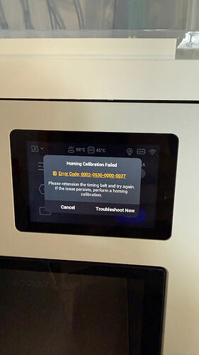

And on top of that, I received an error message after the print, when starting the next print:
Error Code: 0003-0530-0000-0027.
It seems everything got properly hot for the first time, and I should adjust the belt tension.

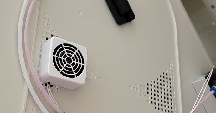

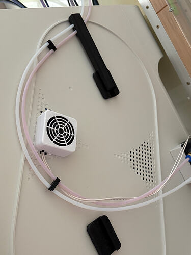

I got a fan 40x10 mm, USB connection and glued this to the right side of the printer, outside, front of Spool no 3, blowing air into the space behind, Temps get to low 50/60° Celsius,
My slightly modified version has now also been integrated. This reduces the driver temperatures to below 55°C.

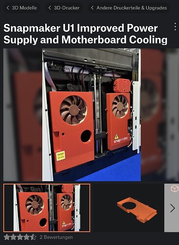

I will install this solution:
See second post:

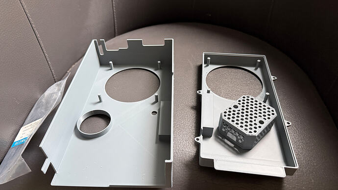

I’ve now printed the covers with HT PLA from The Filament (without post-sintering).
Tested at 90 degrees for half an hour – everything held up fine. At 120 degrees, it starts to soften slowly. I think it’s more than sufficient for this purpose.
Now I’m just waiting for the fans.
