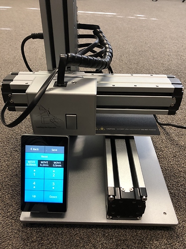

After fully assembled, Heated bed position is far behind form center.
Moved the jog to the forward but, once click the calibrate, heated bed moved to the backward automatically.
How can I fix this problem?
Why is this a problem?
Look at the Heated bed position Heated bed not staying on right position. It’s stay behind from 3d Module.
What’s the right position?
Are you trying to help me up? or You don’t know about this…
I mean I’d like to but right now I’m still trying to figure out what’s your problem;
What is it that you want it to do? Level the bed? Start a print? Brew coffee? Move the bed forward? Play the imperial march from the steppers?
Where to print ? Heated bed staying behind print module, I can’t even calibrate.
Do you print, laser and cnc on your hand?
Okkk so
1-It seems like your printer is in home position; there’s nothing wrong with that it’s just what it does if you let it; it will pass eventually once you give it something to do; see 3rd point for the rest
2-In order to calibrate/level the bed you gotta probe it by tapping on the 1-2-3-4 buttons on the screen and adjust the head height (look at your quickstart guide; the printing module is not for drilling through the bed)
3-You know that in order to print you gotta run a specific file into the printer that will then do all the rest by itself, including not leaving the heated bed behind, right?
