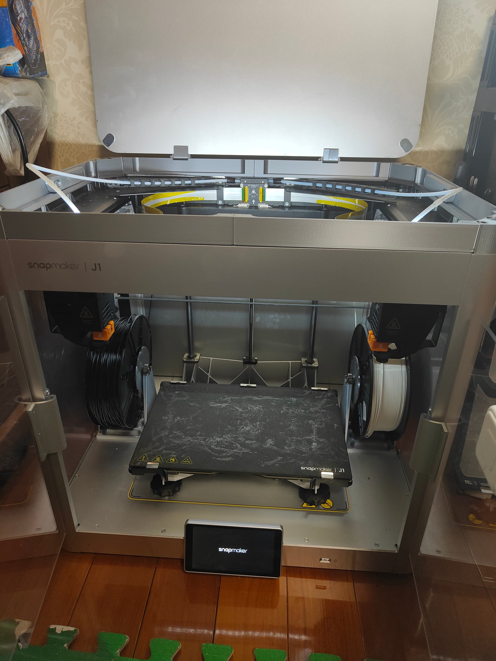

Got a J1 at the end of February and until now I always had issues with printing.
Today I tried to print in copy mode with PLA.
After approx. 10 minutes the print stopped with clogged warning. Unable to do anything but cancelling the job and throwing the already printed PLA away :angry:
Then I heated up the two extrudes and tapped on load… everything is fine, no clogging at all.
I think I never managed to get a perfect print out of this device. The most annoying thing is, that you cannot let the printer print without sitting next to it and waiting for the next error, I don’t like to print anymore with it.
The complete opposite is my bambulabs x1c. Just fire and forget.

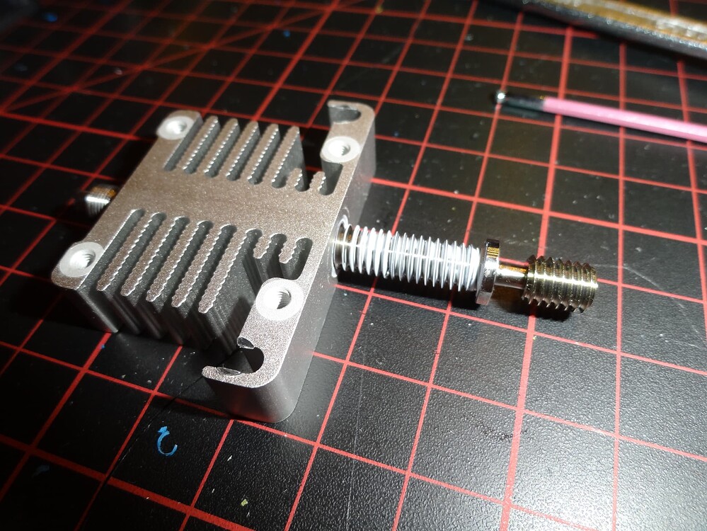

Don’t give up. Apply silicone grease to the heatbreak and modify the filament supply can solve most problems.

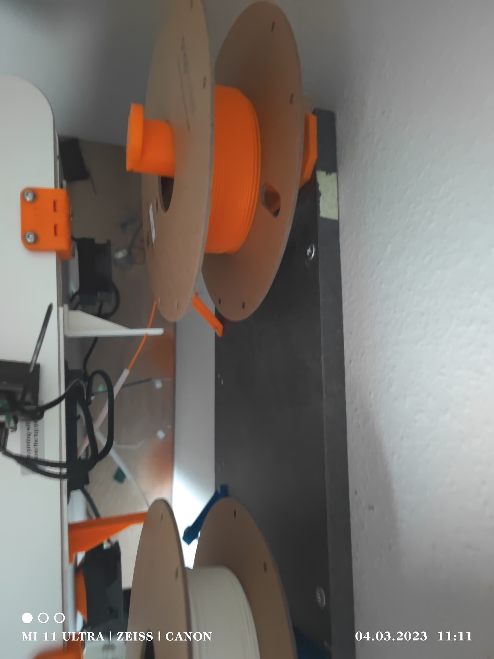

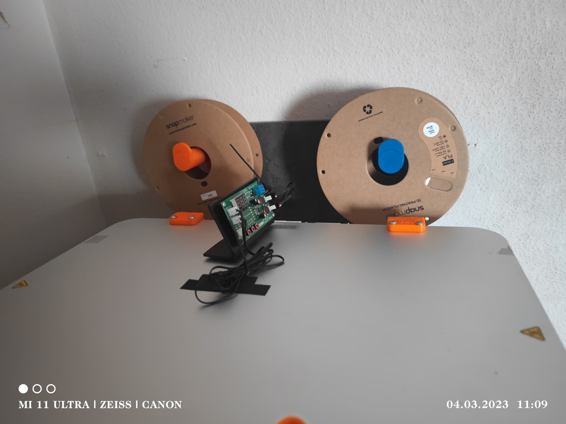

I changed the filament supply yesterday to that design which is shown on your screenshots.
At least I did not have false errors anymore, but one spool which was relatively empty,slipped from the bearings to the front because of missing weight.I was in backup mode and the print finished with the second extruder.
But again, you can see the moment it happend in the print, bad Quality just on this layer. I have to think about putting some weight in the middle of the spools or something else to hold them on the bearings when the are near to empty.
Can you show me a screenshot where and how to put grease on? Have you got a recommendation which grease?

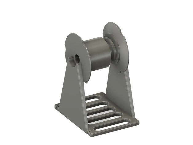

use this design, spool will not slip
Constant extruder skips/clog warnings - Snapmaker J1 - Snapmaker: where creation happens

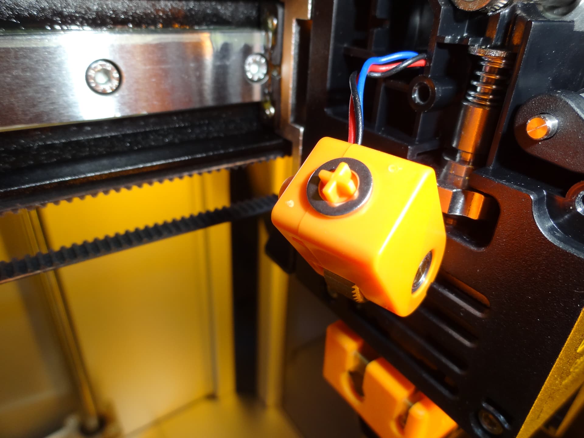

look at the pictures from this post, remove the washer on the filament detector, and apply silicone grease to the heatbreak. I am using the silicone grease for CPU cooling.
Well, removing the washer is optional.
Remember, there are two clog positions in the extruder. if temp too low, the nozzle will clog. if temp too high, the heatbreak will clog. DO NOT set temp too high. if heatbreak is clogged, it is very difficult to unclog. I am now using 215℃ for PETG printing.

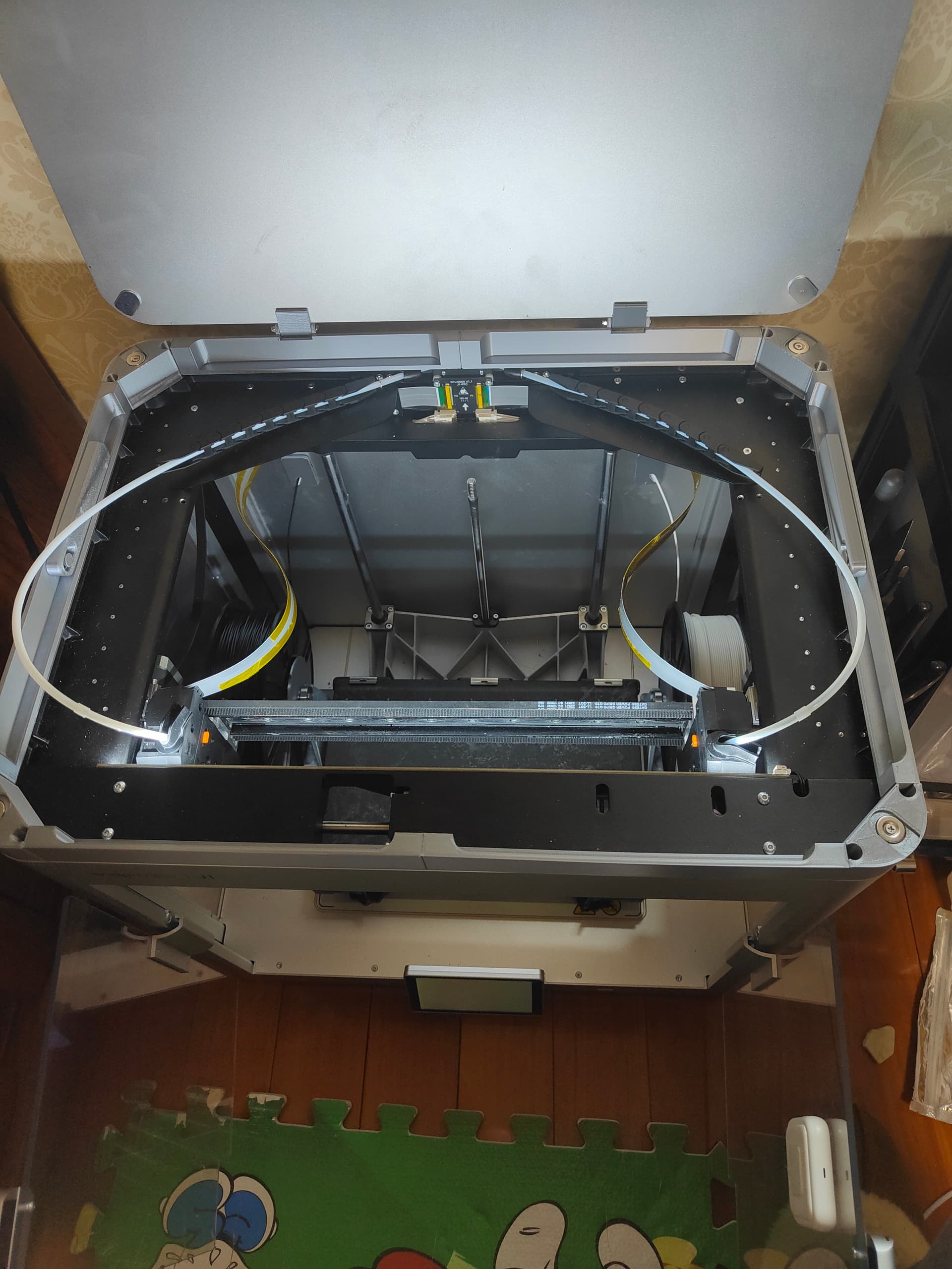

Can not be true to sale a Printer with issues like this. The Toy Fans for Part Cooling are Funny to, way to small and very cheap quality, no much airflow for this temp and speed, i put 5015 on it. now is way better. i can not understand why they use cheap parts like this. we pay much money for the printer so its ok to pay 20 more and get good part coolers. If i had that issues with extruders too, i would Returned too.
