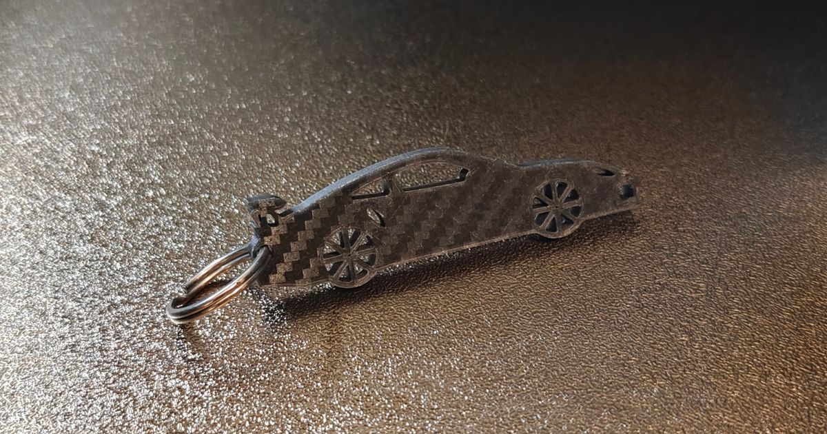

anybody knows about textured pei for j1?
I saw several prints from another 3d printers with such texture. I’m curious if we are able achieve same effect. Maybe there are another ways? I can cut glassy plate but I have no idea how to apply texture on it.
example of such prints:
Personally, I would simply buy a spring steel PEI sheet of the desired texture and just temporarily fix it to the glass side with adhesive and account for the offset in slicer. I haven’t personally tried this for the J1 in particular but I have done this for another printer before.
good point, but yeah the problem is size. I’m trying to find something bigger to cut it out and then maybe use it with thinner glass
How often will you use the full size?
Hi forgot to mention. finally I bought textured pei from chinese online shop (then I cut it with an angle grinder) and I’m using it with thinner glossy plate (4mm). It works perfect
