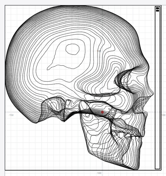

I try for the first time to create an object by importing an STL file into the laser workspace, which slices it into slices which you can than laser-cut from e.g. cardboard and glue together to form the original object.
This works right out of the box very nicely - COOL! - it creates an SVG file for each slice, adds cut/arrange marks and you can process each SVG to generate GCode.

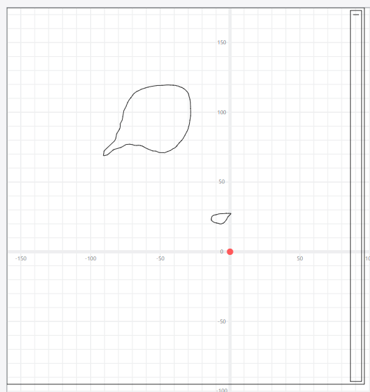

Now, my object would create 37 slices, each ~250mm x 250mm, but some slices only contain very small objects. This wastes a lot of material and will cause significant work.
So here’s my question: Is there a way with or without Luban to streamline this by auto-arranging the slices onto the available workspace and reduce the number of cardboard sheets I need to cut?
To make it more clear, here a few pictures:
The 37 slices in Luban (Yes, Halloween is coming in :slight_smile: ):
Slice number one - nicely marked with number I top right; You can see how much material is wasted:

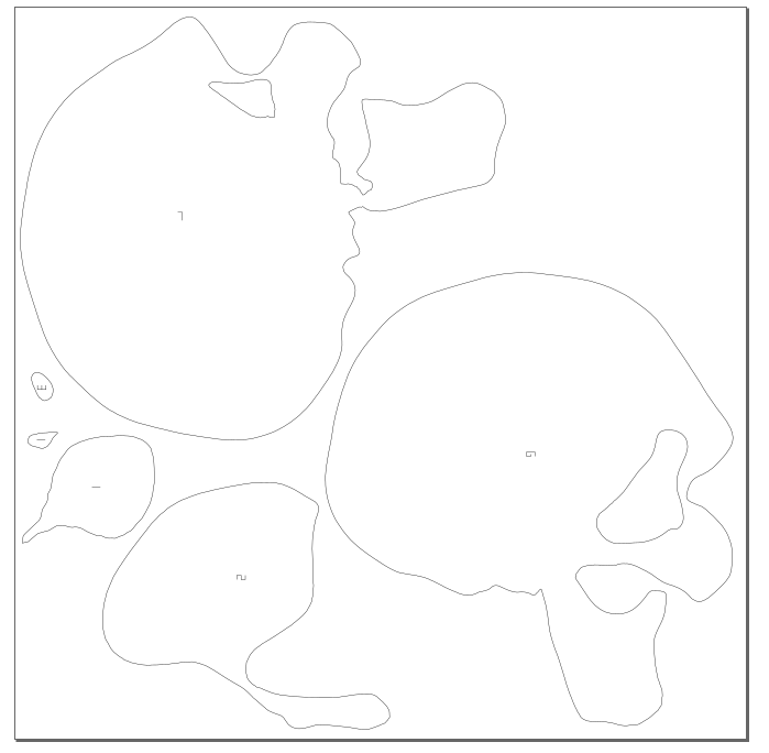

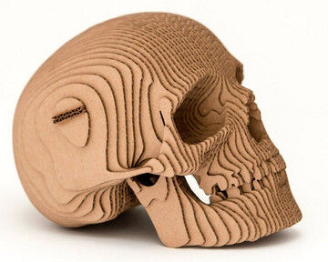

Btw.: This is how I envision it to look like in the end:
