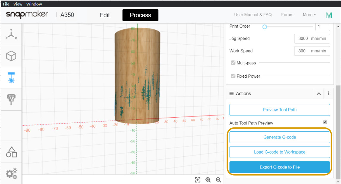

  • STEP 1 Switch to CNC 4-axis
  • STEP 2 Import the file and adjust the size, choose the position of the model.
    • Placement Face
    • Select the chucking surface that will align one of the model’s faces
      • Image Density(Adjust the sharpness of the preview image)
        Image Density = 1
        Image Density = 5
  • STEP 3 Select the CNC bit and adjust the toolpath parameter.
    • Slice Mode
      • Rotation, the right one(For simple models without hollowing)
      • Linakge, the left one (Suitable for complex, hollow models)
      • Step Down
        • The depth of each carving step
  • STEP 4 Generate the toolpath and preview it
  • STEP 5 Generate and export G-code file

Snapmaker Luban algorithm will slice and flatten the STL file according to the material you set in the software.
You mean convert from STL data to flat image data!
Thank you.

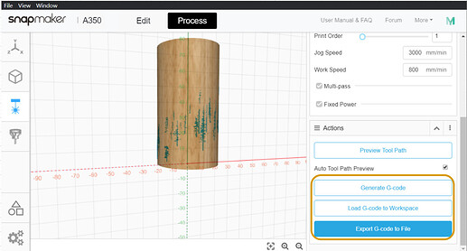

What are you trying to show here? Why would someone even want to make it blurrier?
Also, there appear to be two places to set density, both under the edit and process tabs, but the only one that makes a difference is the one under the process tab.
No matter what I set the density under edit to, 1 or 20, the setting under process overrides it and the end result in simulation and g-code is identical.
I can’t see any differences between Linakge and Rotation. When i press simulate, the two modes look identical and neither are hollow. Is there any extra steps to make linkage work.
Can you supply the helix candle holder model from your demo video as a Linakge cnc pre-set?
their is a difference think rotation will mill in a rotation and work its way to the where it supposed to mill where linked with cut to the center and mill from the end of the stock to the the other end and mill all in-between. i just posted a vid on facebook or linked milling the horse chess piece

I didn’t see an answer here, I also see no difference in Linkage and Rotation slicing. Both simulated models have no hollowed areas. Anyone have a idea on this?
Hi, there should be a problem with the simulation. The hollowed area will be carved when Linkage mode is used.
