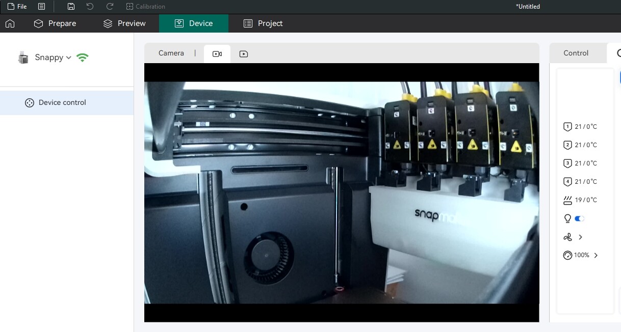

Hi team, I’ve just had a repeat of the fail to send GCode to printer.
This time it’s a single model on a single plate. The last model with six plates completed fine the other day (after exiting Snapmaker Orca and restarting it. The printer has remained on.
I’ve attached the last two entries from the logs.
I’m definitely wirelessly connected to the printer in LAN mode, because I can still switch on the camera and light.
Snapmaker fail log 29 July 2026.zip (1.6 MB)

I only run in LAN mode, so I don’t think it’s related to a cloud connection.
I’m a retired network/wireless engineer, so I have a very reliable (and simple) network setup here at home. Everything is on the came Vlan.
Also, while the error is occurring I can still switch on/off the fans, camera and light on the printer. I also check that I have a solid internet connection while it’s occurring - in fact I post here while it’s happening.
I’m not too worried about this problem - It’s just a minor nuisance when it occurs. I also run some old Ender 3 printers with Octoprint, so I’m used to issues.
Restarting Snapmaker Orca always fixes the issue. The U1 is never switched off unless I’m doing hardware maintenance.
