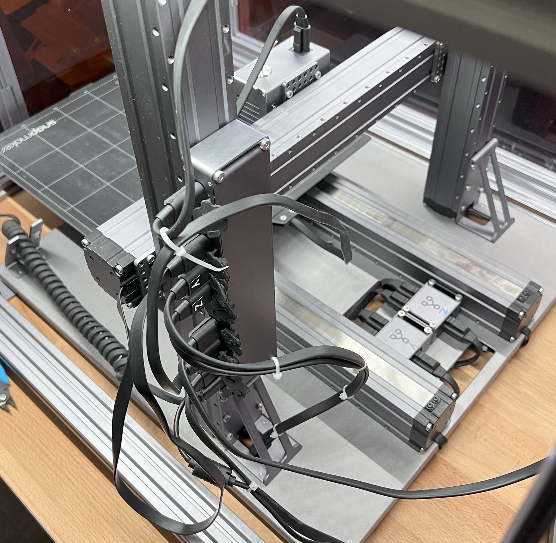

This is the best solution to keep the heated bed cable from bending under the back of the heated bed as it fully retracts, regardless of whether you use an enclosure or not.
Search Thingiverse for “Snapmaker Heated bed cableguide”
Heated_Bed_Cable_Guide
This angles the cable upwards to keep it from bending under the table, and keeps it away from the back wall of the enclosure. The parts snap together easily but firmly. There is another clip for the center of the channel guide that’s not shown. I didn’t print it because the cable stays where it’s supposed to with just the two end clips. This will be the last heated cable guide strain relief you’ll ever need for the A350.
This has been working for over 2.5 years. Zip ties are all that you need.
I Had also No Problems with that cable in my a150, a250 nor a350. It is Long enough and the enclosure is big enough.

Only bummer with your design is if you intend to put larger pieces of material in for lasering/cnc. I use 26" boards alot and they extend over the cable.
So you’re saying you leave the heated bed installed when you laser or CNC carve?
@MikeG2 if you are me, yes I have left it connected and just left it leaning against the wall of my enclosure. If you looks closely, the zip tie is loose, so I can pull the connector through it if I want to completely remove it. Even if fully tied down, zip ties cost nothing, they come in packs of 1,000, 10,000, etc.
