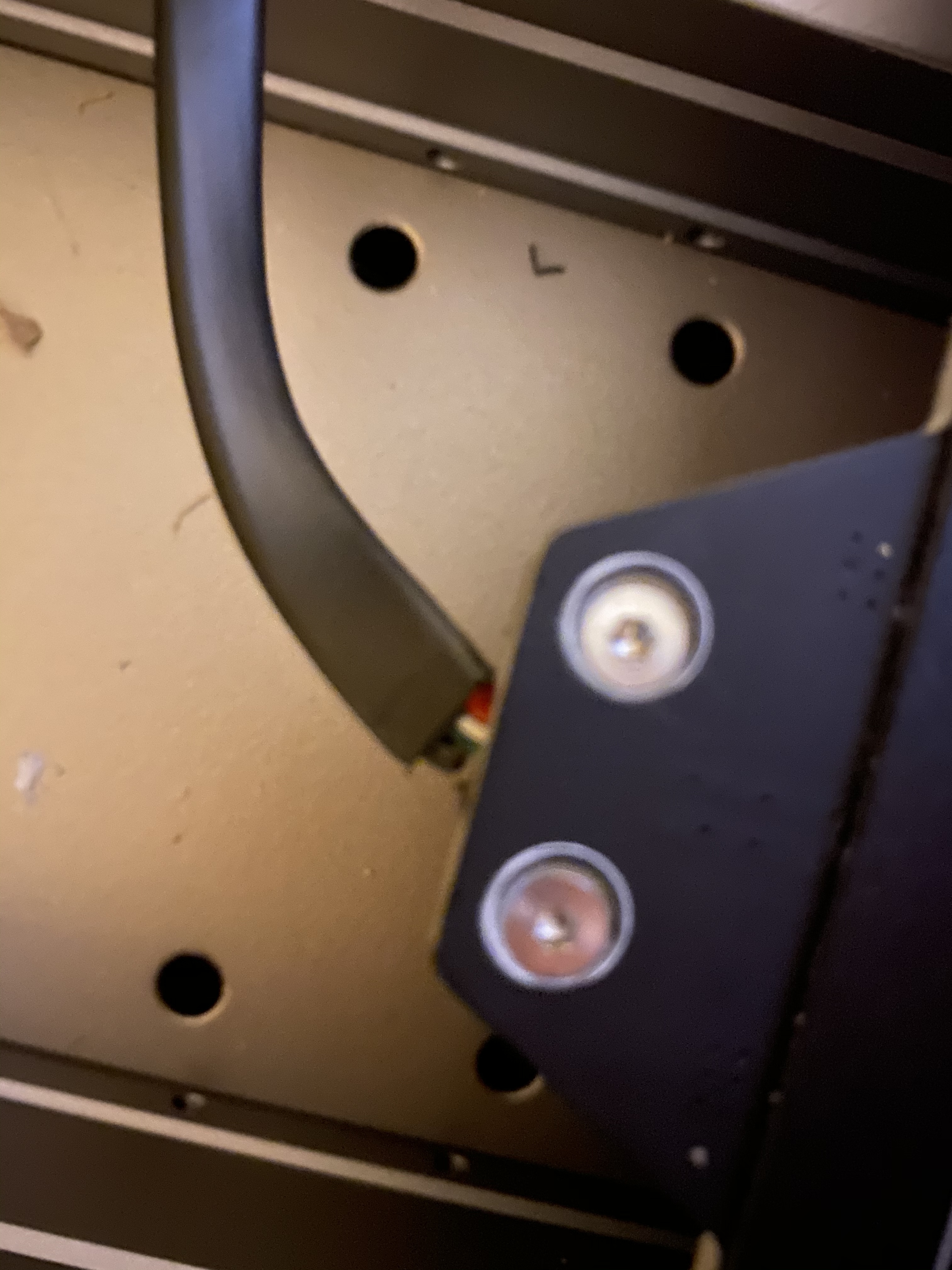

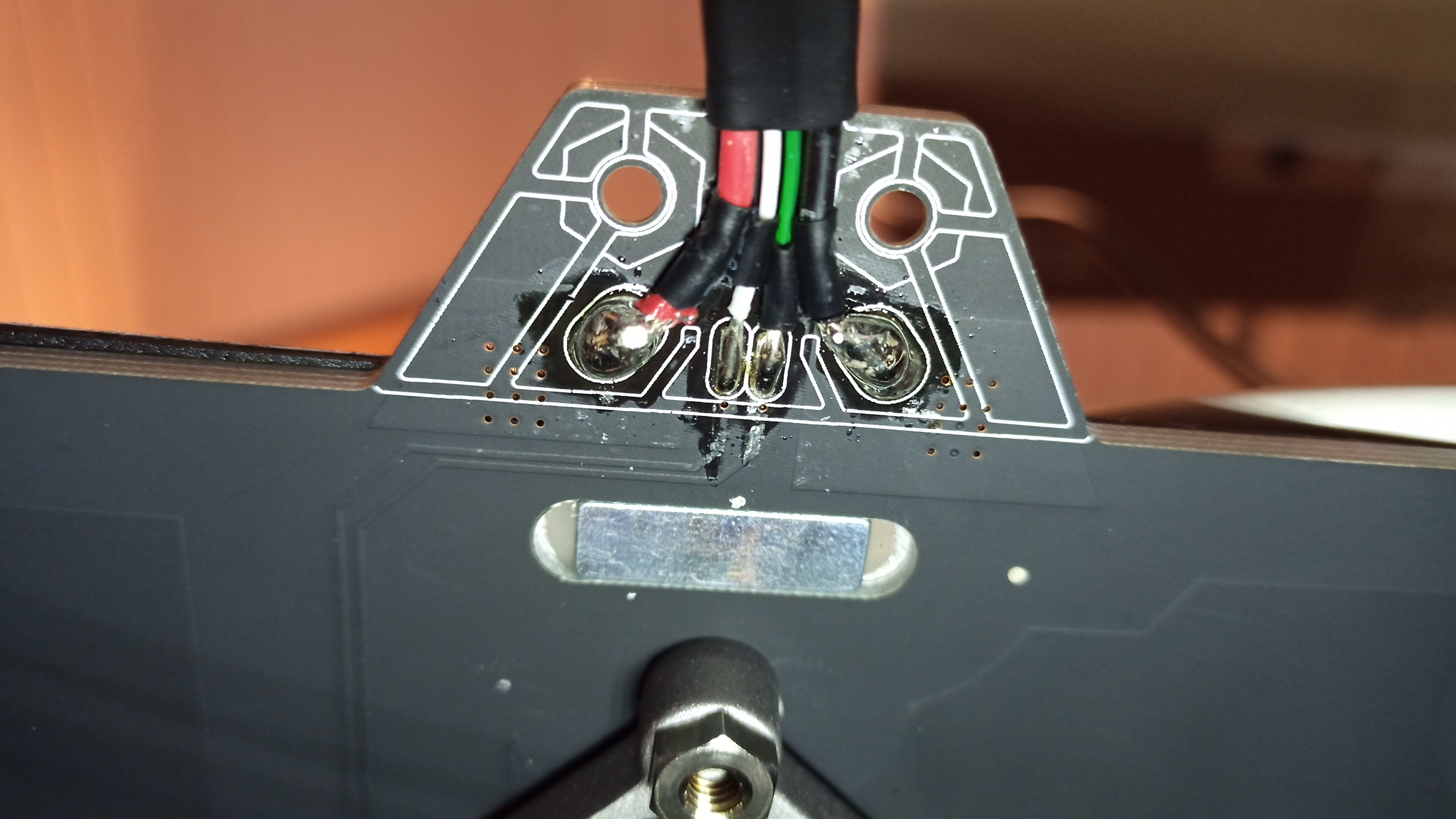

My heat bed wasn’t getting to temp and I realized the cord in the back had snapped from the heat bed shifting enough with prints. I only had the printer for the last 2-3 weeks, do we know how to get replacement parts? (Part of the wire is snapped in the actual heat bed so I think I need to replace both…)
In this case only support@snapmaker.com is the way to go :alien:
Or if you good in soldering, repair it for youself (You do it on your own risk of course)

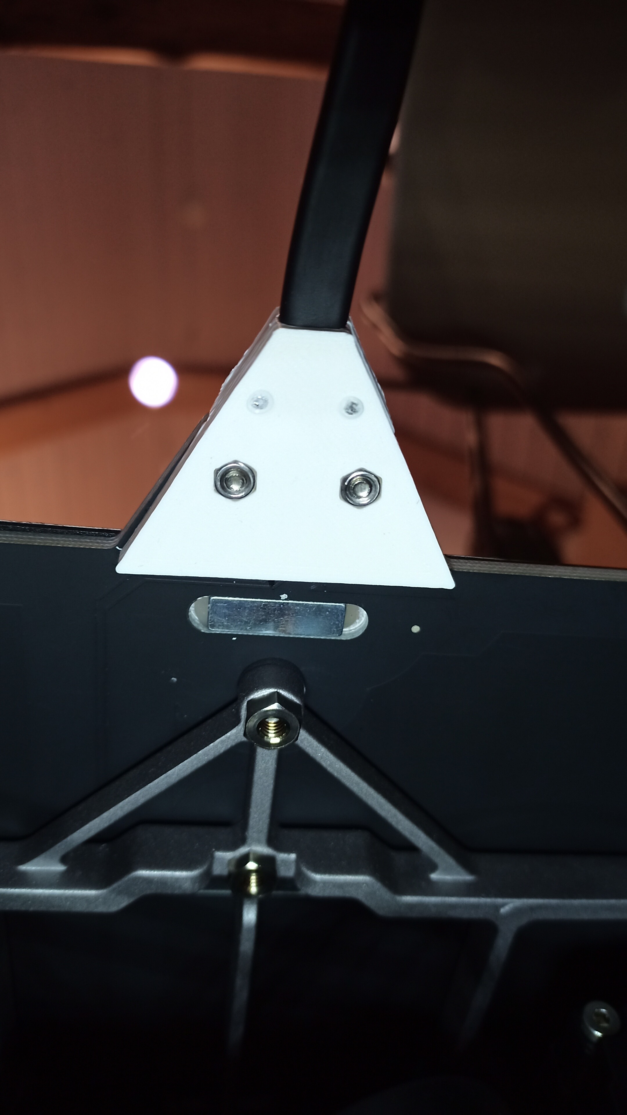

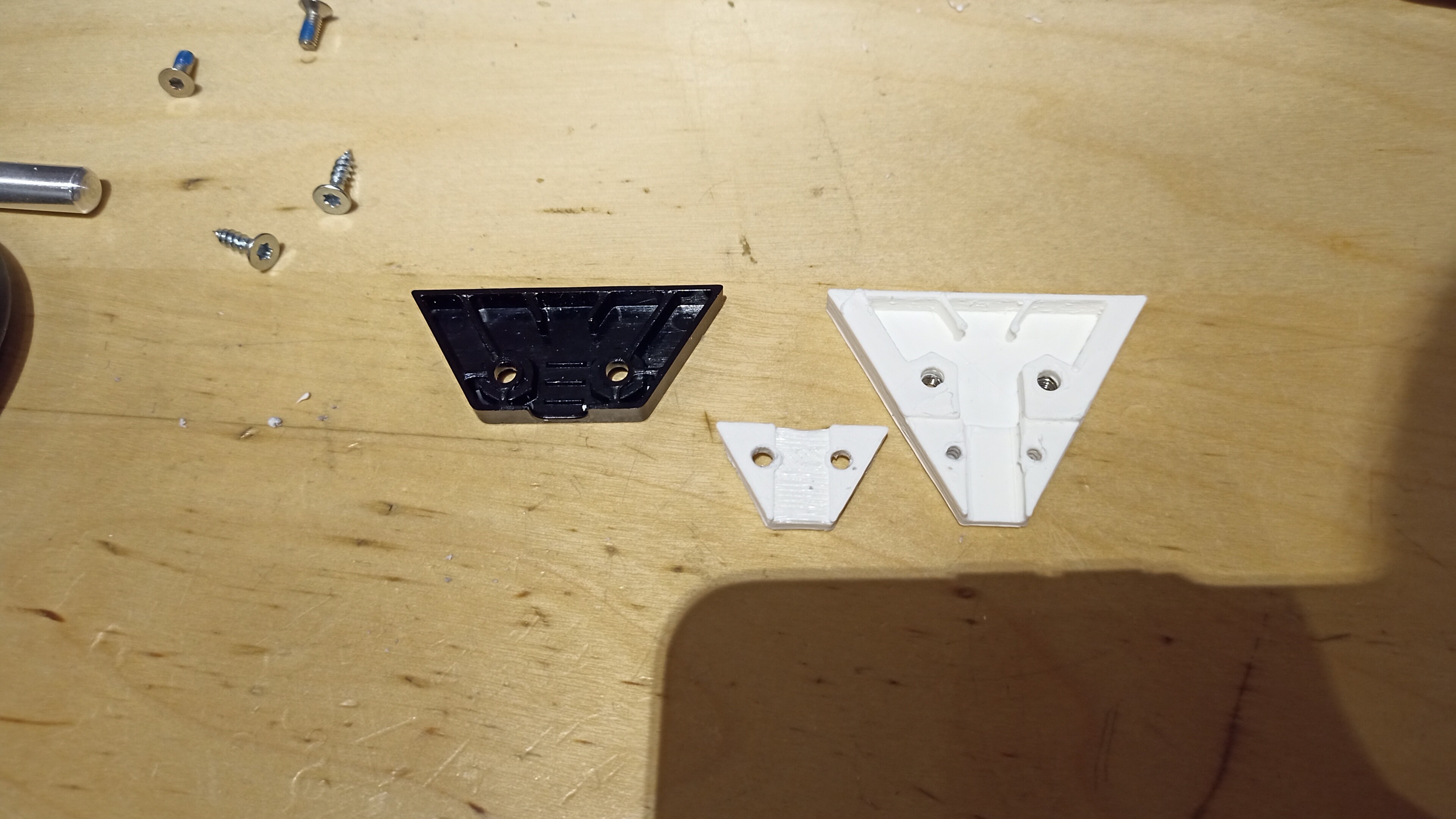

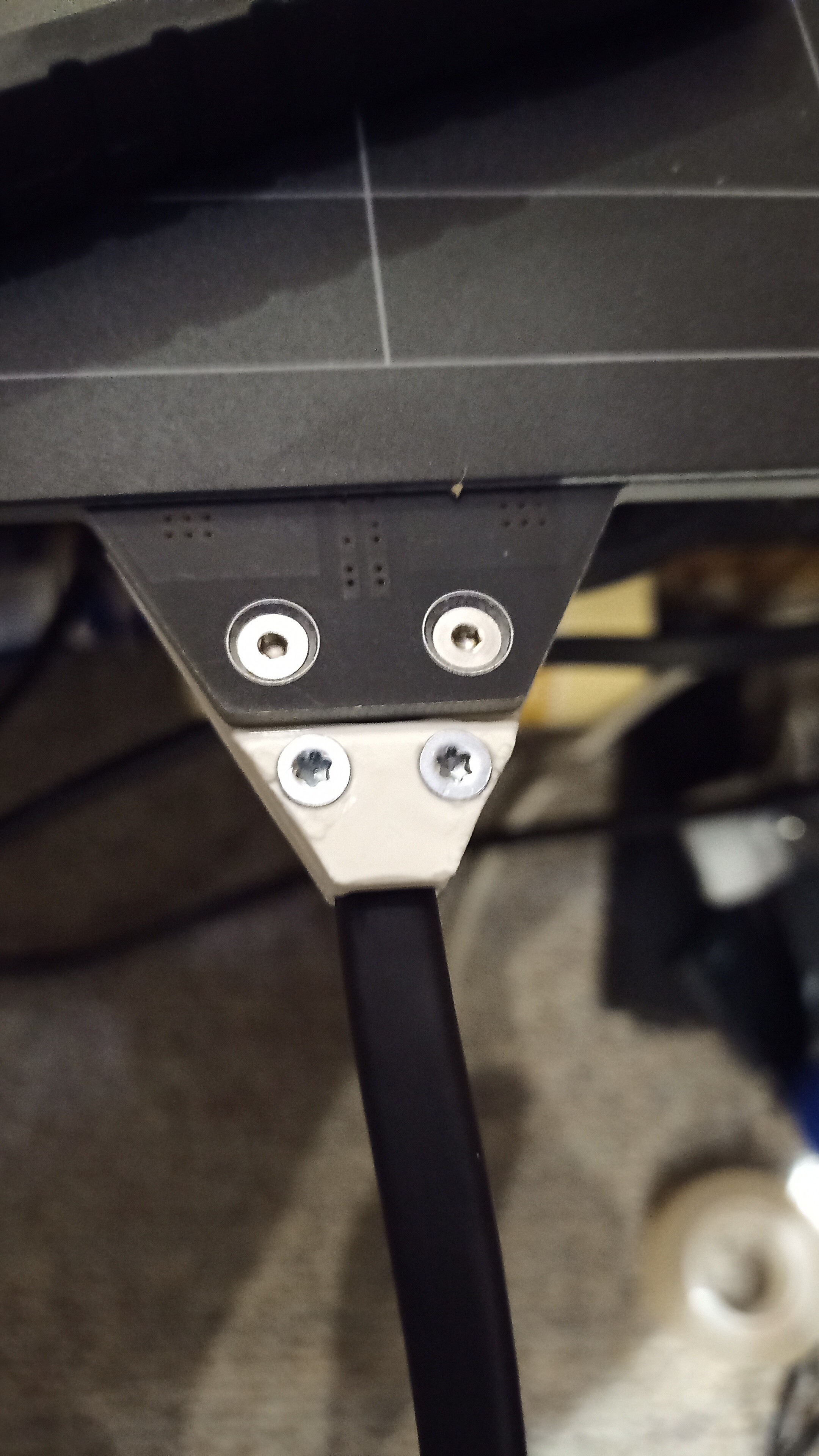

After seeing this Thread resurface after a while ive checked on my Heatbed to see if i have the same Problem building up.
For whatever godly reason, the Cable outer insulation ends exactly where the Plastic part ends. So the three strainrelief bumps are only strainliefing the Conductors, not the whole cable.
With a bit spare time ive cobbeld together a Extension for the cable. Tolate for you but maybe someone will be able to add it before the cable breaks completly.
The surface finish is questionable at best, i had to exactoknive the Nut indents but i think it should work.
Screws ive used for the white part:
3x12 coutersunk Universal screws (self taping)
Files:
SN2_Heatedbed_Strainrelief_Cover.stl (27.0 KB)
SN2_Heatedbed_Strainrelief_Mainbody.stl (33.8 KB)

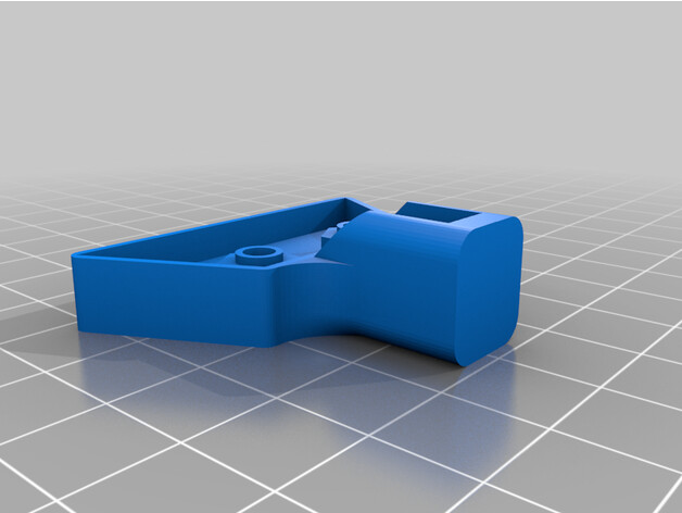

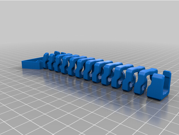

I just found these on thingiverse: they may help prevent the issues. I havent tried any yet although the cable chain looks most promising to me.
I had to solder my cable today since it had worn through after about 3 weeks of use. I’ve lost 10-15mm on the cable by doing this which only makes the situation worse! Thanks for the model links.
me too, exact same situation. 3 weeks of cool printing and then heatbed stopped getting up to temp after a 3 day PETG high temp print. My cord looks fine though and I do not want to take it off and look as I am sure that will disqualify warranty. Unfortunately, they are all on CNY and there is no support right now!

The first one insn’t compabible with the housing…
I´m thinking about this and looking for a solution like Menanchrom posted.

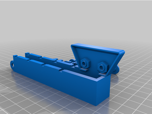

I’ve been scouring thingiverse nonstop, a lot of designs claim to prevent strain but only moves the flex point instead of solving it. Then I found something that might work, I haven’t tried it yet but I’ll post the link, let’s get some thoughts on it.
I actually printed this last night and going to install it later Today before I print anything else. I recommend that this enclosure be everyone’s first print.
I have had absolutely no strain on my cable at all, it just naturally rides elevated up and out of the way.
But, I did print something out to install for the heck of it. havent gotten to it yet.
I noticed the same problem today and successfully destroyed the PCB on the heated bed (probably to hot). So I am relying on the Support to get me a spare part (I never got a reply in past cases).

funy though, mine are quite thick, I’ll post a photo later. I managed do snap the cable and I’m having quite some issues soldering it back.

I’m also affected by this problem, and my heated bed essentially doesn’t work anymore. The cable is cut open with tiny wires sticking out of it. I got in touch with support, but I’m still waiting to hear back…
