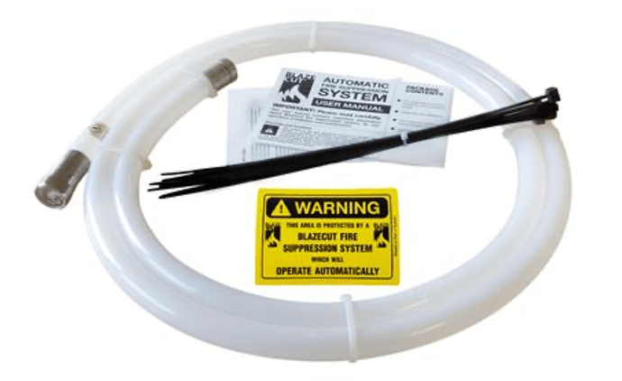

If you have the enclosure you could also put in a BlazeCut fire suppression system for 3D printers in addition to the FireAvert.
the Fire Avert isn’t wat i was looking for! their are a few Smokedetector with Relais available on the (german) market. even the great companies have some Solution (eg. Gira)
But the BlazeCut is a real good hint! Thanks for that!

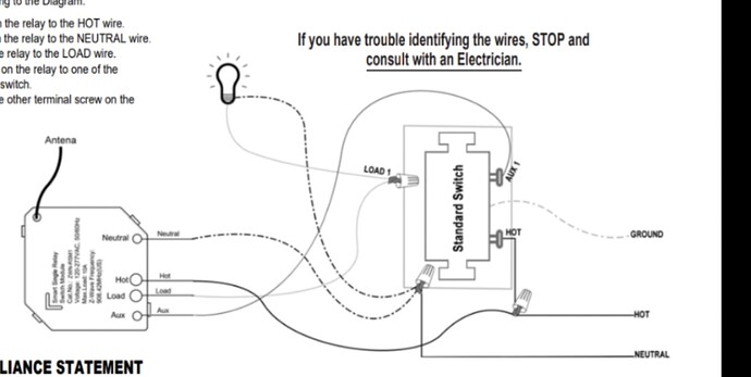

In a friend’s house I installed a zwave switch up to a smoke detector relay wired into their hardwired home smoke alarms. Zwave goes through their HA system and sends them a text.
You might consider rolling your own with a smoke detector and z wave switch.
This was the relay used for aforementioned installation: Kidde SM120X Interconnect Accessories Smoke Relay Module https://www.amazon.com/dp/B00HQNPOHI/ref=cm_sw_r_apan_glt_fabc_HBR8DXS6WNF2PDDEMHC2?_encoding=UTF8&psc=1
If you are not tying in to an energized circuit you wouldn’t need it, just throwing it out there as an option.
For the module we used a light switch relay as they are designed to read a wetted contact (the light switch) and just didn’t use the load output. ENERWAVE Z-Wave Plus Relay, Hidden Smart Switch Wireless Remote Control to Lights and Ceiling Fans, 120-277VAC, 10A, Neutral Wire Required, ZWN-RSM1-PLUS, Black https://www.amazon.com/dp/B01G7OD1F8/ref=cm_sw_r_apan_glt_fabc_W28XVGVAYMMCSFWV9V9N?_encoding=UTF8&psc=1
That could be wired to any off the shelf smoke detector relay output. Typical wiring, replace the switch with a 120V smoke detector with relay output, ignore load

the BlazeCut would be a solution on top of an allert, because this is only working when “die kacke am dampfen ist” :wink:
