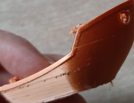

@Slynold I think, this is a combination of issues.
With a layer height of 0.08mm i would suggest to print on the bottom temperature the filament is able to.
The second point about temperature with superfine prints, did you assemble thermalpaste to your thermistor?- This would help to get more consistent outputs.
If you print such low layer heights, you need to calibrate your heated bed very well, best as possible. Because if you dive through your previous layer (even minimal) you will get this peaks on the outside.
I would suggest to print the first layer with 0,2mm, after that 0.08mm or how you like.

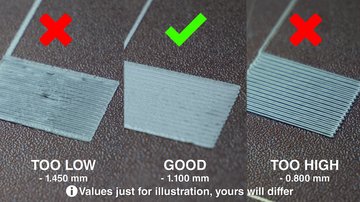

I use five points autocalibration - i know this isnt the best i could do but i thought that at least the middle will be level after fixing the z-offset.
Its hard to calibrate the first layer very well, even with z-offset.
A visual guide showing the different effects of z-axis calibration. Source: Prusa Research

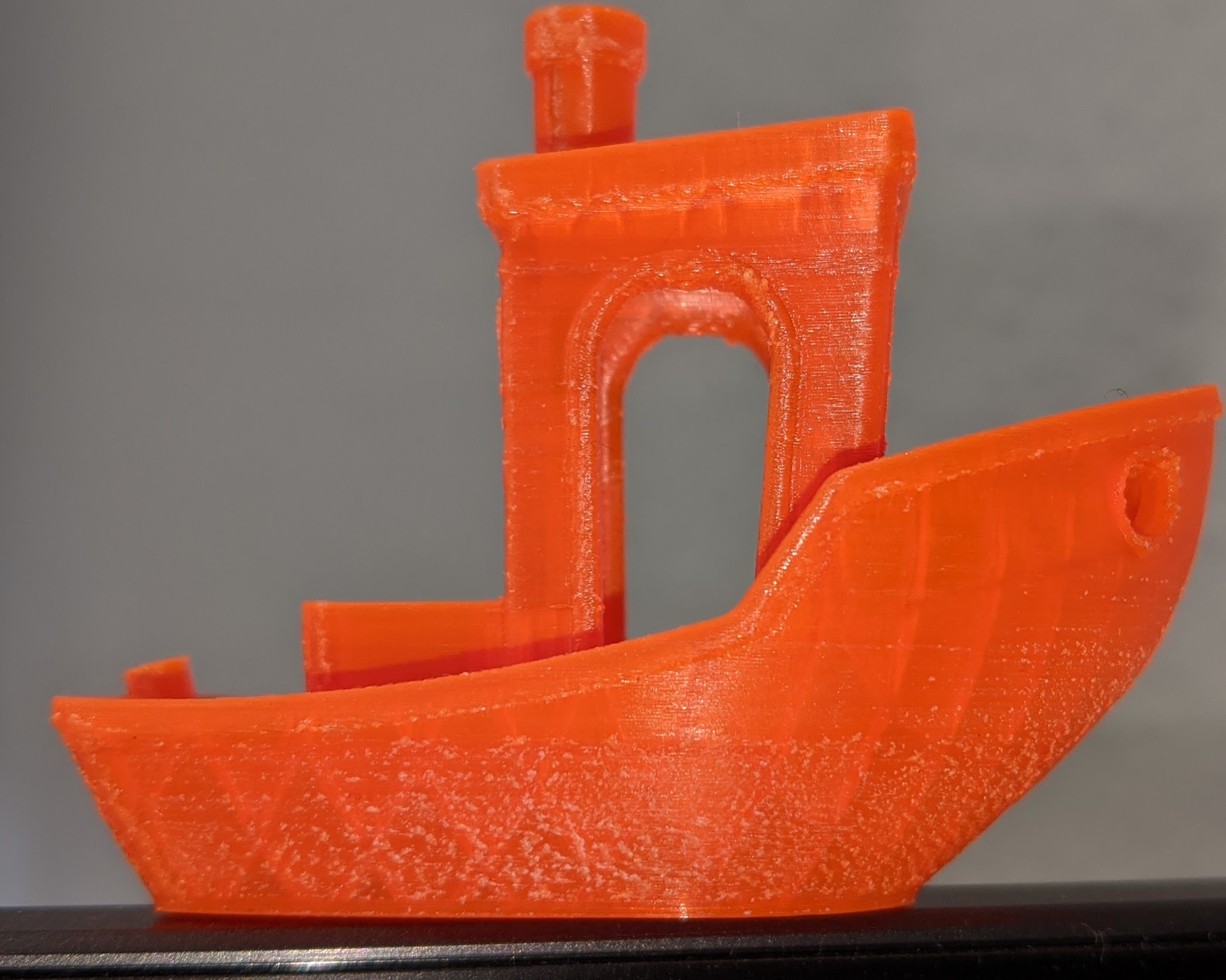

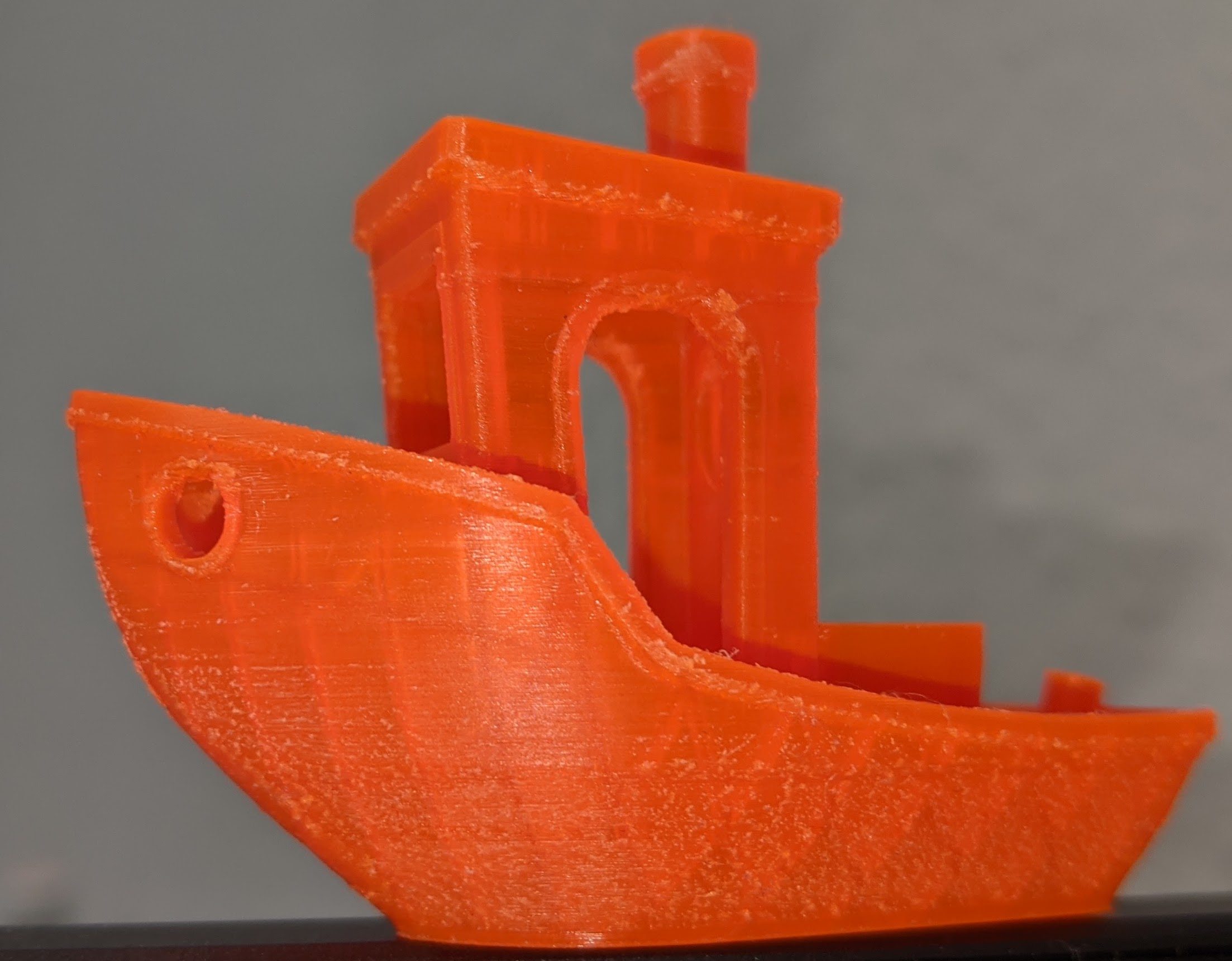

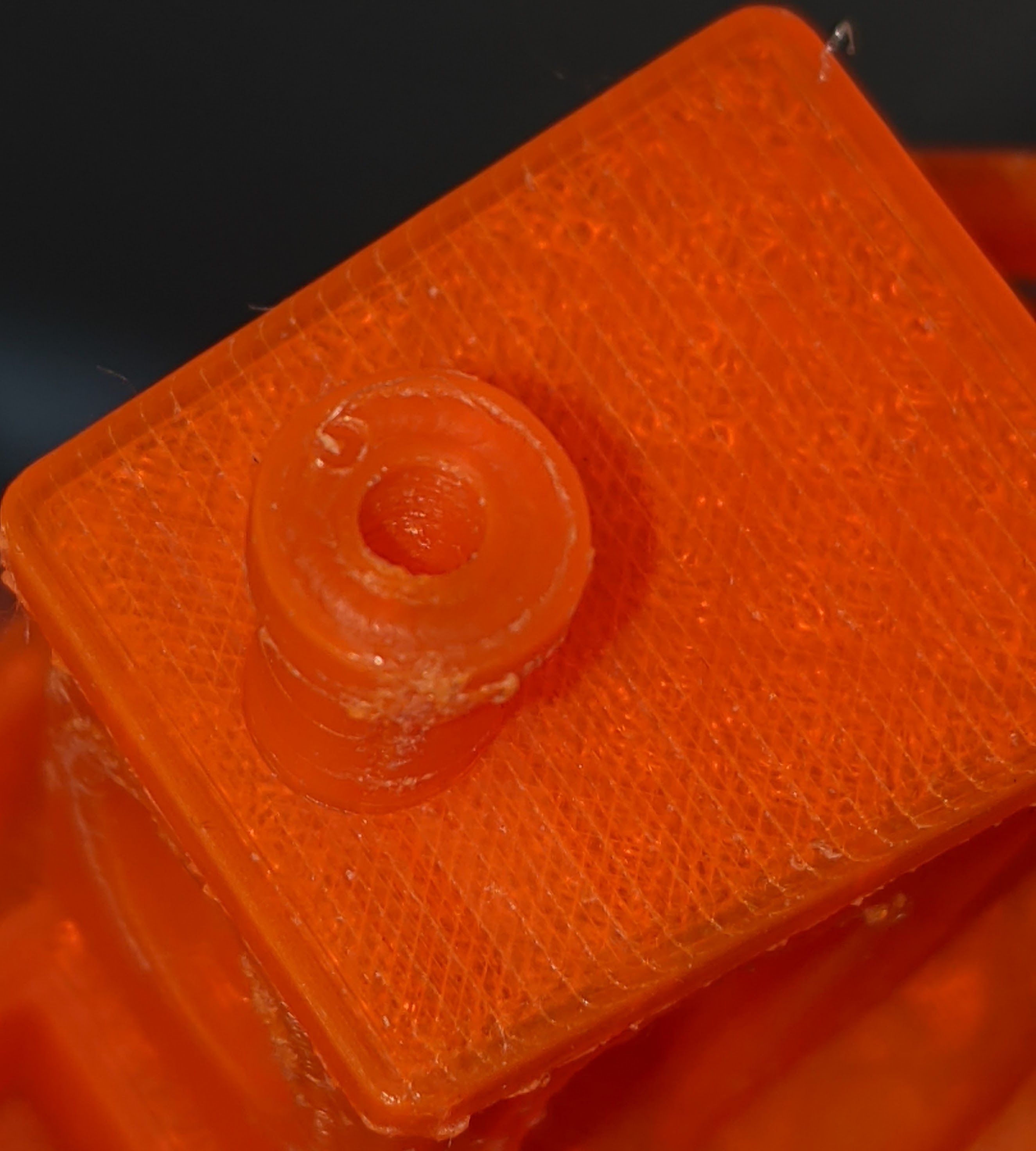

So here is my banchy with the new nozzle.
It seems that the artifacts are a bit smaller.
I can see the nozzle on the chimney.

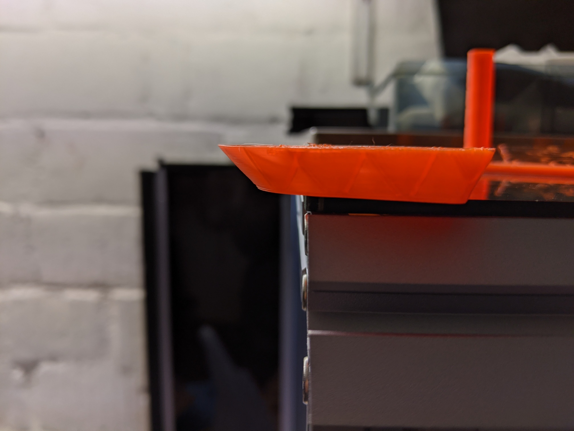

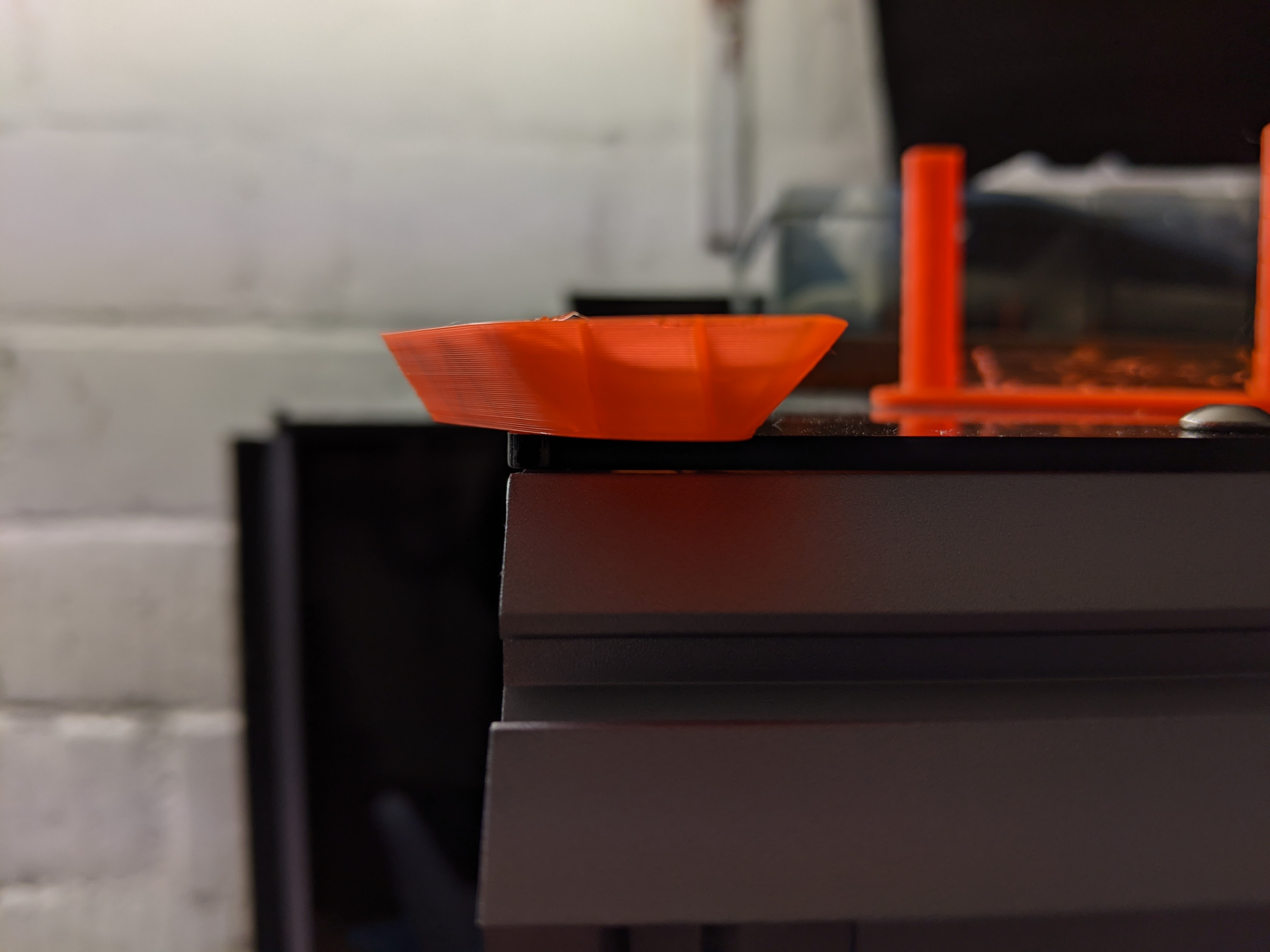

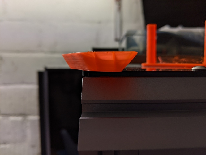

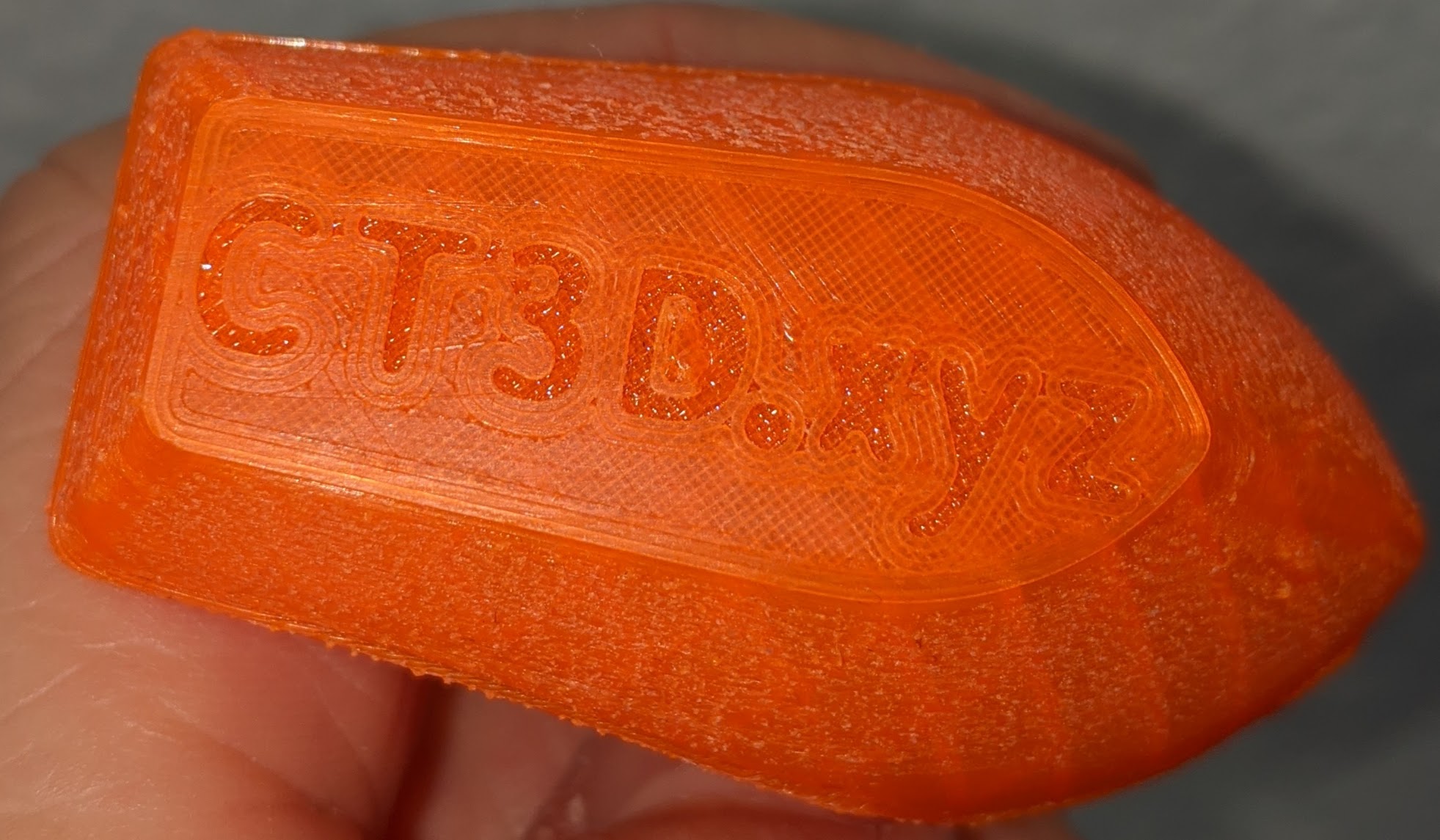

The bottom / first layer looks okay, or am I wrong?
The bottom warped in a tiny elephant foot.
The first layer looks good. I think there’s a small bit of overextrusion causing the elephants foot as well as the mark on the top of the chimney in the last pic.
I think taking these pieces of info together: a) .16 / 40mm/s layer height has no artifacts, b) new nozzle didn’t fix the artifacts, c) last print settings did have the artifacts: I think it’s something with the settings, maybe that layer height just needs to be avoided? Really wish I could watch it print, hard to diagnose images just from a picture.
When it leaves the artifacts during printing can you tell what’s causing it? Is it when the nozzle starts or stops the perimeter? During the perimeter? Is it just a small amount of overextrusion that’s being pushed out the side and curling? Maybe retry, but drop your flow multiplier 1%?

I watched it for a while. You can see the nozzle creating these artifacts. I wish I had a microscope for detail analysis. I sat there with a beer, magnifying glass, and a laptop watching the printer and the simulation at the same time.

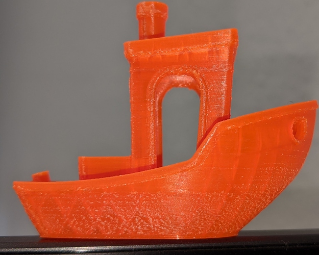

So, sadly my new result isn’t better.
