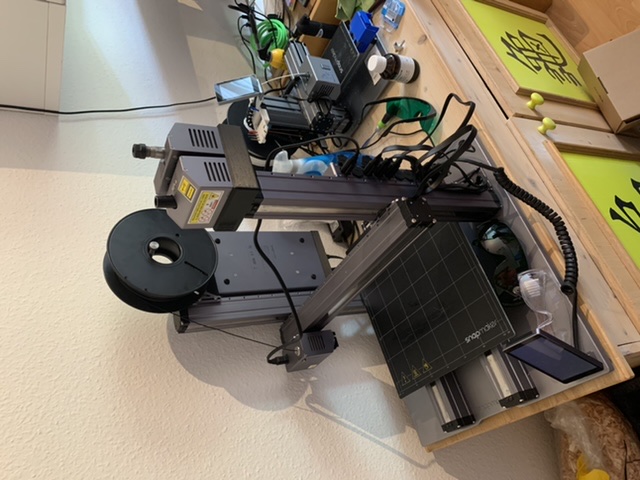

That fan certainly do well.
See picture.
