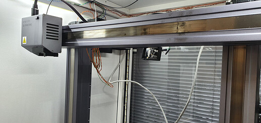

I want to share my diy case i build. Wooden frame. Plexiglass and a wooden backplate. Used rubber draft band to make it dust and sound proof. Made the hinges myself in Fusion 360 and printed them on my SM A350. Made the hinges simply removable.
It’s a It has become a lot quieter. The only thing I’m considering is to replace the fan in the power supply for a silent version.
Now waiting for my orders from China. Ledstrip, Power unit, buttons for ledstrip. Esp32 camera to mount next to the printhead. And a fan for cooling the inside case.

So i added some stuff.
  1. ESP32-CAM with 160 degrees camera
  • mounted on the X-Axis. Used a servo to turn it left and right. Mainly placed to keep an eye on the printing.
  1. 3x ledstrip groups
  • (2x strips per group) (above, left and right).
  1. ESP32 microcontroller
  • Microcontroller for controlling the lights and sensors.
  1. DHT11
  • temp and humi sensor.
  1. 3 Buttons
  • Buttons to switch on the ledstrips.short press = lower brightness, longer press = higher brightness, long press = on/off.
  1. Home Assistant integration
  • to control it in my domotica system (smartphone included).
  1. 2x 12V 3510 FANS
  • to get some fresh air in and bad air out of the cabinet.
  1. 24V FAN replacement in the PSU
  • much less noise
Hope you like my setup.
Questions? Let me know!

I can’t show numbers for temp and humi yet. Made a mistake in wiring the dht11 :grimacing:. I feed it with 5v, but the esp32 has 3.3v ttl levels. So that won’t work. I gonna fix that today. With some fixing of the buttons (these have leds in them, two of them don’t work).
Good question about the 3510. First of all i choose a 12v version, because i had a mosfet left (i ordered for the ledstrips) , and with replacement in mind for a bigger version if necesary. But i made the fan because i can. I can’t tell you if fresh air is necesary. Maybee holding temp in the cabinet is better than cool it down.
Due to the hassio integration i simply can control the fans based on the temp or humi.
If it all works i share the temp and humi numbers during printing.
