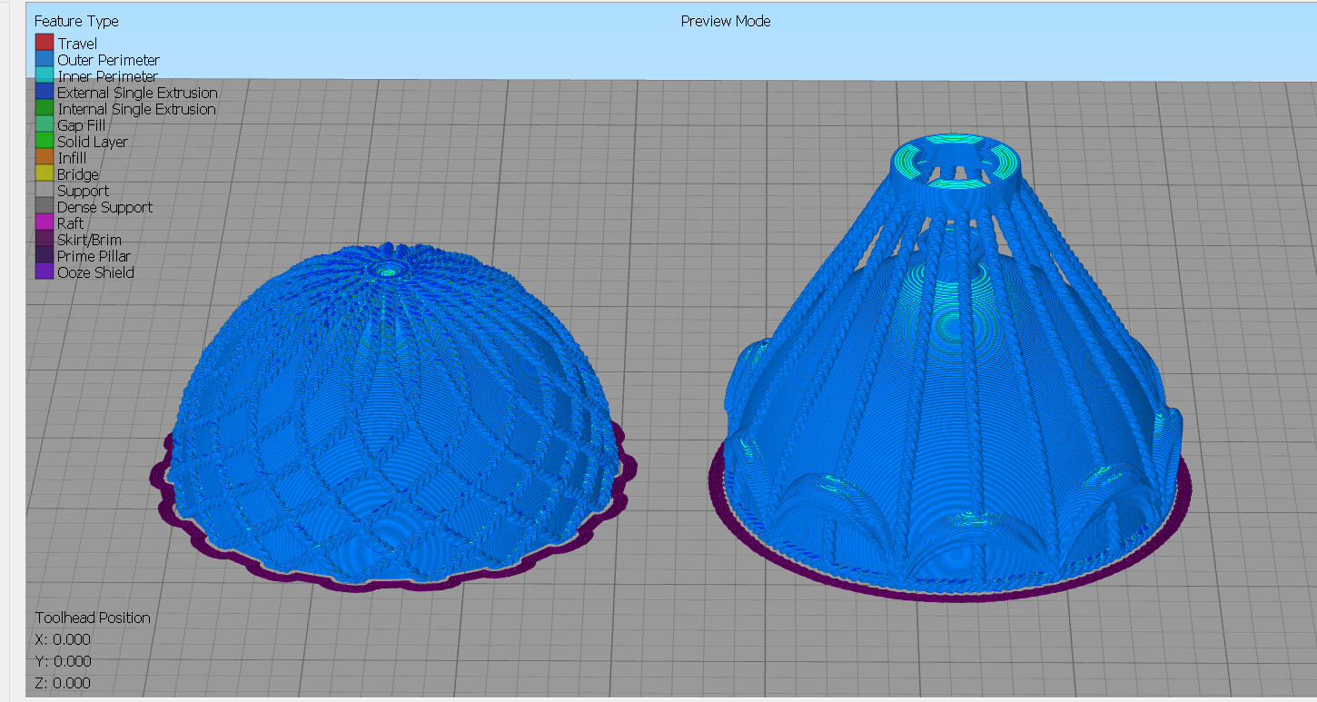

I am having issues suddenly with layers shifting on my print.
The first model i chalked up to a drag of the nozzle shifting the print plate, although the magnetic sheet still seemed aligned as i always place it. It was quite minor. I actually scrapped and restarted the print and it and i didnt realize it but it had done it again, but i just let it go because it was right on a transition and didn’t matter much. about 1 mm to the right.
The next model was at roughly the same height, maybe 1mm to the left. that of course was in 25% of the way thru a 9 hour print that i was running while sleeping. There are two separate partson this print, both shifted the same amount, both parts firmly adhered to the bed and the print sheet in its proper resting place. These were half domes of a hot air balloon, sturdy solid large objects.

Gcode file appears to be too large to upload.
Preview of exact gcode file used
I’ll add I had successfully printed this model in the past.

the problem i face is i dont know what module is acting up… because it is happening on the left right direction but at the same elevation
Left/right as in, the toolhead mount? Which would be the X axis, forward backwards would be Y.
Judging from your pics, it would be X
That is correct, X axis. Toolhead mount.
