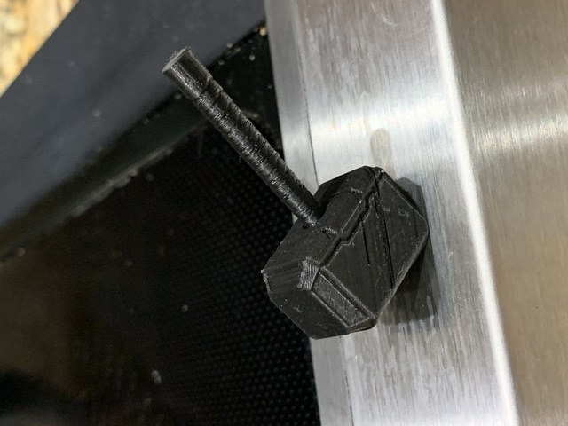

I did not find a way to do this in Luban, but it is easy with Cura and Octoprint. The piece below was paused using the preprocessing script in Cura. After placing my magnet, I just hit resume on octoprint.
image image
I can confirm the M00 command does work with SM. Well, sort of. The only problem is there isn’t an unpause option.
That is where Octoprint comes in.
