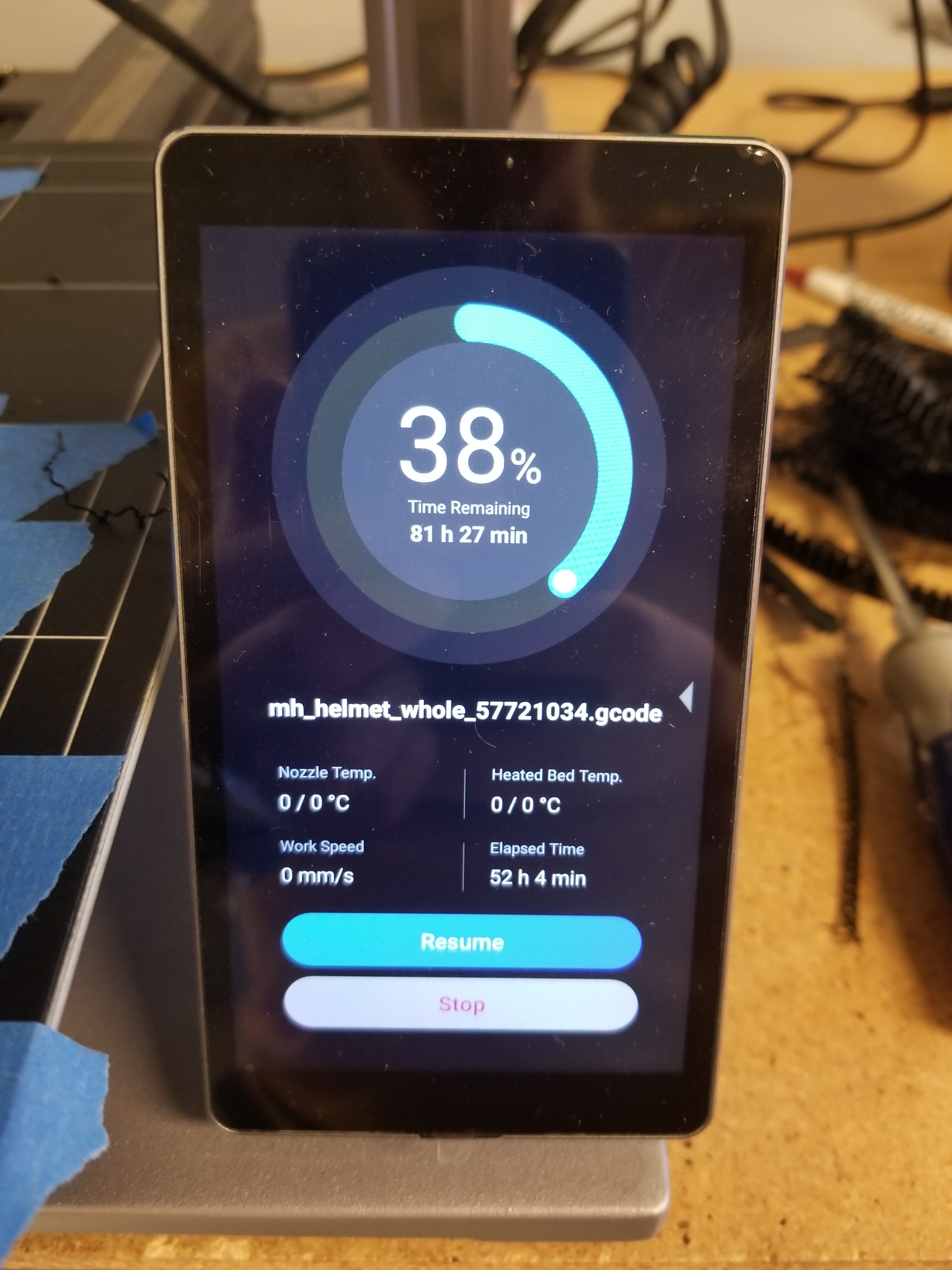

Hey @xchrisd , mind if you help me as well?
I had a print job, (Mandalorian helmet) which was a 140 hour print, stop 40% of the way due to running out of filament. After loading new filament I went to resume the print, but I got an error message “unable to resume job …” (see picture). I sent the gcode over wifi and controlled the print from the screen. I don’t know how to fix it except to try your method of making the gcode for the top 60%.
I could assist you and edit your gcode if you want, I am now at work.- so later.
Meassure your very correct height of the model and share your gcode over wetransfer.
Greets Chris
Edit: I wrote a Pm to you.
