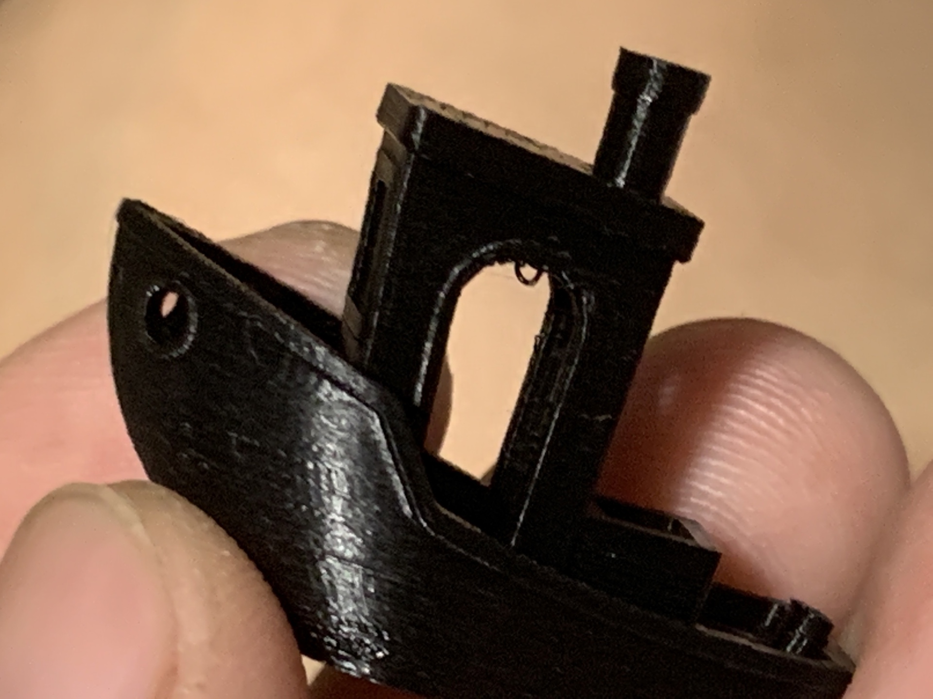

Printing with 0.2 nozzle
My latest print after solving the issue somehow.
There is one visible string each at the sides but definitely a great improvement overall comparing to the one printed previously on the right. Also finally get to see the small cylindrical shape at the back of the benchy. They were not printed on all the previous benchies.

Hey, where did you get your 0.2mm nozzle? I’d like to try printing miniatures myself, and would love the ability to get finer detail. Most places I look say “this nozzle/extruder is for X printer” and none seem to be for the snapmaker so I’ve been at a loss as to where to get one.
Any MK8 nozzle will work.

I got the 0.2mm nozzle from amazon. Any MK8 nozzle with the following is fine:
screw thread: M6
input diameter: 1.75mm
filament support: PLA (at least)/ PETG/ ABS
material: usually brass
