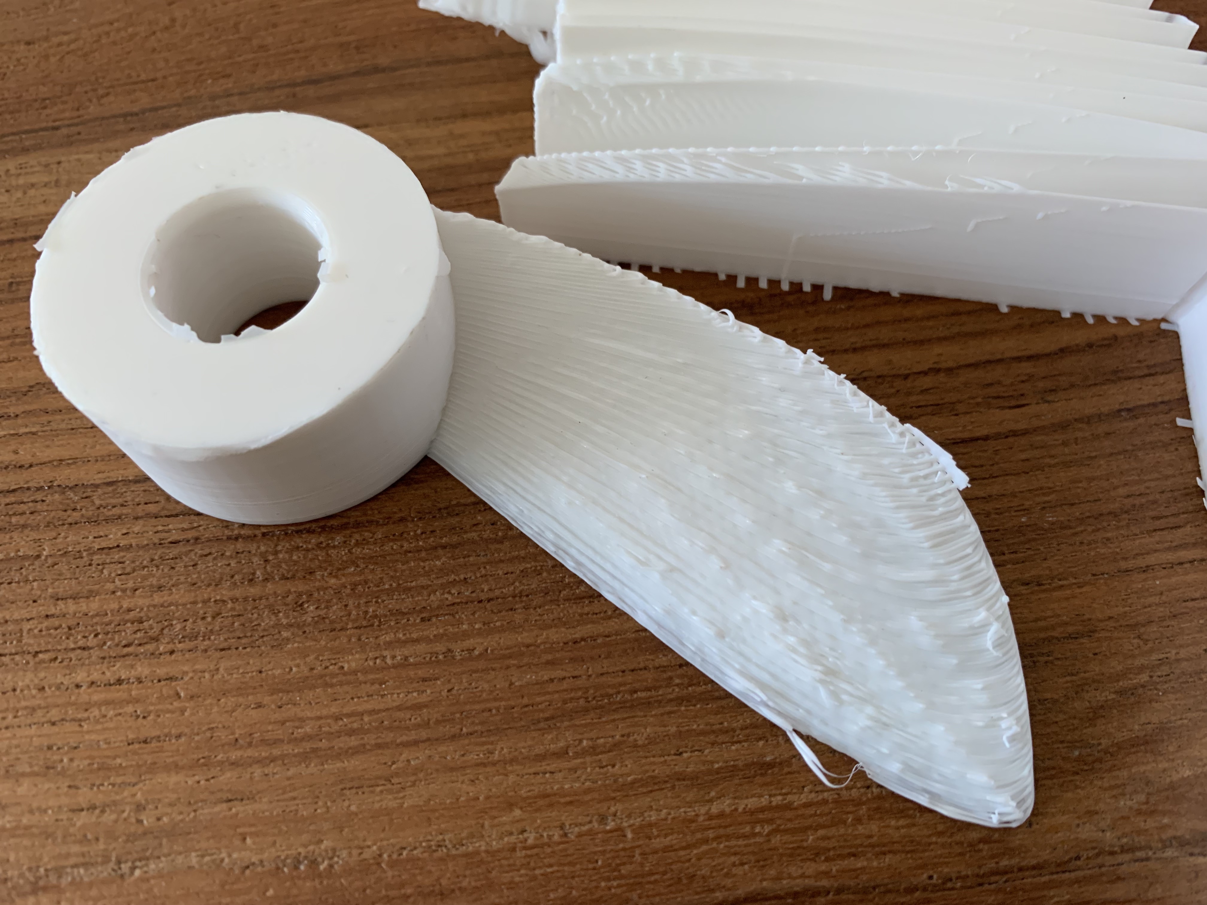

Dear all,
I am having a hard time to print this propeller (18cm in diameter) on my A350 with PLA - using Fastprint.
I activated “Generate Auto Support” but the result is not really promising.
Does anyone have an idea how I can place the propeller during printing or provider support structure parameters to get proper results?
Thanks in advance …
Printing with support tends to do things like that. Some people say that slicing in Cura and using the options there for tree supports produces better results, but I’m not sure how well that will work with something of that shape. Or you can try to manually design supports into the model, arranged so that you can removed them cleanly with cutters. Basically, you want the supports in contact with as few points on the model as you can manage while still allowing it to print without sagging or turning into spaghetti.
(The other options are waiting for the dual-extruder module to come out, which may not happen for quite some time, or putting in a good chunk of time with some old-fashioned sandpaper, although that still won’t fix the minor edge damage.)
Pva would be the best option, but need to wait for dual extruder.
Did you calibrate your machine well?
One to be said, if you want to do this really well, this could be a very looong project, this is not easy man.
Whats your overhang angles?- Is it possible to make the propeller steeper?
Did you try this with better quality too, than fast-print?
1- Start to print a overhang test to see what is possible.
2- Get some more part cooling capabilities.
3- Slice it with a other slicer like Cura, Prusa Slicer, S3d
Personally once I started using cura and tree supports I’ve had much better prints. Only very minimal support marring, and with support interface enabled I no longer get any infill being visible after separating supports. I also have an IDEX and printing with PVA is awesome. No support marring at all. Can’t wait until the dual extruder comes out.
For the propeller I don’t foresee being able to get a really good print of it without increasing the print time. I think tree supports with support interface is the way to go, but I could be wrong, I’ve never printed a propeller.
Is this propeller going to be a functional part that is required to be dimensionally perfect?
You probably need to make the top/bottom/wall layers thicker, print with supports, then sand it. It’s possible that Cura with it’s different support models (cylindrical maybe?) might do better than the Luban zig-zag. But I think that model is going to be a stretch for all supports.
The Propeller should be functional - the original one was printed too.
I guess I will give cura a try considering the feedback so far. I will report about the outcome.

Prusaslicer has pretty advanced options for support generation:
It can (like slic3r) generate automatic columns for certain overhang, but you can also manually enforce or forbid support at certain regions of your model. Without using multiple materials (1 dissolvable) you probably need to sand a bit at the end.
This is a 200x60 Prop model, with auto support from PrusaSlicer.
