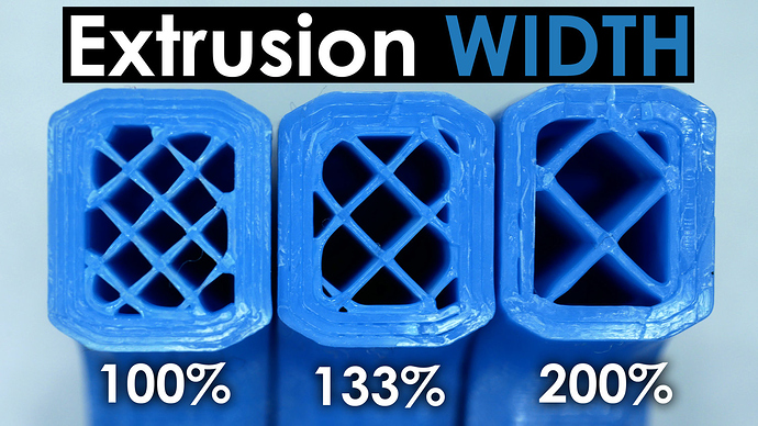

What happens if you set your extrusion width to manually 0.5?-Do you even have to decrease your extrusion multiplier?
Haven’t tried that. To my understanding it was that if the nozzle is 0.4mm, ideally the extrusion width should be 0.4 mm although?!
For best print results, it is often recommended that your extrusion width be at least 1.2 times your nozzle width.
More reading:
The 0.4 mm is just for callibration purposes. I was thinking that if the nozzle is 0.4 mm and you set the extrusion wide to 0.4 mm on printing a single layer wall the thickness of the wall should be 0.4 mm?! If not, you adjust the multiplicator to come to the 0.4mm?!
Maybe I missinterpreted the Manual???
Sure, in theory that’s right, if the extrusion cross section was a rectangle.
It might be helpful to remember that the proper extrusion cross sectional shape is obround which can be difficult to achieve if the extrusion width is not slightly wider than the nozzle.
With a smaller width the extrusion will take on a more circular shape, which can disproportionately affect the calculated extrusion volume the slicer puts out, resulting in wall thickness dimensional inaccuracy.
That’s why I suggested putting this on hold once you’re within 0.03 to 0.05mm of the target value, moving on with the rest of the calibrations, and at the end when you’re quite sure the machine is well tuned up doing one last pass through with a 0.48mm extrusion width. It should be tighter than 0.03mm tolerance at that point.
