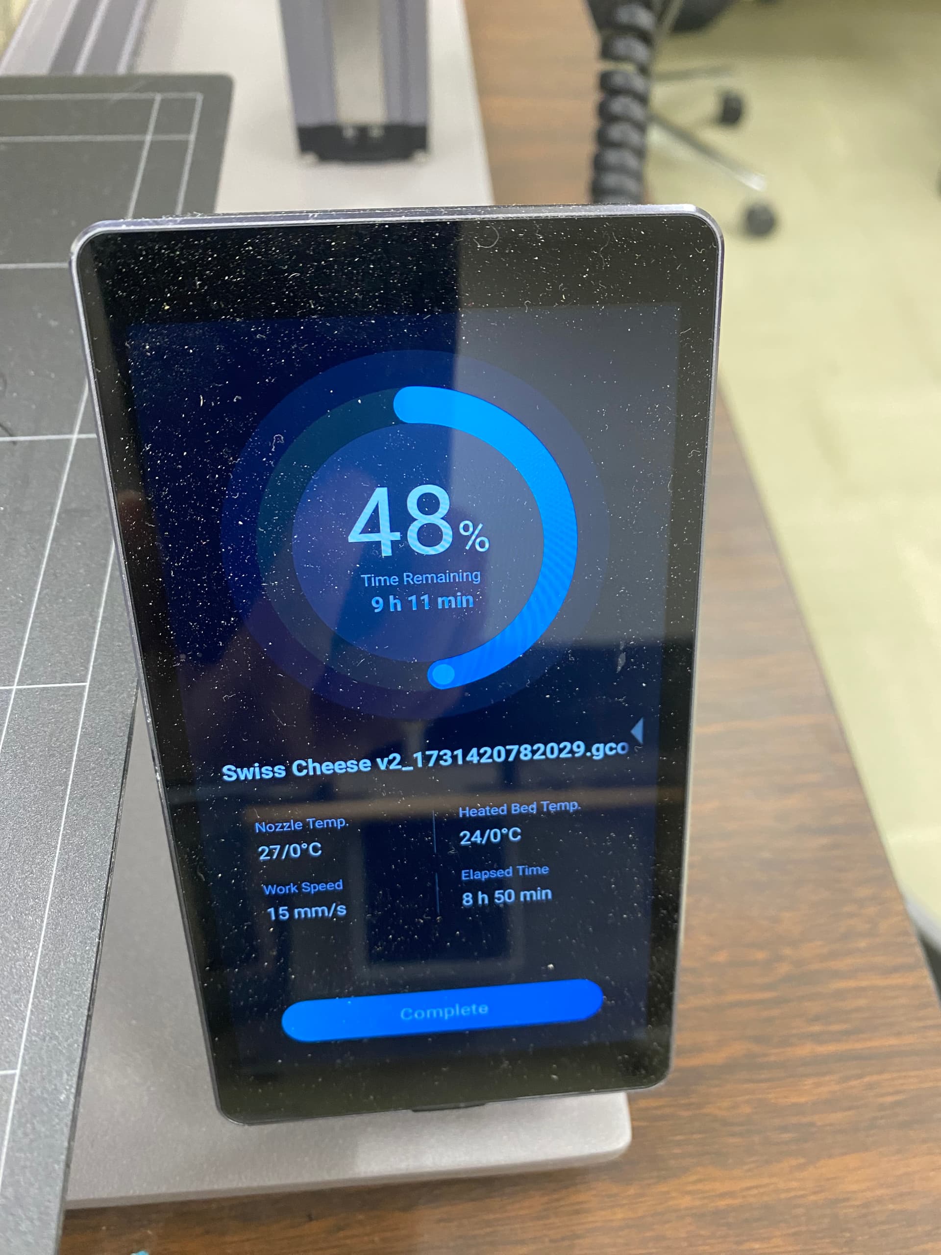

We’re using A350’s in my classroom, and I have a student who designed and tried to print a chunk of Swiss cheese - I didn’t ask why or what for. Regardless, he started the print job during class, and it should have completed sometime overnight. When I came in this morning, the job had terminated, but the print wasn’t complete.
I know this isn’t a Fusion forum, but I can post his Fusion file if that would help.
This is not the first time one of my students has experienced this problem, and I have no better idea now what caused it than I did the first time I saw it.
Any pointers would be appreciated.

Unbeknownst to me, my student restarted his job again last evening, and no surprise, it failed at the same spot. I glanced at the log file, but since I don’t know exactly what I’m looking for, I don’t know how to interpret the data. I see the following quite a bit:
ERROR,SC-FW,purifier info update timeout:0 - 2!
The last log file is quite large, but I believe these are the entries created during the student’s print job:

Please share the files, it would be helpful if the last operation was the error.
I can’t see a failed operation in the shared data so I guess the error occurs in the other file.
If you share a codeblock, please give it three back ticks before and after the code.
Here is the last log file in its entirety.
DC3DP1 Log.pdf (1.2 MB)
Please share the sc or fw log files too, not sure what you have shared.
How do you print the job, any connection?
Do you have the beta firmware running?
What speed do you print?
It seems your memory is faulty or the response is too slow:
1730745795124,2024.11.04 18:43:15.124,ERROR,SC-FW,wait gcode pack timeout and
req:0
1730745796139,2024.11.04 18:43:16.139,ERROR,SC-FW,wait gcode pack timeout and
req:0
What I forwarded was the tail end of what I thought was the last/latest FW log file. I went back again and regenerated all of the log files and placed them in ​this folder​, to which you should have read access. If you have any issues accessing the folder, please let me know and I’ll find another way to get the files to you.
Thanks!
Do you use a USB stick for print transfer?
I have problems to view your files on the phone but I have seen some USB drive errors, maybe try a different one?
