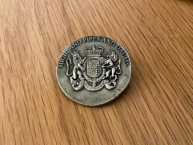

I would like to get also 0.1mm in Luban. I printed already with the A350 and a nozzle of 0.1mm a badge in PLA to get a higher resolution. I used a slicer where I can adjust the nozzle diameter. I would be great to have this also in Luban

Out of curiosity: how big and how long did it take?
I’ve printed many things with a 0.2 nozzle with great results, but even tiny things take forever… Considering you were forced to half the layer height and extrusion width, there really isn’t much stuff coming out. Bed leveling must be really really spot on too I suppose?
What filament? Any challenges going that small?
Size of the badge is diameter 51,8mm and thickness 2,5mm printing time 3,5h
filament PLA. I used silicone to get the casting form of the badge. Then I casted it in wax. Next step is to get it in new silver (alpaka). The bed issue is not easy. I checked the bed by printing with a skirt in several locations of the bed until I get a proper location. Layer height was 0.08mm

Here the result casted in sand not with wax
