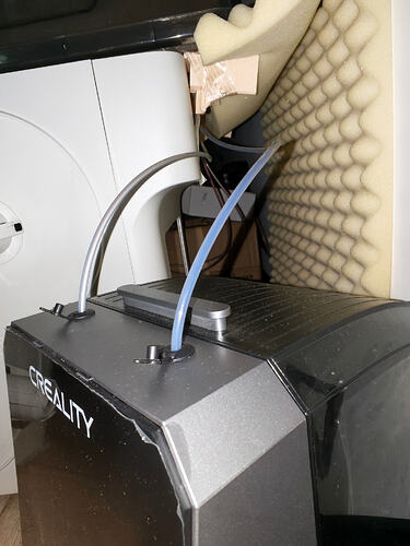

For TPU issues: The biggest problem is inconsistent feeding and insufficient cooling. When printing TPU, I set the fan to maximum because I print at a higher temperature than recommended (245–250°C) to ensure material adhesion strength and better flow at high temperatures. Also, printing TPU often triggers an empty spool detection alert, causing the print to stop. I disable empty spool detection as long as I’m sure there’s enough material. When printing TPU, the filament should connect directly to the extruder, minimizing the feed length. The official recommendation is to use materials with a hardness of 95A or higher. I’ve tried it, and if using glossy filament, you need 95A; matte filament can go as low as 85A.

For the tpu, yes I am using 95A. I haven’t had an issue with the run-out sensor. When it jams it air prints. When you say hook direct to the extruder, what is your setup for that?

Connected directly to the print head. It looks fine for now.
