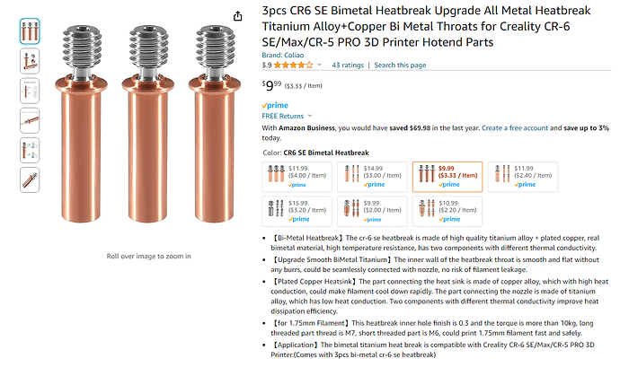

If you are going to be running a lot of PETG, you need to consider upgrading to an all-metal hotend. The PTFE liner inside the stock heat break starts to degrade around 230-240C, with higher temps accelerating it. Eventually it will degrade enough to cause the hotend to clog, whcih is often misdiagnosed as the extruder gear slipping. It can happen in as little as 1 spool. It’s entirely possible that you may already have this problem, or that the hotend clogged during the power surges you mentioned, preventing it from being able to push the plastic through at the increased speeds of the higher layers. You can read in-depth on the issue here:

@Mxbrnr, I ordered some all-metal heatbreaks and new brass nozzles.

Which heat-breaks did you order?

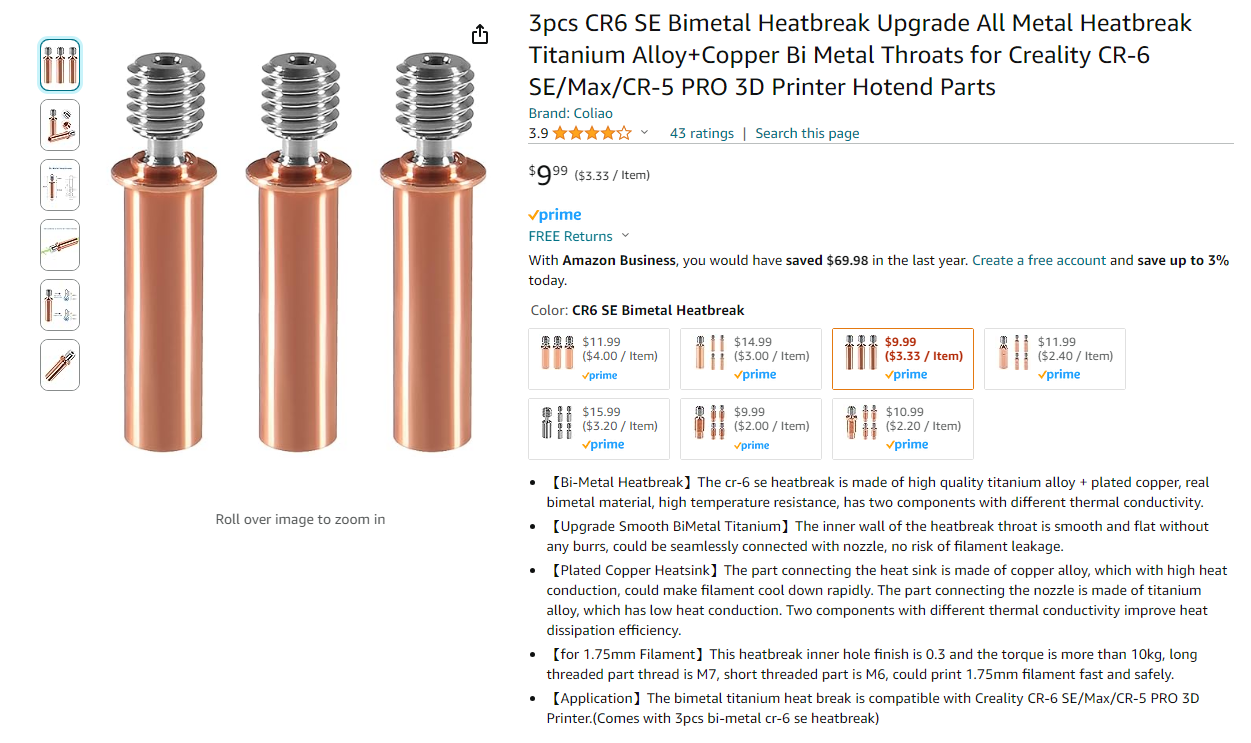

These are the ones I got. They have been working fantastic. One thing to note though is that these require a very short section (13mm) of 4mmODx2mmID PTFE tubing (I used Capricorn) at the very top; nothing like the stock version.
https://a.co/d/2ti9kQM
There are seven choices on that link, and none are available anymore.
Those are the exact ones that I ordered. I didn’t know I’d need to add PTFE to them. Do you have a link to some directions to do that? Is this the right PTFE tubing https://www.amazon.com/Capricorn-Bowden-Filament-Genuine-Premium/dp/B079P92HN9 ?
@Boxkite, They show in stock for me. The link should take you to the ones with ASIN # B0B5DMWX1P.
Maybe it’s a country thing? I am in the USA; all 6 choices are available in stock with Prime shipping, and the link takes you to the exact one I ordered already chosen from the list.
Yes, that tubing should be perfect. Installing it is about as easy as anything gets. Put it in the top of the heat break (it will be obvious), and use the flush cutters from the SM tool kit (or a nice, sharp, new razor blade) to cut it flush with the top. Done. Easier than a piece of cake.
Yes, it’s a country thing. But instead of saying it’s not available here, it says "We don’t know when or if this item will be back in stock. "

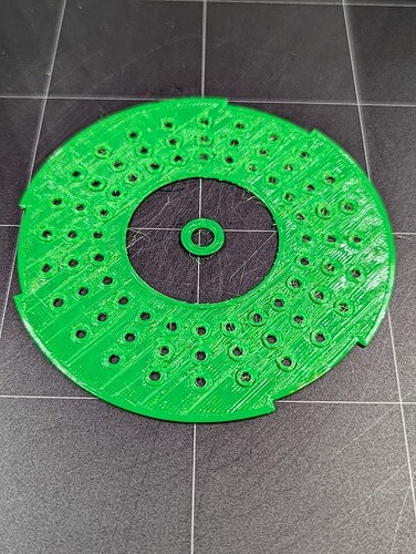

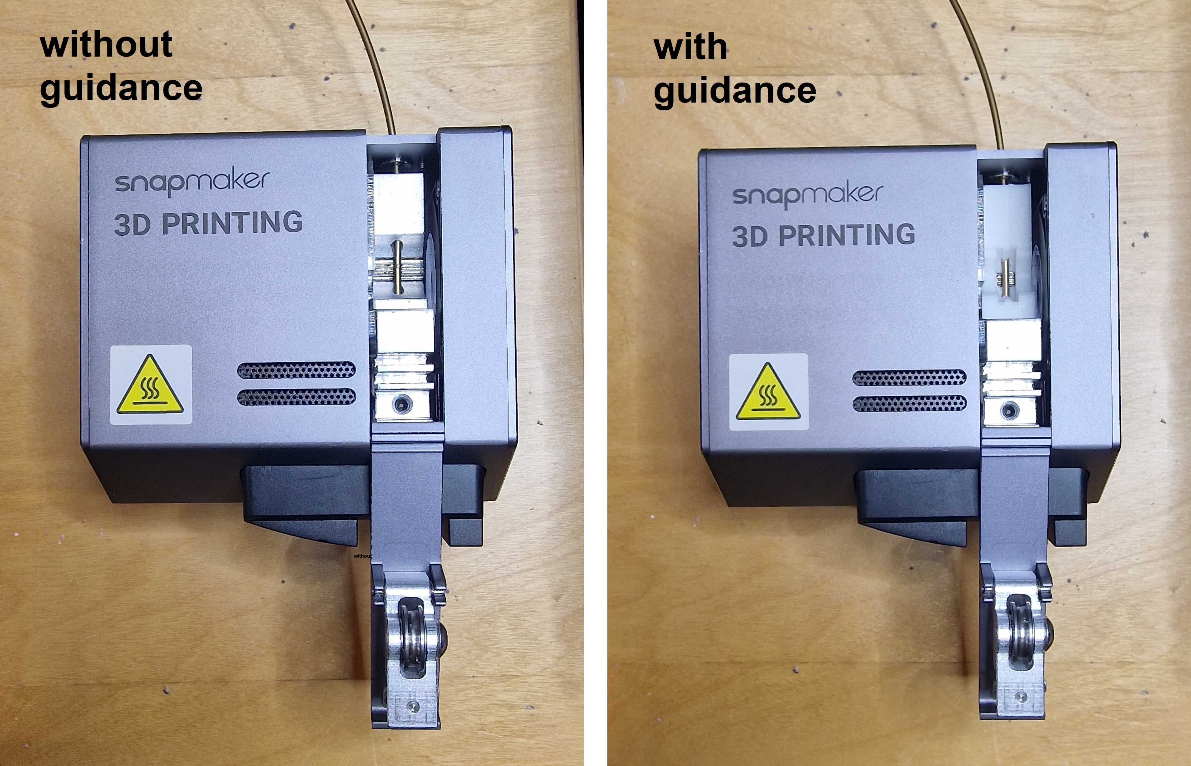

Bonjour pour moi qui avait le même problème j’ai imprimé et utilisé cette pièce
Et maintenant cela fonctionne très bien
Interesting. That guide was designed to help with flexible filaments like TPU, not stiff filaments like PETG. I won’t deny that it may help, but if this is required for you to print standard stiff filaemnts, then I would venture to say that something else is wrong with your printer or settings. The print head extruder gear area should work just fine in stock form for basic PLA, PETG, and ABS/ASA.
Bummer. In that case, look for a CR-6 SE, bi-metal heatbreak.
Here is a screenshot of those one’s I have been refering to on Amazon, and a link to some you could find on AliExpress to reference against.
https://www.aliexpress.us/item/3256804908009561.html?spm=a2g0o.productlist.main.9.6b9e4fa8VpMrFY&algo_pvid=e7d7e8e3-d4c2-4722-b712-faffde3f40d2&aem_p4p_detail=202403140912595263580768265080002270129&algo_exp_id=e7d7e8e3-d4c2-4722-b712-faffde3f40d2-4&pdp_npi=4%40dis!USD!2.71!0.99!!!2.71!0.99!%402101ef7017104327791856287edad1!12000031634783549!sea!US!0!AB&curPageLogUid=Q9BXlBx4c4cu&utparam-url=scene%3Asearch|query_from%3A&search_p4p_id=202403140912595263580768265080002270129_1
éffectivement je l’utilise pour le filament souple TPU, j’ai mal interprété le sujet sur le PETG, j’ai confondu les 2 matières
